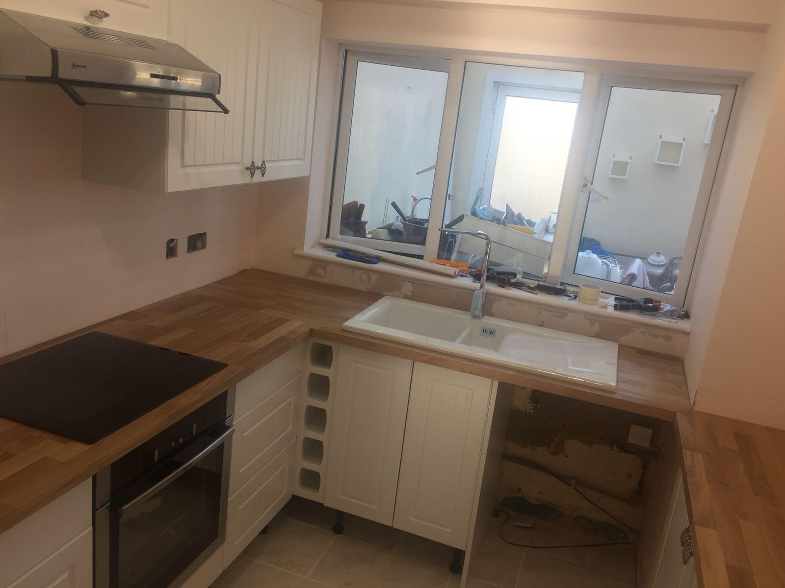

My mates kitchen. Following on from his knocking the hole in the ceramic hob. He's getting there!
His induction hob (like mine tbh) simply sits with a foam rubber gasket between the underside and the worktop.
Should it also then be siliconed?

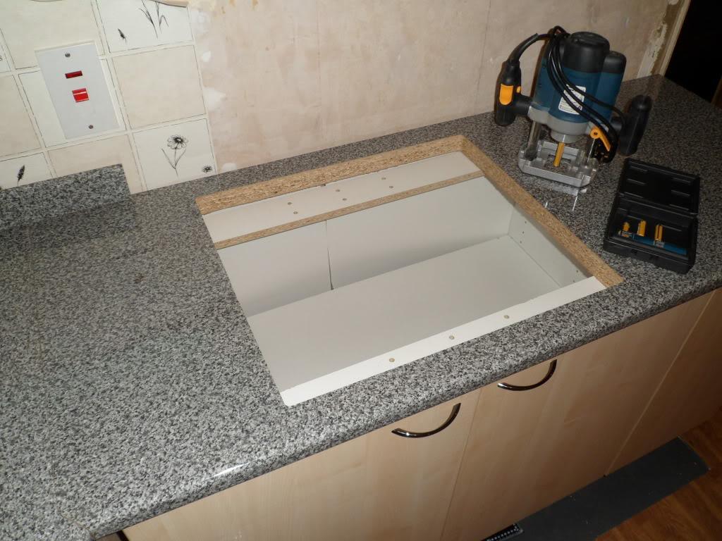

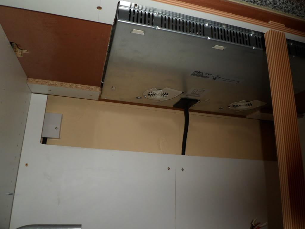

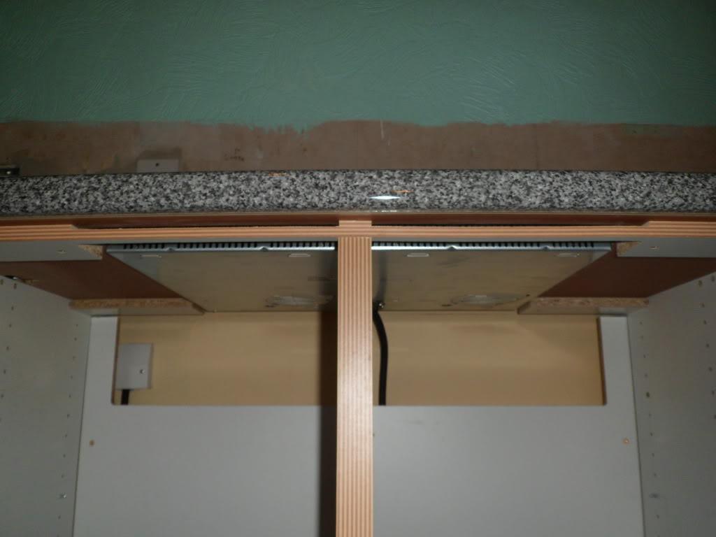

The manufacturers likely won't say to silicon the edge. AFAIC it's a belt and braces to stop debris getting in there. If it's anything like the strip on my induction hob then there's no air flow route through there anyway.
I went a bit ott with mine and routed the top strip to get some air flow through there figuring there's a nominal gap above the doors when they're on:

I don't like to silicone a hob down, your might never get it out in one piece.  but I DO seal the cut edges of the hole in thew worktop so if any water does get through it won't bugger it.

I neat PVA'd my hole...
