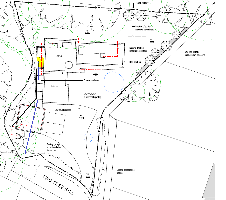

MBC on site Wed / Thursday (in theory).  Our sub-base is going in now (MBC doing the top 150mm MOT type 1).  Just wondering about ducts. for water and BT.  We also need to run the electric armoured cable in.  We know we should have posted this question earlier.  It has been bothering us for weeks.
Site plan looks roughly like this.  Its a weird shape (cut off a larger house behind).  Plant room is shaded in yellow.  Intended route of water (blue) and electricity (black, from kiosk) shown.  Both go under the garage slab so we are ducting that tomorrow.
Do we run these ducts at 700mm deep to the plant room and then up into the plant room?  i.e. is the bit I am filling with around 300mm subbase as I type going to have to be dug out to put these ducts in?  Or do they rise slowly and then go in the final layer (which MBC are laying)?
BT duct is another question but please help us sort out water and elec first.  Thanks.

I ran all the ducts, and the soil pipe, at around 600 to 700mm down below the slab sub-base top level and just bent them up through 90 deg where they came up through the sub-base.  I used 50mm flexible duct, except for the telephone, which used grey, rigid BT Duct 56, with a hockey stick bend where it came up through the slab.  I had no problem pulling 25mm MDPE or a three core 25mm² SWA cable through 50mm ducting.  In practice a 90 deg bend in flexible ducting is a pretty gentle curve.
Not sure it BT insist on Duct 56 being used for the run to the house, but they free-issued us with enough of the stuff, with hockey stick bends, to fit it anyway.

Thanks Jeremy.
That answers that one then.  We will dig them in 600-700mm down under the top level and bend them up to go through the upper layers of the sub base.
For BT, if I could get hold of Open Reach I would be delighted.  They keep putting me on hold until they go home!
I ordered some 56 duct online though so will just use that to get into the plant room.  Though don't have a 90 degree bend or hockey stick of that diameter so will see what I can get at short notice.  Will have to worry about where the cable will actually run another day.  Might be routing it round behind the garage after we have finished the build.

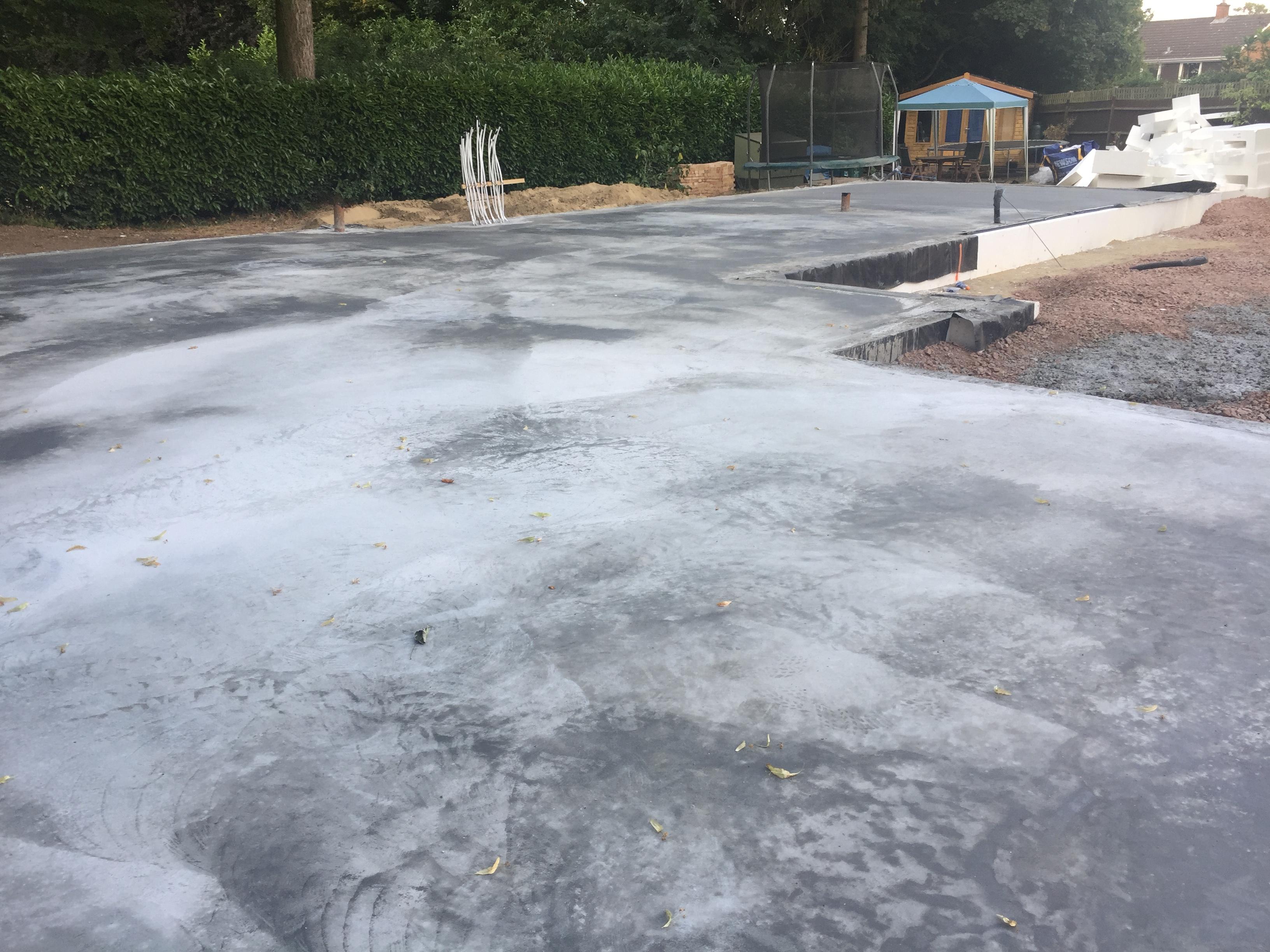

Just make the ducts way too long and leave them stick out above the pour.  They will stay vertical, held by the holes cut in the insulation.  Here's a photo, showing all the ducts tied together and poking up in the far corner.  When the concrete had cured I just cut the ducts off flush:

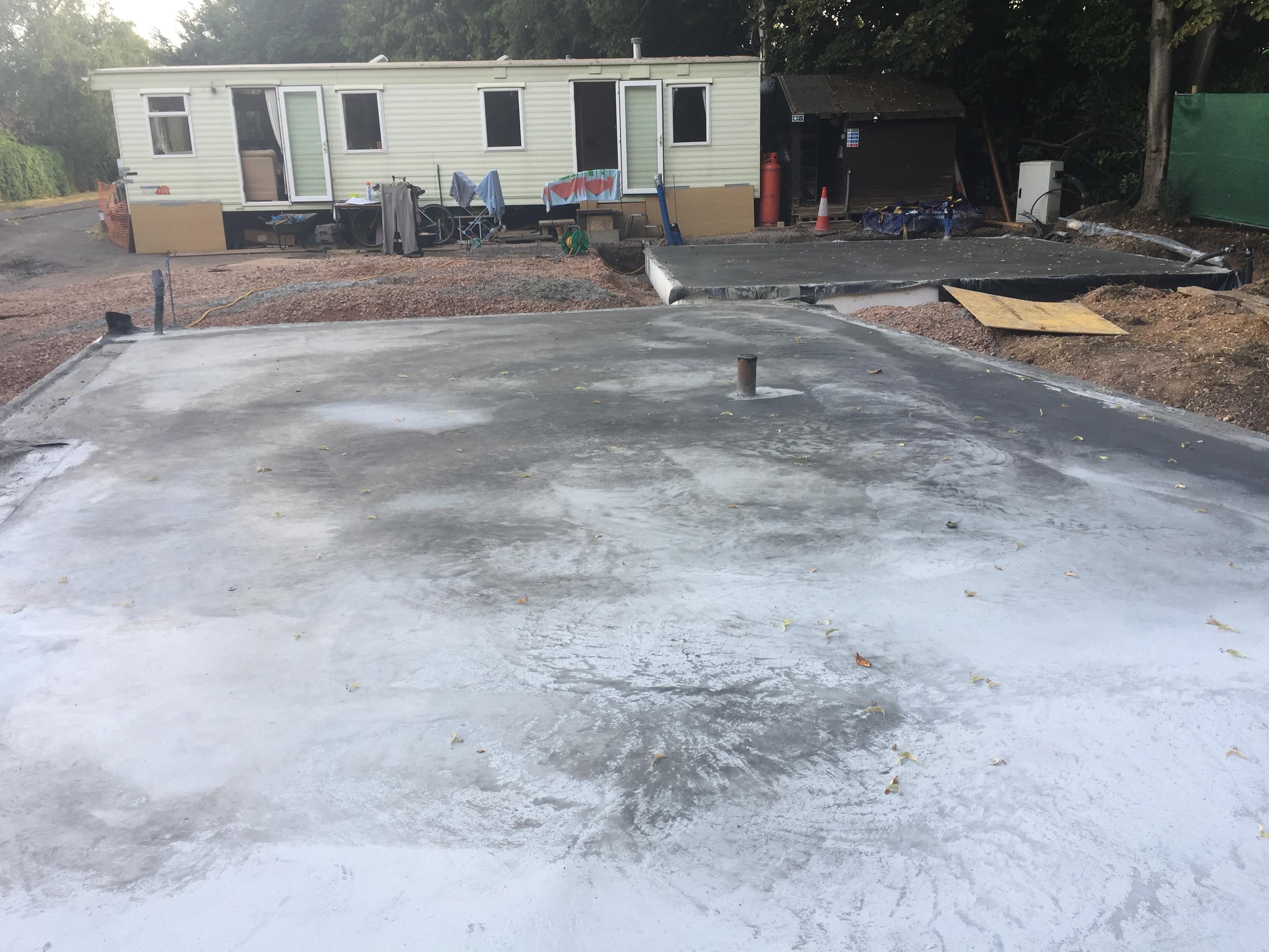

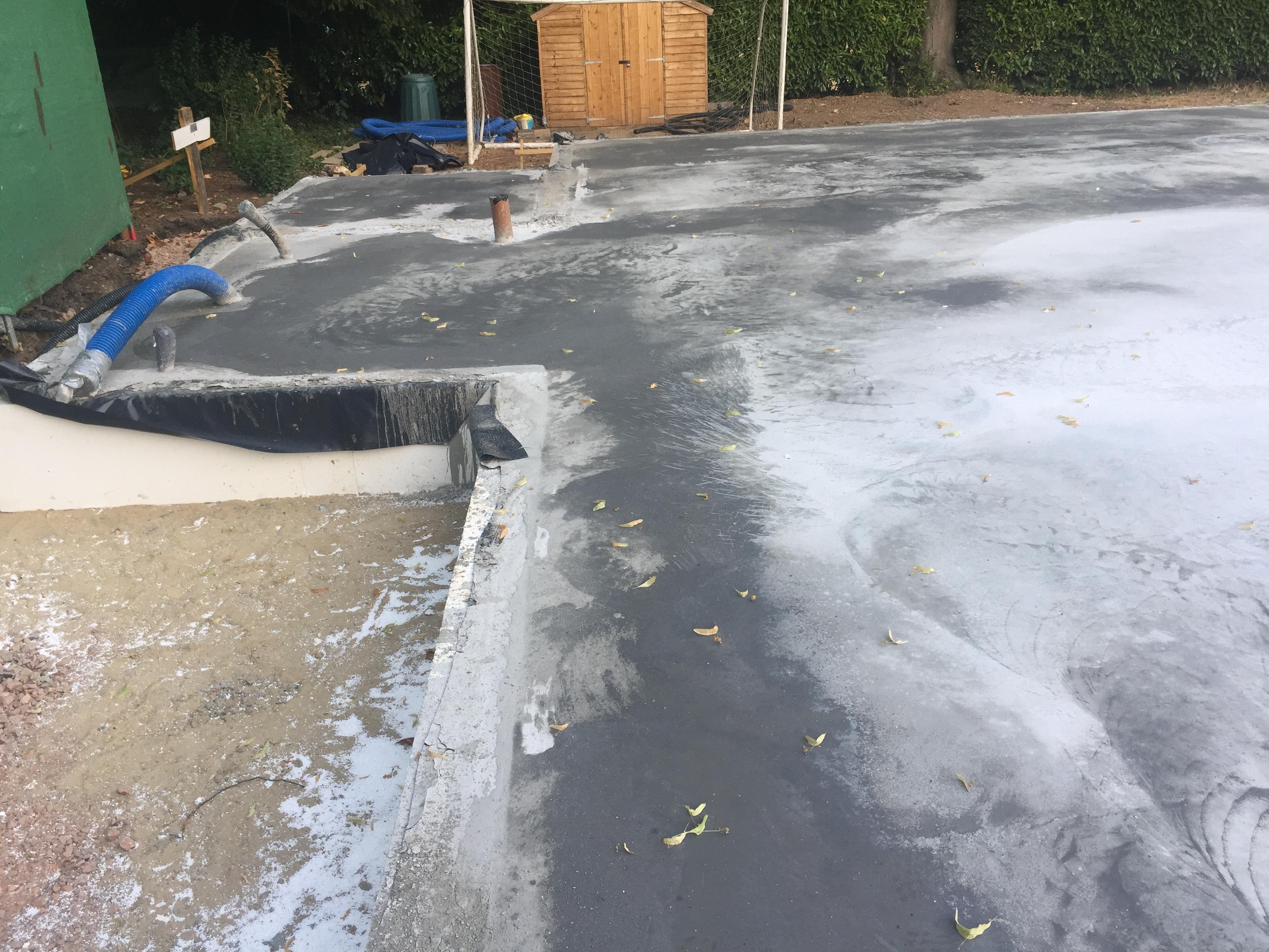

We have a slab! With ducts sticking out of it. All beautifully taped. Thanks everyone. I forgot to allow for electricity to the kitchen island but everything else seems to have gone well.  Ducts aren’t all in perfect positions but we should be able to work around it. Will see for sure when the frame goes up. MBC back in 23rd.
