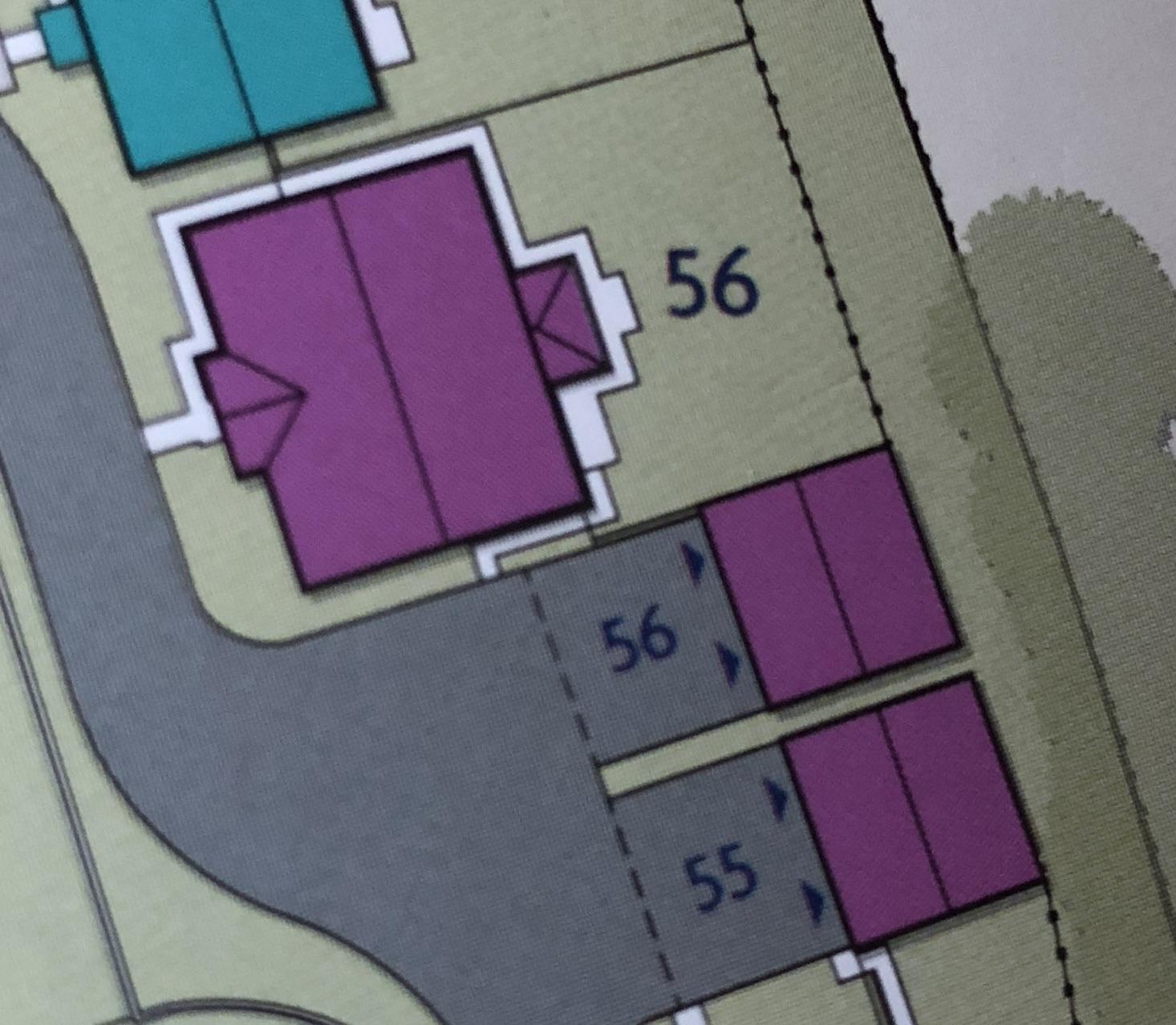

deecee Posted June 25, 2018 Share Posted June 25, 2018 Hi everyone, I'm after some advice on the following if you don't mind. Please forgive me if any of it comes across as a bit basic, I have no idea about things like this! I'm after getting a double garage extended, it is to be extended by approx 5/6ft to the left of the garage as you look at it. The extension will go into the garden of our home, it is a detached double garage. It has a pitched roof but the pitched roof angle would not need to be changed as the extension will run in the same direction as the pitched roof. The house is a new build, completed in December ’18. Would this type of thing need planning permission? I've read somewhere you can extend up to a certain amount without planning? Is this something that would need 'clearance' from neighbours?. I've attached a photo of the site plan of our home, will maybe give you an idea to the positioning of the garage. Thanks in advance! Link to comment Share on other sites More sharing options...

PeterW Posted June 25, 2018 Share Posted June 25, 2018 Welcome ..! If it’s a new house on a new development just check : - permitted development wasn’t removed by the council en masse when they approved the development - the developer doesn’t hold an approval covenant for the first x years Other than that it should be PD..! 1 Link to comment Share on other sites More sharing options...

PeterW Posted June 25, 2018 Share Posted June 25, 2018 Yep - quick plan and they should be fine. How long have they been built ..? Quick trick is to swap the rear roof tiles to the front so the look is the same, and then just put new ones on the rear. 1 Link to comment Share on other sites More sharing options...

jack Posted June 26, 2018 Share Posted June 26, 2018 Genuine question: if it's permitted development, don't you need to wait until the house is built and signed off before you can exercise this option? Otherwise you'll be trying to get something signed off that differs from the plans. If it's not gong to be finished until December, how far along are they with the garage? Seems crazy to have to another builder in to knock bits down and rebuild afterwards. Link to comment Share on other sites More sharing options...

Jeremy Harris Posted September 20, 2018 Share Posted September 20, 2018 Unfortunately you will need to wait until the house is completed until you can use PD rights, as they don't exist until the house has been built. Might be worth trying to do a deal with the developer to try and get some materials, like roof tiles, so that your extension will exactly match the garage. As for plans, then this is the sort of small job a builder can do, especially if you can take some photos of the garage being built, so that things like the foundations etc are clear. Real pity that the developer won't budge on doing this, as it would have been a lot easier if they had just been able to lay larger foundations with the initial works. Link to comment Share on other sites More sharing options...
