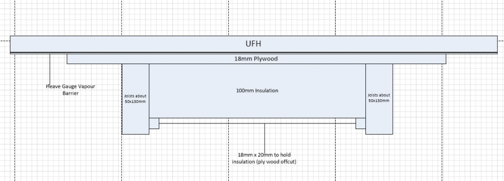

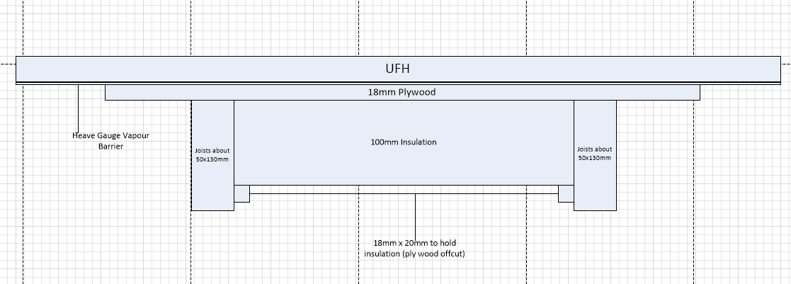

Daniel C Posted June 24, 2018 Share Posted June 24, 2018 As I mentioned in my first post, I will split the tasks which I need to work on. I hope I am posting at the most relevant location, this post would be about the "insulation" of a granite house crawl space. The crawl space is about 30 cm deep. I have been advised to install/lay a heave gauge vapour barrier and put sand on it as an extra protection against vapour (joist wet root). When I started to read up on it, I came across a few different solutions: heave gauge vapour barrier (just on the ground) and put sand on it From my readings: it could create puddles, as water could leak from the side walls heave gauge vapour barrier on the joists From my readings: bad idea could just collect water and pretty much continuously soak the joists in it heave gauge vapour barrier on the walls as well From my readings: it might require a pump and/or guttering system heave gauge vapour barrier on the walls, block the air vents, install dehumidifier and sensors I do not know how would that work with granite house and cavity walls, it might will depend on the wall insulation which I am still looking into it, but that's an other topic What would be the best way top lay down the heavy gauge vapour barrier, do I even need one? Please let me know if you need any other information and if I can answer, I will upgrade the original post. Link to comment Share on other sites More sharing options...
Tennentslager Posted June 24, 2018 Share Posted June 24, 2018 What are you trying to achieve? What state are the floor joists? Is there a vented underfloor? You mentioned UFH ...is it to insulate the floor? Link to comment Share on other sites More sharing options...

Ferdinand Posted June 25, 2018 Share Posted June 25, 2018 (edited) I did a project last year on a small bungalow with a suspended underfloor. I Put 100mm rockwool between the joists and a floating floor for more insulation for a u-value around 0.2. We took all the services out of the void, and left a 200mm service ‘duct’ within the floating floor running around the edge of or across some rooms to where sockets and rads would be. Next time I would use one of the ufh systems such as you mention. There were significant benefits in savings on rewire and replumb, and in simplifying the floor construction, no cables in the insulation etc, and we got about £200 from weighing in the old copper pipes etc. Your various options do not seem to consider insulation sufficiently, and that a vapour barrier needs to be on the warm side to avoid condensation. The layer of sand seems to be an attempt at buffering (?), and I question how well that would work in a ventilated void which is open to the outside.They also seem to me to be somewhat technically, rather than fabric, orientated. AIUI two ways ventilated voids have traditionally been ‘greenly’ renovated in the last decade or two are 1 - Leave it ventilated, insulate under floor, vapour barrier over floor, then heating in room. And ufh requires a lot of insulation as it is low temp compared to rads and actually touching the floor. Ventilation under floor ie air bricks keeps joists dry. 2 - Seal the void to exclude moisture completely, fill it entirely with insulation such as polybeads or LECA in a water impermeable lining (ie poly sheet). Joists are kept dry because they are in a warm environment so water cannot condense on them. There are People who have got that approved by Building Control. I went with 1 as my BCO raised his eyebrows about 2. Would have got it through at the cost of some time delay and a professional report. Your other option is to rip it out and insert an insulated slab, which in some ways is much simpler. 300mm ish is enough depth I think.. if you are gutting I would consider that. Do not underinsulate your floor if using ufh. One more thing to watch is the height of your doors, and that there are sufficient trimming margins. This caught me out and I have a shed full of 50mm Celotex sheets that I had to replace with 25mm ones, to remind me of the non-existence of doors which can be trimmed by much more than 60mm. It may be useful to have a conversation about the details over on the Green Buildig Forum and/or in our Boffin’s Corner. Mine is in Notts, and your local environment may vary. Ferdinand Edited June 25, 2018 by Ferdinand Link to comment Share on other sites More sharing options...

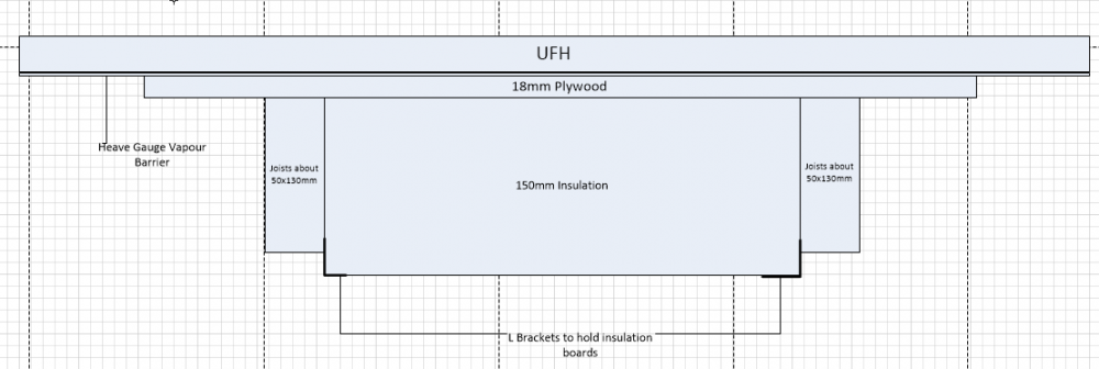

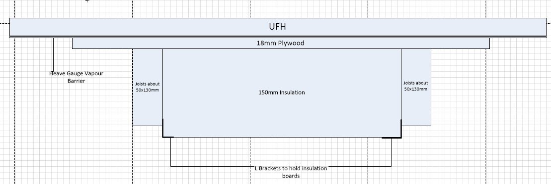

Daniel C Posted June 25, 2018 Author Share Posted June 25, 2018 Not sure how much would it help but there could eb a possibility to install L brackets and use 150mm insulation boards like that: What do you think? Not sure how beneficial it would be. Link to comment Share on other sites More sharing options...
Jeremy Harris Posted June 25, 2018 Share Posted June 25, 2018 100mm is really a bit marginal for UFH, where the floor will be a lot warmer than it would otherwise be and so lose more heat downwards. If you can get spaced battens under the floor joists then that might be an option to support the insulation. Alternatively, you could try just bonding the insulation at the sides with low expansion foam. Low expansion foam bonds very well to both PIR and timber, and may well be plenty strong enough to both hold the insulation in place and seal it at the sides. It sets very quickly (five minutes or so) so with luck you should be able to work from one side, using temporary supports under the insulation to hold it up until the foam cures, with only the last bay being the slightly trick one where you only have access from above. Making that bit a really tight fit, so you can squirt some foam along the joist and then tap it down into place should work OK. I'd definitely go with 150mm PIR if you possibly can, you certainly won't regret adding more insulation. We have 300mm of EPS under our floor, roughly the same as about 200mm of PIR. Link to comment Share on other sites More sharing options...
Daniel C Posted June 25, 2018 Author Share Posted June 25, 2018 OK, I will go for 150mm minimum, maybe even 200mm. Few questions: Do I need to do anything with my joists, should I put insulation on them from above? I assume I leave the vents open and clear the way they meant to be, should not I? Do you agree on replacing floor board with ply wood? Is my drawing above seems alright? Link to comment Share on other sites More sharing options...
Jeremy Harris Posted June 25, 2018 Share Posted June 25, 2018 Ideally insulate over them, but frankly the hassle of doing that, as it'll raise the floor etc, probably isn't worth it for the small improvement by reducing thermal bridging. Tight fitting insulation to the sides of the joists, foamed in place, with significantly reduce the thermal bridging through the joists anyway, by reducing 3D heat flow to almost wholly 2D. Leave the underfloor vents open so that the cold space under the insulation remains well-ventilated, to prevent damp build up. Plywood is a good choice for a sub-floor, but you could equally well consider using T&G OSB3, which might be cheaper and would do as good a job if glued and screwed down well (our first floor is 18mm T&G OSB3 on 400mm centre joists and is fine). The drawing looks fine, I just think you can do away with the L brackets and just fix the PIR in place with low expansion foam. Others may care to comment on this, but it's what I'd do. Link to comment Share on other sites More sharing options...
Daniel C Posted June 25, 2018 Author Share Posted June 25, 2018 Perfect, thank you. Yes I was going to go with your suggesting regarding the expanding foam as glue. I think I should be able to get 18mm ply for relatively, cheap will update on the price and quality when I manage to get them. Link to comment Share on other sites More sharing options...
PeterW Posted June 25, 2018 Share Posted June 25, 2018 If your joists are 150mm then I would drop a few roofing battens down the gap and turn them across the joists to catch the insulation onto. Then as @JSHarris says, foam down the sides to hold it tight and stop and convection currents. Are you adding UFH to the mix too ..? Link to comment Share on other sites More sharing options...
Daniel C Posted June 25, 2018 Author Share Posted June 25, 2018 The joist are just around 130mm ( I will remeasure them next week with a caliper as I am not sure), although I still could put 20mm wood on them and then put some beams across to help pushing in the insulation boards, good idea @PeterW 2 hours ago, PeterW said: Are you adding UFH to the mix too ..? I will install UFH, it is on my drawing above. I am planning to use Scluther bekotec (water), any feedback on it? Link to comment Share on other sites More sharing options...
