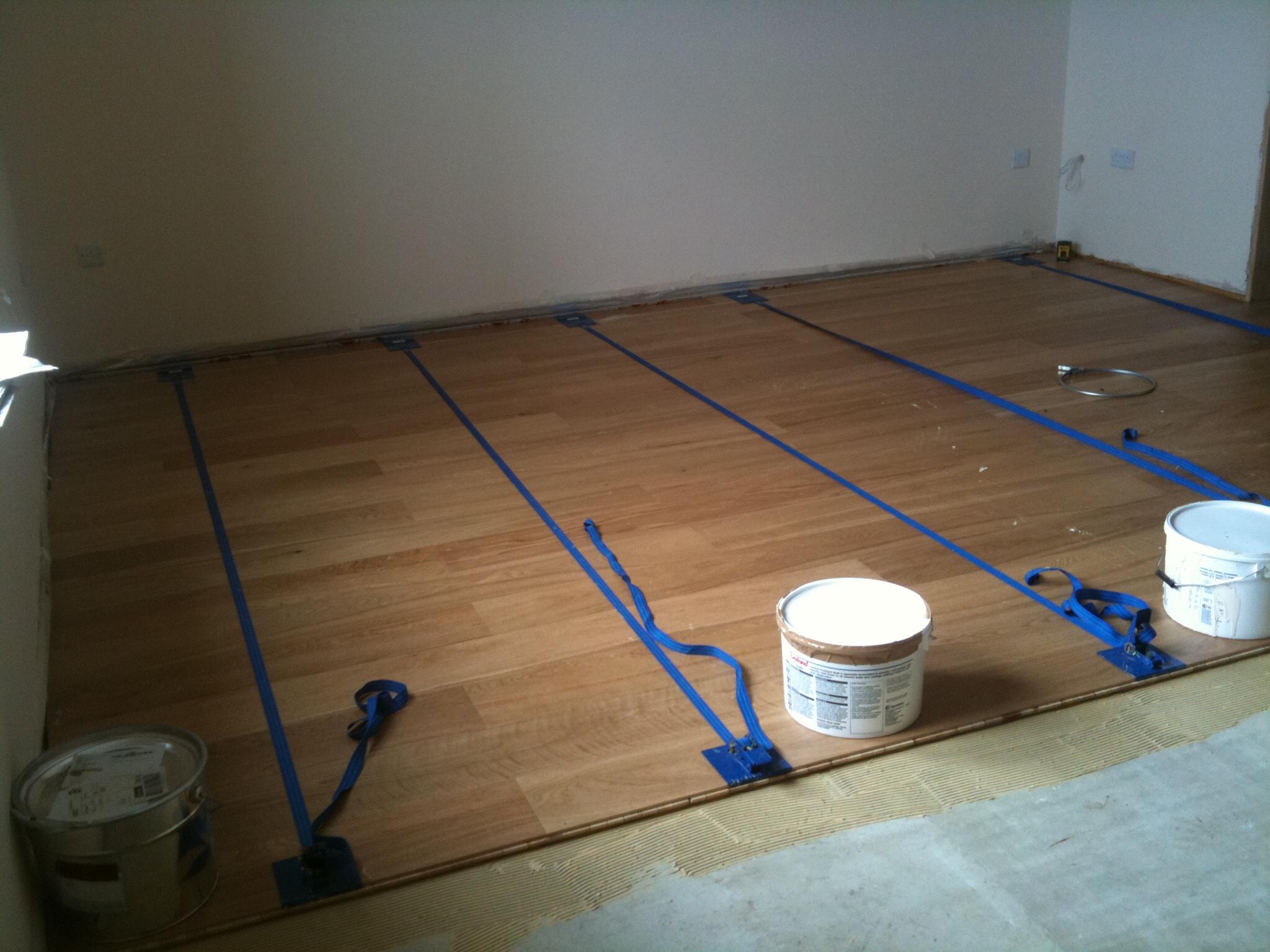

No idea if this is the right method as the hubby laid the floor with no previous experience but he used these straps to pull the boards tight whilst the adhesive was curing. Seemed to work ok anyway given it is still stuck down fast.
Oh and if there is any trace of glue on any of the top surface remove it immediately. There were some bits the hubby didn’t notice (I did as soon as I was back from work ;)) and they were a b1tch to remove once dry!

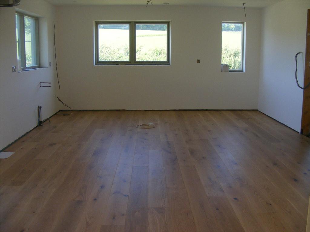

Next bit of advice needed.  Expansion gaps.
So far I have floored the big room
This room is about 7 metres by 5 metres and the boards run front to back, i.e the 7M dimension.
I want to continue this same floor throughout most of the ground floor, i.e continue out of the door opening (just visible on the right of the picture above, a double door opening) across the hall, and into and through the snug lounge.  The look we want is once continuous floor with no gaps or visible joints.
BUT if I do that, the total width covered by the floor will be 11 metres.  I am sure I have read you should not exceed 10 metres without an expansion gap
So do I need an expansion gap?
If so how to make a level unobtrusive expansion gap?  If I do so I will put the gap in one of the doorways so it is covered when the doors are shut.
