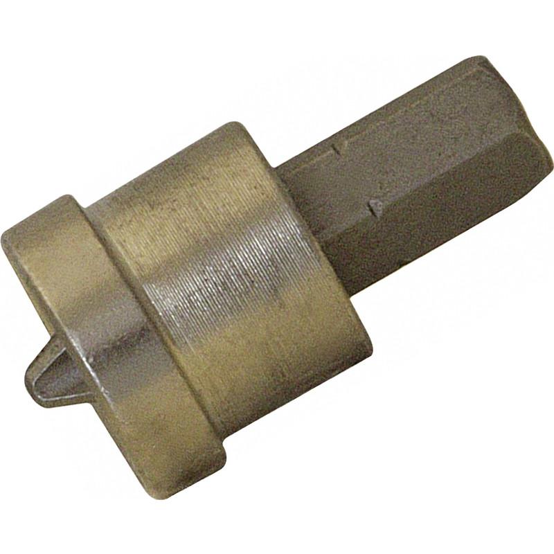

Onoff Posted July 22, 2018 Share Posted July 22, 2018 Forgot to mention this. Stops you driving your pb screws in too deep. https://www.toolstation.com/shop/p66573? Link to comment Share on other sites More sharing options...

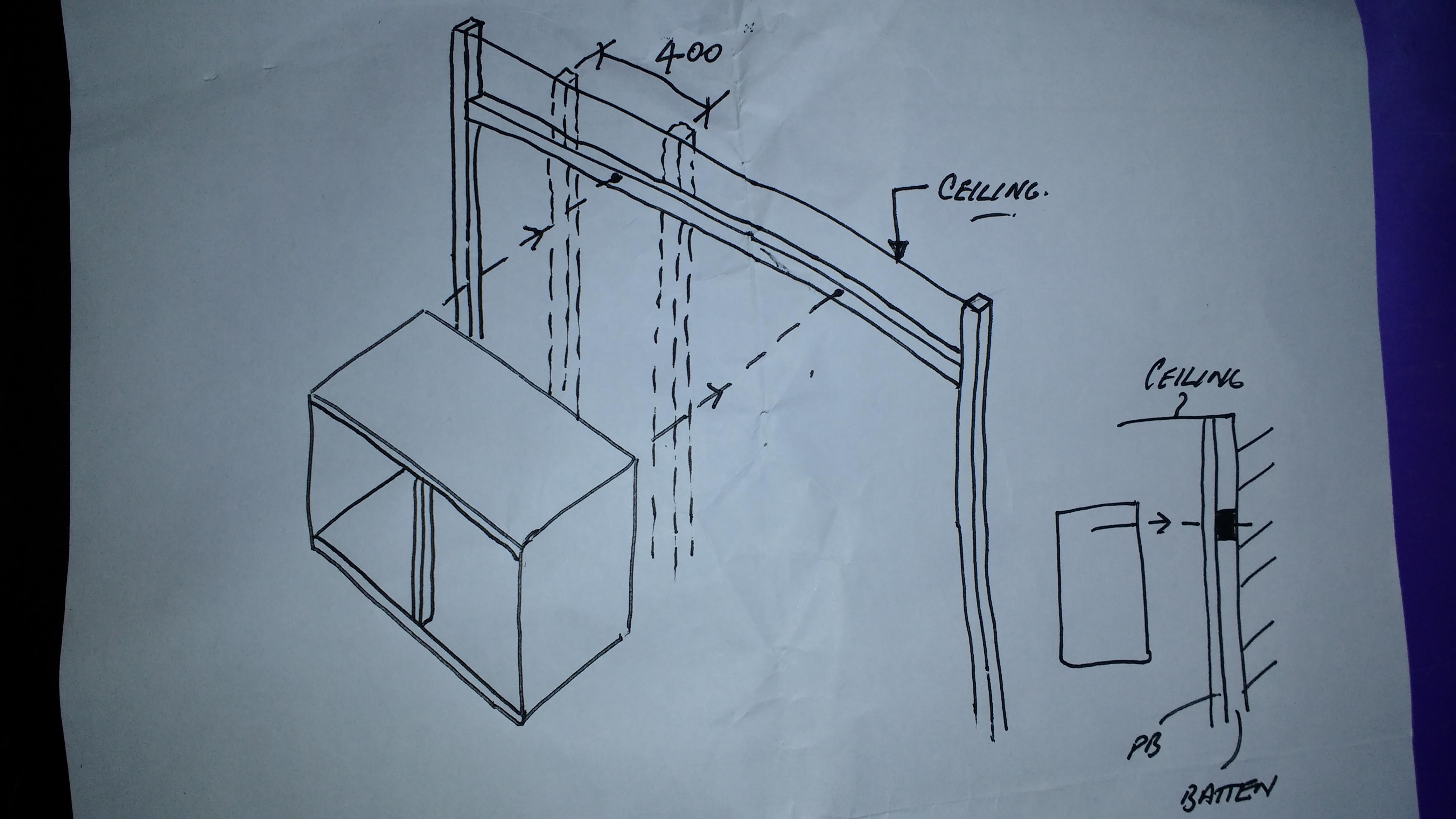

Onoff Posted July 24, 2018 Share Posted July 24, 2018 7 hours ago, zoothorn said: Onoff- do you have a batten rail across the top of the vertical battens? I can't see as your blue dpc thing is over the top.. I guess if so its easier to put a batten across, above the tops of the verticals, rather than a series of noggins-? Yes, in effect I have a top and bottom batten. As I said earlier I made up stud walls consisting of top and bottom battens screwed to the verticals then stood them up. The top batten is screwed to the new ceiling joists - I had the advantage they were new, so I knew where they were plus I had no wires to miss. This left my studded walls floating. I screwed screeding rails to the stud walls and then poured the new concrete wall bringing it up to the underside of the bottom batten. Link to comment Share on other sites More sharing options...
Onoff Posted July 24, 2018 Share Posted July 24, 2018 (edited) My room was not square btw, sort of a parallelogram. I wanted to square it off and leave "depth" for the illuminated pockets. You can see the top batten on this wall: In your case you have a ceiling and floor already in place. You want to put the battens on the wall but have the faces flush. If your wall is wildly in and out your plasterboard will follow suit. If that doesn't bother you just whack the battens on. If you want it dead flush maybe put the 1st and last batten on with just 3 screws and string between them? Mark your other verticals on the wall in between and measure to the string. You might have to pick a minimum pack depth (I did 5mm) and put plastic trouser shims or slivers of timber at some fixing points - I used both. Edited July 24, 2018 by Onoff Link to comment Share on other sites More sharing options...

zoothorn Posted July 25, 2018 Author Share Posted July 25, 2018 Thanks chaps (still can't get notifications of replies, hence the delay in my posts..) So do I need the horizontal battens, sorry I'm not quite following the plan with these right now enough to start. I'm going to have a look see if I can shift the units out/ away to do the C'tex job.. then put back onto the PB. Quite a tricky job afaict, so not sure which way to go: ;leave in or shift out/ away. Can you remind me why 'string' is used/ where? Appreciated. zoot Link to comment Share on other sites More sharing options...
PeterW Posted July 25, 2018 Share Posted July 25, 2018 Take the units out and refit. Quicker and simpler and better finish. 1 Link to comment Share on other sites More sharing options...
joe90 Posted July 25, 2018 Share Posted July 25, 2018 Take the units out, much easier in the long run. Put horizontal battens where you know you need fixings (worktop, cabinets floor and wall) then put other battens in between. Link to comment Share on other sites More sharing options...
Onoff Posted July 26, 2018 Share Posted July 26, 2018 I have seen people affix sheets of plywood direct to the battens where cupboards, radiators, TVs are going instead of or over the top of pb. Tbh though you can end up with an unsightly board or edge of board on show. 12mm ply would sit near flush with 12.5mm. 18mm ply however would be better for a fixing into but stick out beyond the pb. Aside from the cost it's better to accurately plan where your cupboards are going and make the centre of any horizontal battens a known distance down from the ceiling. Then when it's all pb'd over you simply draw a feint line on the wall and you can put your chunky cupboard screws into that knowing you'll hit batten. Link to comment Share on other sites More sharing options...
joe90 Posted July 26, 2018 Share Posted July 26, 2018 If you want ply all over then it’s best to sheet out with ply then PB over the top, if you join ply with PB the join will always show (IMO), also ply (unless very thick) will not give you as firm an anchor as batten on wall, as with this you can fix through the sheets, barret then wall for heavy stuff. (have you ever tried to lift a wall cupboard when it’s full of crockery?) Link to comment Share on other sites More sharing options...
Onoff Posted July 26, 2018 Share Posted July 26, 2018 16 minutes ago, joe90 said: If you want ply all over then it’s best to sheet out with ply then PB over the top, if you join ply with PB the join will always show (IMO) Unless the ply is the exact same size as the cupboard! Mostly I've seen a bit of thick ply attached to the wall through to whatever battens are there and the cupboards attached to the ply. P.P.P.P.P.P etc! I don't think this op wants to ply all over at all if anywhere, cost etc. It was me just saying what I've seen. Tbh the need for "ply" can be avoided by careful battening. Try and avoid your cupboard screws hitting a concrete screw @zoothorn! ! Something like this. Probably easier for you to do the verticals first and horizontal battens between as above bearing in mind where the cupboard fixings are going. And indeed your fixings could go through the pb, batten and into the wall rather than just into the batten. Link to comment Share on other sites More sharing options...

zoothorn Posted July 26, 2018 Author Share Posted July 26, 2018 Ok just seen last 4 replies before ^ this one of mine/ thanks alot for those esp the diagram onoff. So no top horizontal batten rail needed- good one less job. Right then, plan is units out- & Ive taken the plunge & got one side out (laptop area/ easier side of the 2 L-shaped joined together). I plan to do this wall 1st, leave sink unit in place until I've some practise & more confident to do this tricky 2nd side. What I'm left with to cause trouble on this bare wall.. is a window sill, a power point, & a single on-off-w'light switch socket above it. What to do with these? Link to comment Share on other sites More sharing options...
