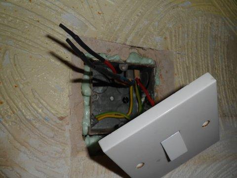

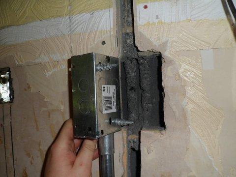

Onoff Posted December 16, 2018 Posted December 16, 2018 (edited) 10 minutes ago, zoothorn said: Do you mean grab adhesive? pink grip stuff for eg. Got two tubes so could try that. Ive got it fixed just about acceptably, with its 2 screws in backbox top corners.. so its more Im concerned with plugging the cavity re. cold than something better for it to fix to. So defo not foam? Yes, grab adhesive, many names/makes. Even saw one in the Pound shop yesterday. No Nails Pink Grip Grip Fill I Can't Believe It's Not Nails No More Nails Sticks Like Sh!t Sikaflex EBT CT1 Etc, etc Your cables I'm guessing are two 6mm2 twin and earth. One comes from the consumer unit (40/45A breaker) and the other goes to the cooker. Do they come into the rear of the back box or top and bottom? I've foamed a loose back box in temporarily before (now taken out): This same wall had hollow blocks in. So hollow that the permanent fix to fit the 47mm back box was to first fit curly wurlies meant for pb then push the whole lot into mortar pumped in with a mortar gun. Edited December 16, 2018 by Onoff
zoothorn Posted December 16, 2018 Author Posted December 16, 2018 Aha thanks for those pics- understood/ looks like a royal sod of a job with zilch to show for your efforts once all done! Yup so 2x twin 6mm2 + earth. Comes in thru back hole > out via btm hole. Ok so I saw where btm OUT exits > to cooker, & nothing there cavity-wise for concern. So its just out/ behind the back plate where the cavity is. I see in your 2nd pic your foam isn't doing any cavity-fill duties tho. This is my primary job to fill. If I can fill -and- as a bonus have s'thing solid to make a new fix for my backbox to attatch behind onto.. great, but its not essential/ I can get by as it is, just. So I just need to go back to your filling with NO Nails suggestion, squirting it in behind backbox thru convenient screw hole. Do you mean grab-adhesive? And is this job definitely not better served with foam (or is the direct contact of foam with the 3-core cable coming in rule out this idea)-?
zoothorn Posted December 16, 2018 Author Posted December 16, 2018 Stuffed it full of 2 grab adhesives & it seems to have filled it thank god.. fingers x'd it won't bulge the box out. good suggestion (sorry dinnae know what 'no nails' actually is- assumed a grab adhesive) Finally got the last twunty thin tile bit cut too- 15 tries later.. 1
