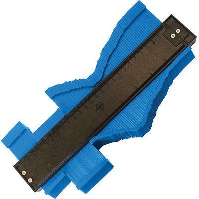

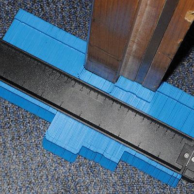

zoothorn Posted December 12, 2018 Author Posted December 12, 2018 I mean the 2cm depth/ edge, not how the face profile was made. If we call the face the width, the ~5" high the height.. I'm referring to how this chap shaped the depth/ edge, to fit onto the 'complex' skirting face profile. He pushes/ butt-joints his glued 'L' shaped section, onto skirting set in place (if his D edge was cut straight down.. it wouldn't meet without gaps twds the top- so he's shaped his edge to meet it, somehow). This is the join I'm referring to, as its not a 45* meets 45* mitre joint.
Onoff Posted December 12, 2018 Posted December 12, 2018 (edited) 31 minutes ago, zoothorn said: I mean the 2cm depth/ edge, not how the face profile was made. If we call the face the width, the ~5" high the height.. I'm referring to how this chap shaped the depth/ edge, to fit onto the 'complex' skirting face profile. He pushes/ butt-joints his glued 'L' shaped section, onto skirting set in place (if his D edge was cut straight down.. it wouldn't meet without gaps twds the top- so he's shaped his edge to meet it, somehow). This is the join I'm referring to, as its not a 45* meets 45* mitre joint. Done with a "contour gauge" I imagine then jigsaw. You'll love it! For example: https://www.ebay.co.uk/itm/High-Precision-250mm-Profile-Contour-Gauge-45mm-Deep-Decorating-Tiling-Template/381884447463? Edited December 12, 2018 by Onoff
zoothorn Posted December 12, 2018 Author Posted December 12, 2018 I can't get my noggin around it.. but sure looks a major ballache. I cant work out either pic above! (tho do get a vague semblence of the idea).
zoothorn Posted December 13, 2018 Author Posted December 13, 2018 Just worked out thats ^ the btm of a door! anyway how the heck the 'pins' fixed > then how its cut.. so I'll leave it/ I'll put outline on & trace (cant see how this blue ^ thingy helps me over this way) & faff-cut it. don't want Mikey & Co behind my cooker xyz. Extractors. Looking in Howdens some fancy flat with glass, other slanted thin steel.. but look same inside. Do these carbon filter jobs actually work, well? or are they just snake oil & only way to do effectively is to pipe outside? alas I don't have luxury of piping out (too far Im told @ 3m even if I could cut hole in roof etc/ major faff), so I either do it poor-man way recycle into kitchen.. or.. as I have the loft above, could I pipe it up into the loft space? assuming its mostly smell & some water vapour, wouldn't it just disperse ok in the failry largish area I have up there?
