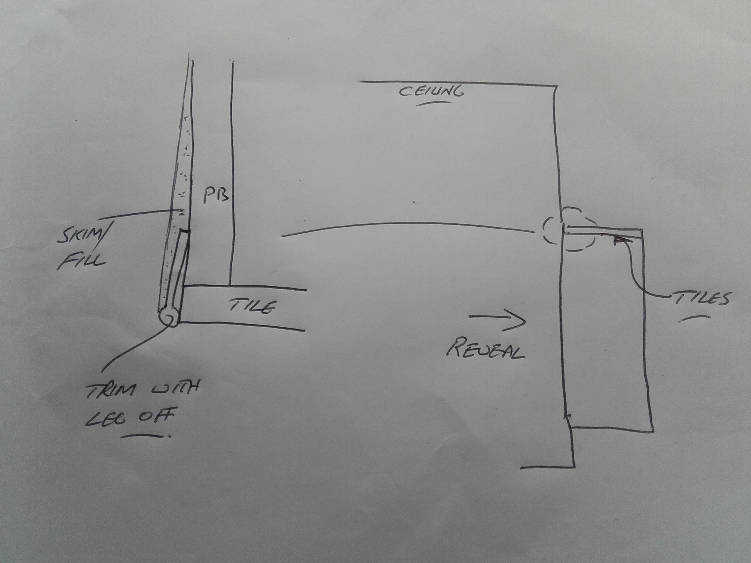

zoothorn Posted October 17, 2018 Author Posted October 17, 2018 16 minutes ago, Onoff said: What aren't you getting? Stick the feckin angle on with snot, jizzum or blue tac: If you use the stuff I suggested you will need to cut one side off with a Stanley - like you suggested. Stick the remaining side to the pb with the corner nib level with the tiles. Then back fill the edge. Ok I just needed confirmation that my basic idea -was- feasable ie cutting half of the eg pic above.. totally off (so the pic isn't representative of what I'm doing? this is why I'm confused here, these "L" shaped solid jobs it seems are exactly what I'm -not- doing.. unless I'm missing something still). Right so no nails? I thought this stuff was attatched with specific pB pin/ nails. Then I'm (eventually) filling over this half placcy side, with the pink knauff stuff-?
Onoff Posted October 17, 2018 Posted October 17, 2018 4 minutes ago, zoothorn said: Ok I just needed confirmation that my basic idea -was- feasable ie cutting half of the eg pic above.. totally off (so the pic isn't representative of what I'm doing? this is why I'm confused here, these "L" shaped solid jobs it seems are exactly what I'm -not- doing.. unless I'm missing something still). Right so no nails? I thought this stuff was attatched with specific pB pin/ nails. Then I'm (eventually) filling over this half placcy side, with the pink knauff stuff-? You can hold in place with wee panel pins if easier for you. Hold a straight edge against it as you affix. Get a smear of no nails on and let dry then fill. Fill over a fair distance to loose the "kick". Wet finger along the nib of the plastic so you get a nice straight edge.
zoothorn Posted October 17, 2018 Author Posted October 17, 2018 Kapisch all the way up to.. " Fill over a fair distance to loose the "kick". Wet finger along the nib of the plastic so you get a nice straight edge. " Mmm.. sorry don't understand the kick or the wet finger = straight edge already. So fill the gap between nib & tile edge.. with grout?
Onoff Posted October 17, 2018 Posted October 17, 2018 5 hours ago, zoothorn said: Kapisch all the way up to.. " Fill over a fair distance to loose the "kick". Wet finger along the nib of the plastic so you get a nice straight edge. " Mmm.. sorry don't understand the kick or the wet finger = straight edge already. So fill the gap between nib & tile edge.. with grout? Fill with the Knauf stuff. Run finger along plastic edge to get excess filler off.
zoothorn Posted October 18, 2018 Author Posted October 18, 2018 Aha gotcha- the pic tells me alot. ok all set to do this wknd. Thanks Onoff
Onoff Posted October 18, 2018 Posted October 18, 2018 19 minutes ago, zoothorn said: Aha gotcha- the pic tells me alot. ok all set to do this wknd. Thanks Onoff Just take your time. See my sketch, you could drop the trim down a tad slightly below the tile so the corner of the tile sits in where the uncut leg and nib meet. Would mean a shallower angle to fill.
zoothorn Posted October 18, 2018 Author Posted October 18, 2018 I think I'm with you.. so pop the nib/ beady bit down, just over the edge of the tile (down ~5mm~ in your sketch)?
Onoff Posted October 19, 2018 Posted October 19, 2018 7 hours ago, zoothorn said: I think I'm with you.. so pop the nib/ beady bit down, just over the edge of the tile (down ~5mm~ in your sketch)? Yep. Try it and see what you think. Whatever you do is a compromise when you go off piste!
