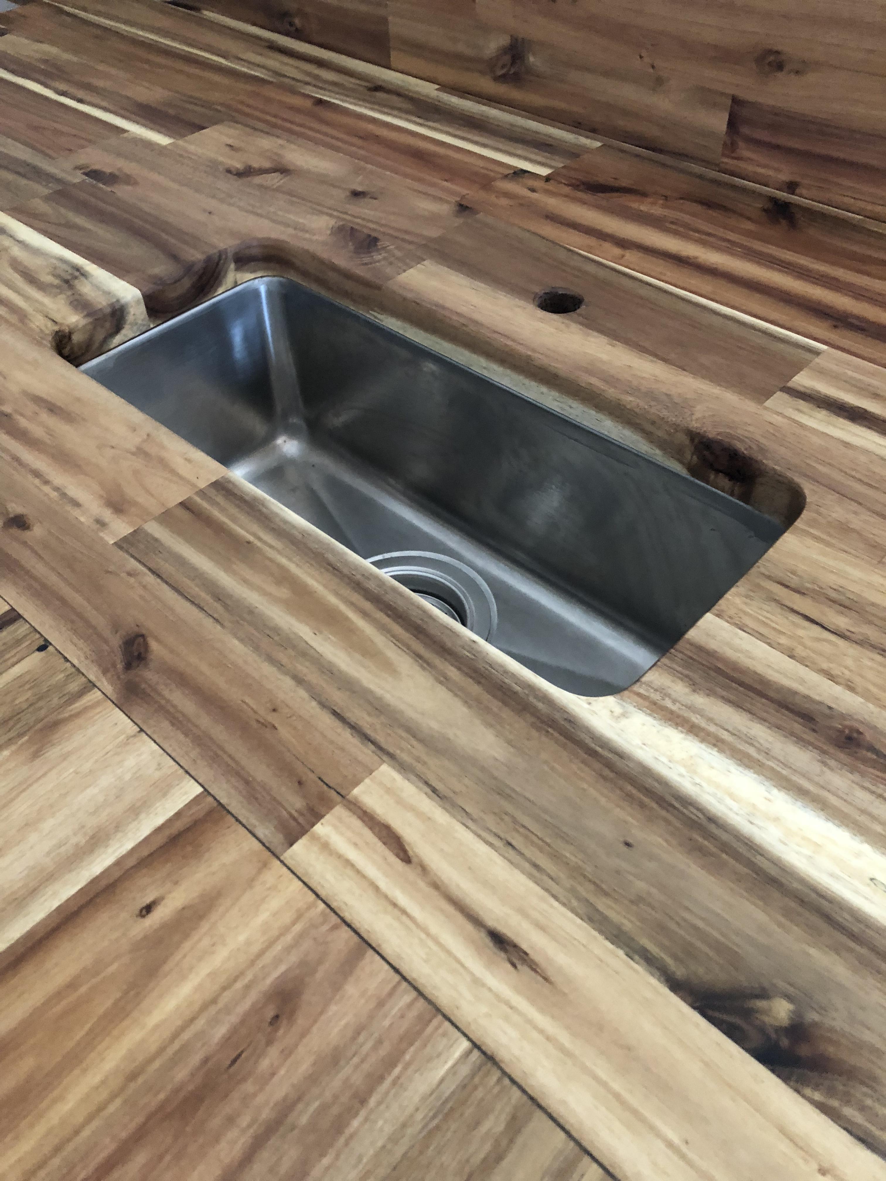

PeterW Posted September 2, 2018 Share Posted September 2, 2018 @zoothorn you need to oil the worktops when they are fitted BUT you need to fix them first with something waterproof. My go to glue for anything like this is Titebond - you can’t beat it for this sort of job. The bolts need you to rout a minimum 22mm depth groove and hole and you will have 8mm or less left - that will crack and shear and you will break it. I’ve just done 5 sections of this stuff with under mount sinks and 3 joins along both mitre joints and straight joints. I got it to 1/2mm or so and any filling was done using a mix of sanding dust and Titebond. (I have sanded these and refinished them using Osmo Top Oil for reference) All the joints are glued with Titebond, the straight joint was biscuit jointed. All joints are patched from below with 150mm glued and screwed ply panels. You can see a joint in the bottom left of this picture. 2 Link to comment Share on other sites More sharing options...
newhome Posted September 2, 2018 Share Posted September 2, 2018 @PeterW can @zoothorn use that oil as a topcoat on the finished worktop that he has or is that only appropriate if it’s sanded down as you have done? Link to comment Share on other sites More sharing options...
PeterW Posted September 2, 2018 Share Posted September 2, 2018 It will go over the top - only reason I sanded it was there were a few ripples in the width and I was making a couple of right angle joins so I wanted it perfectly flat. It also gives a fine finish as it’s had 120 and 360 grit across it on a DA sander so it’s smooth 1 Link to comment Share on other sites More sharing options...

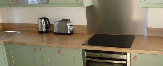

newhome Posted September 3, 2018 Share Posted September 3, 2018 Upstand is the bit that goes up the wall behind the worktop. Sometimes called a splashback. Think you had tiles there before? Whatever you need to protect that PB where the worktop joins and above it. Some PVA wouldn’t be a bad idea for now as @Onoff suggested. Link to comment Share on other sites More sharing options...
newhome Posted September 3, 2018 Share Posted September 3, 2018 Here’s one at the back of a wooden worktop. Prevents spills etc getting onto the wall. Link to comment Share on other sites More sharing options...

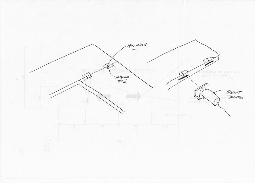

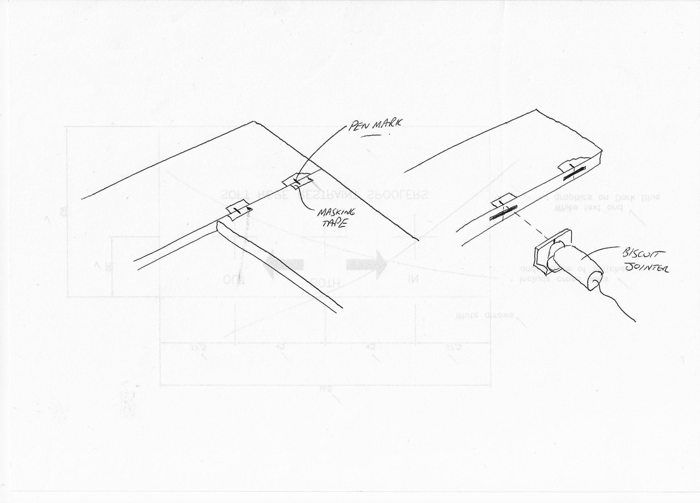

Onoff Posted September 3, 2018 Share Posted September 3, 2018 Biscuits joints... I butt the two boards together the use bits of thin masking tape either side of the join. A pen marks across the join onto both bits of tape. Do for however many biscuits you're having. Separate the worktops and draw a line down the face. Centre your biscuit joiner on the line. When they go back together it's all bang on: Link to comment Share on other sites More sharing options...

zoothorn Posted September 3, 2018 Author Share Posted September 3, 2018 (edited) 6 hours ago, newhome said: Lol, the only one I remember is Just an Illusion. Maybe ZooT has them in his record collection ?. Imagination! I can barely recall the name being of a band let alone a song.. some sort of 80's soft disco? I got Chic mind! that close enough? Onoff cheers for that- I do exactly this procedure with 3/4" pine.. rarely can I get the surface flush tho, most times its 1mm min out. Its pot luck & I can never understand why.. poor cutter it can only be/ will have to do tho. Ok bought some 3058 clear Osmo oil (howden's- bored m'aged mngr woman major flirting with zoot! he had to make excuses to get away). And 6x Hep20 elbows, 2x Hep20 1/2" > 15mm male input jobs, 20x metal inserts, coloured whatnots, some clean 15mm pipe. Can't cope with all the placcy waste bits & odd o'flow thing stuff as well/ I'd have needed a sleep outside screwfix. Have to be done wed: so if you could help with what I need on this front I'd be grateful. What I had in mind for the upstart is a long strip of hardwood (maybe 1/4" x 1" H ) all along this top, oak or so to ~match the top as best as, once top's selaed in place. Then varnish it copiously.. or Osmo it too? Then tile the sill; Is that a decent plan? Pic of cupboard inside coming up.. Edited September 3, 2018 by zoothorn Link to comment Share on other sites More sharing options...
