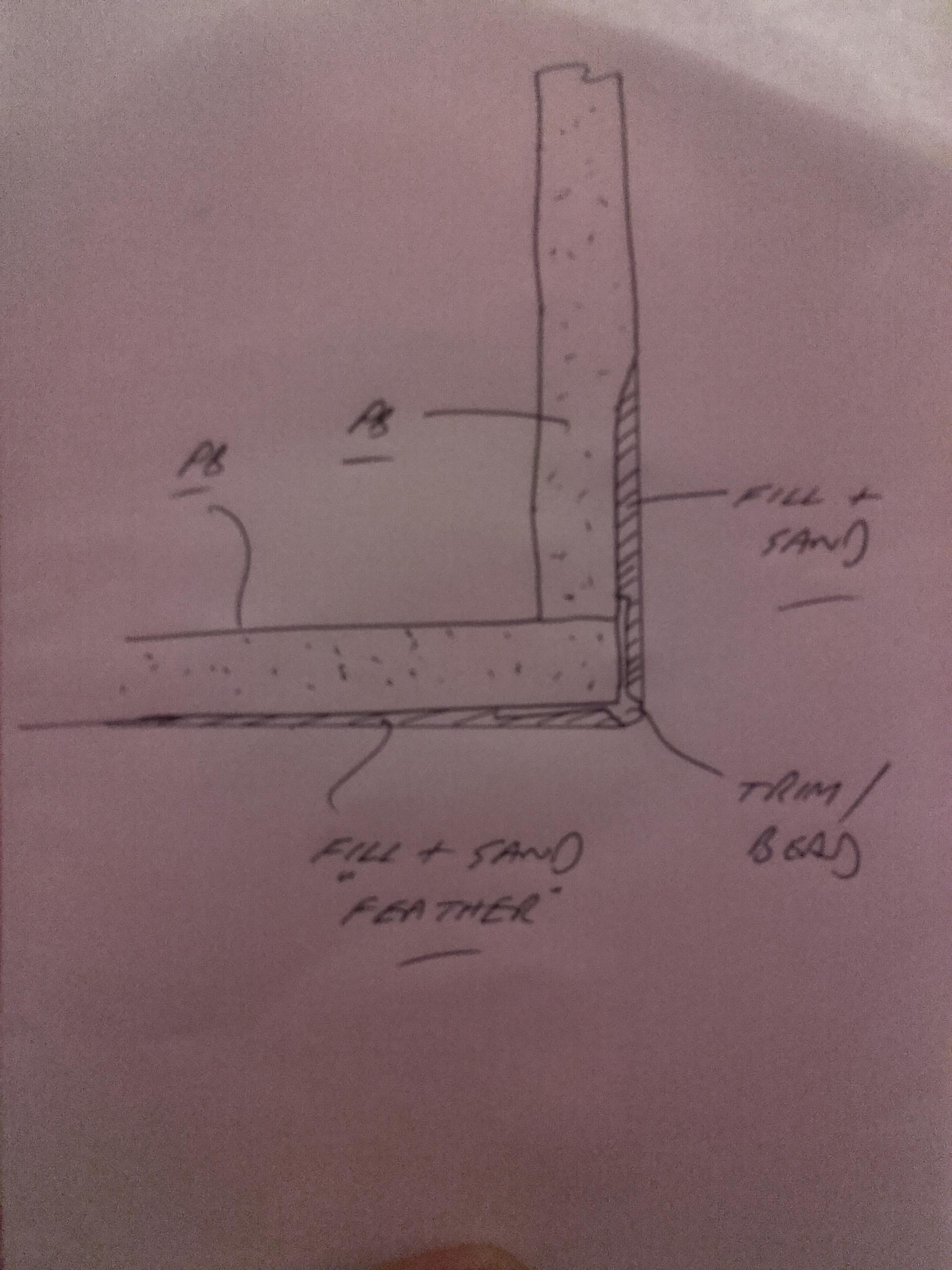

zoothorn Posted August 10, 2018 Author Posted August 10, 2018 2 hours ago, Onoff said: Halleuja! That's really looking something! Perfectly feasible to fill, sand & paint the reveal. You will have to sink the screw heads under slightly. You'll then need something like this for the top and sides assuming you put a wood sill on: https://www.wickes.co.uk/Wickes-Thin-Coat-Anglebead-2-4m/p/9000036437 Isn't the idea with these to use with 3mm skim tho? skimming's a skilled job/ a job too far for me ..
Onoff Posted August 10, 2018 Posted August 10, 2018 19 minutes ago, zoothorn said: Isn't the idea with these to use with 3mm skim tho? skimming's a skilled job/ a job too far for me .. No, you only skim the corners of the board not the whole board:
zoothorn Posted August 10, 2018 Author Posted August 10, 2018 2 hours ago, Onoff said: Ah ok I get the idea, but looks like tapered edges are part of the plan? so only possible if they're bang at the place you want tho.. @ edge of the reveals; my PB's will be all std edge at these edges.
Onoff Posted August 10, 2018 Posted August 10, 2018 1 minute ago, zoothorn said: Ah ok I get the idea, but looks like tapered edges are part of the plan? so only possible if they're bang at the place you want tho.. @ edge of the reveals; my PB's will be all std edge at these edges. As I said earlier I couldn't tell from your camera res but it can be two tapered edges meeting, two straight edges or one of each. So if yours is two "standard" edges you'll need to feather both sides.

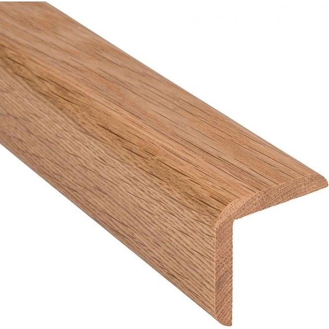

Onoff Posted August 10, 2018 Posted August 10, 2018 You could cheat and stick this sort of thing up the sides and across the top and forget the filling:
zoothorn Posted August 10, 2018 Author Posted August 10, 2018 Ah hang on I did have tapered is PB didn't I.. but unfortunately (for this idea) the 2nd go at these 4 panels & they're all uniform flat (bar top bit of sides). If that's what you meant, I'm impressed you remembered that i had tapered ins PB. But only 2TE mind you. I can't see why, inprinciple I can't just fill the edge thats showing.. but I guess that's n/a. What is feathering involve, apart from feathers? [[[ onoff I'm concerned: you need time off for now.. pick this up tmrw. ]]] huge thanks. zootH
Onoff Posted August 10, 2018 Posted August 10, 2018 18 minutes ago, zoothorn said: Ah hang on I did have tapered is PB didn't I.. but unfortunately (for this idea) the 2nd go at these 4 panels & they're all uniform flat (bar top bit of sides). If that's what you meant, I'm impressed you remembered that i had tapered ins PB. But only 2TE mind you. I can't see why, inprinciple I can't just fill the edge thats showing.. but I guess that's n/a. What is feathering involve, apart from feathers? [[[ onoff I'm concerned: you need time off for now.. pick this up tmrw. ]]] huge thanks. zootH Feathering is just where the filler is thick at the corner then itself tapers by sanding down to blend into the wall.
