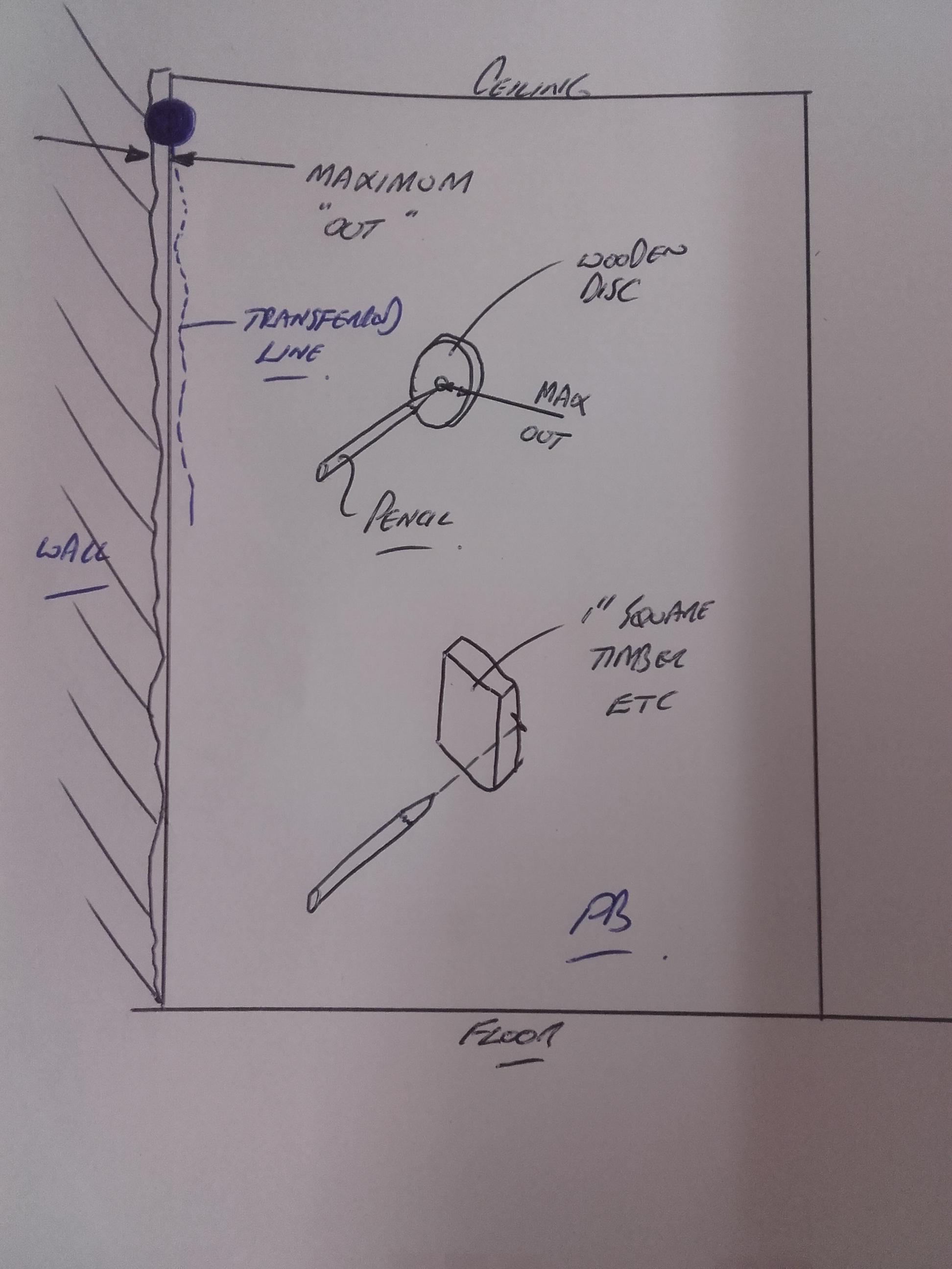

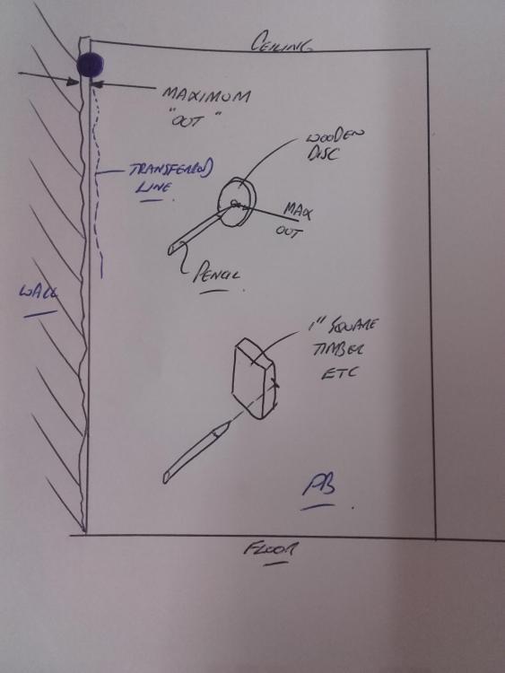

Onoff Posted August 6, 2018 Posted August 6, 2018 (edited) Pretty sure someone said something similar earlier I think....NO I'm not going back to find who/when! Butt your board up to the dodgy wall. Measure the maximum that it's "out". Cut a disc with a hoke in the middle. The appropriate sized hole saw would be ideal. Run it down the wall/board and you'll get the near exact profile of the dodgy wall transferred to the pb. Alternatively use a small block of timber and do much the same thing. Or just a straight edge if the outs are long, straight sections. Then cheap plaster filler etc which you can get in a tube. This dries semi hard so you can sand it: https://www.screwfix.com/p/no-nonsense-instant-plaster-filler-white-310ml/72591? Or even cheaper caulk. This is a bit more rubbery: https://www.screwfix.com/p/no-nonsense-decorators-caulk-white-310ml/57568 Edited August 6, 2018 by Onoff
zoothorn Posted August 6, 2018 Author Posted August 6, 2018 good one onoff- I think I get the idea(..)/ recall Peter I think said somthing similar, morelike your block/ pencil idea. I like your diagrams! I may be tempting fate by asking so soon.. but can I get away with -not- plaster/ skimming these PB's? I will be tiling + units hiding 3/4 of the PB area.. but still leaves some mostly near door/ immediately noticeable. (Is that basically the principle of these 2 fillers you link to-?)
