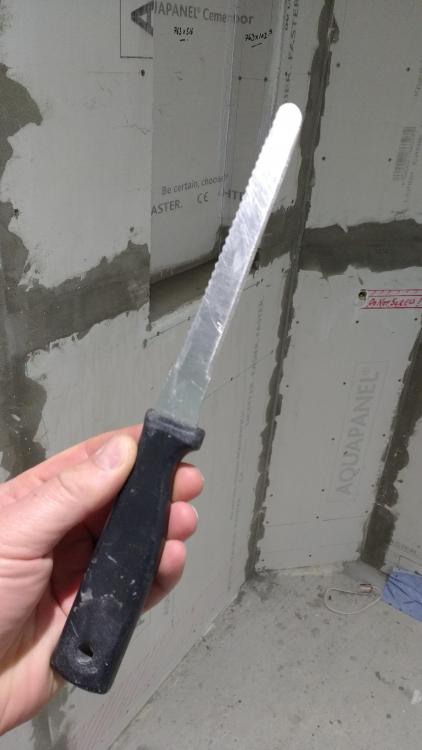

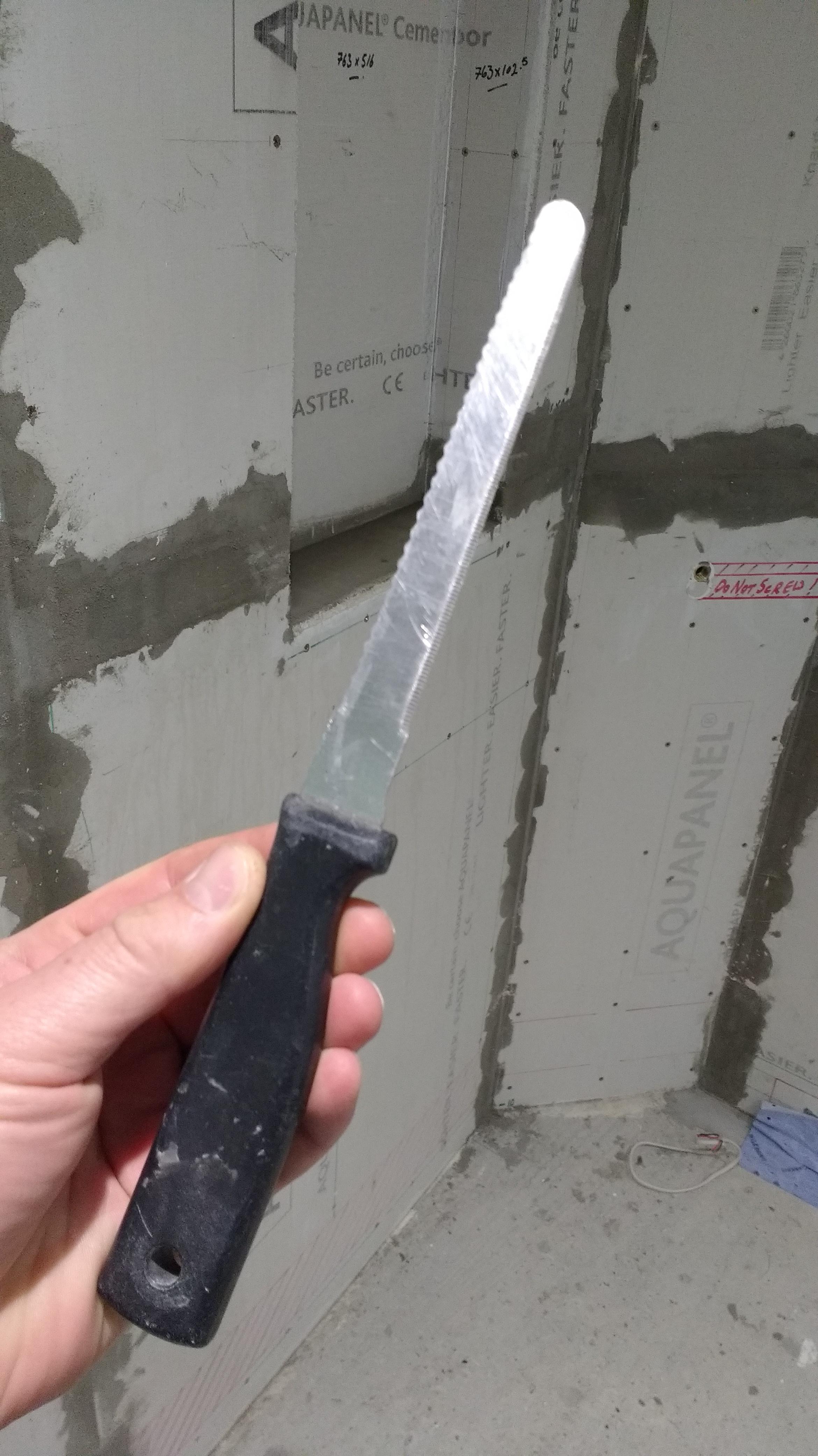

Onoff Posted July 30, 2018 Share Posted July 30, 2018 My weapon of choice for trimming foam. Old bread (?) knife. Wavy one side and serrated the other. I seem to remember it was forked at the end at one time. It's seen use for weeding before! And my other weapon of choice. Reminds me of the Party Sevens as a kid! A winning combination! Link to comment Share on other sites More sharing options...
