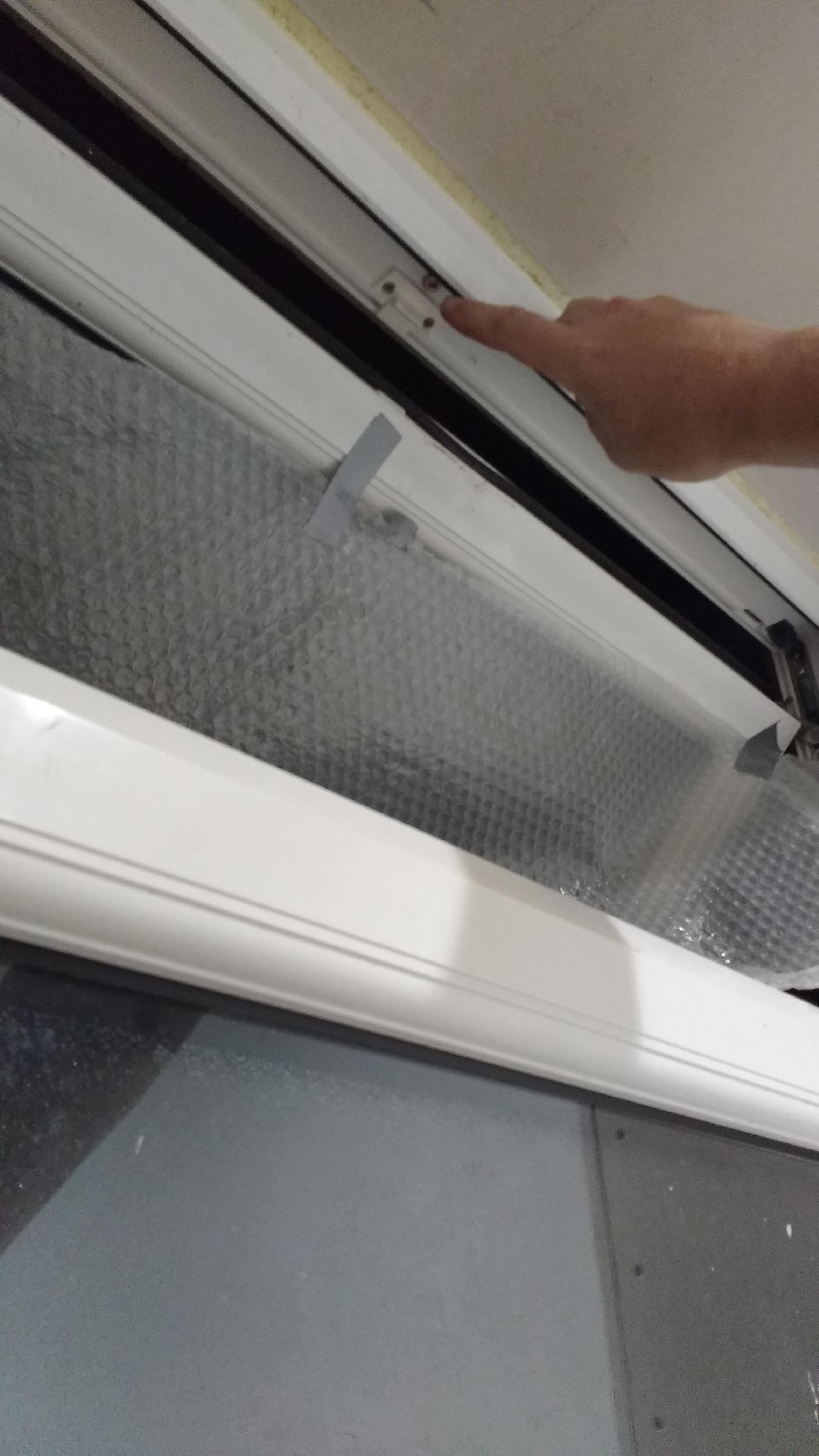

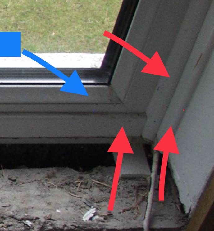

zoothorn Posted July 29, 2018 Author Posted July 29, 2018 Ok thanks Peter- I'll cross this bridge when I come to it/ a ton to do b4. The window reveal is prooving a v. tricky prospect for me a 1st timer, even with onoff's pics. Ive put up one batten only today- rest of day Ive been researching this window area/ hopefully to do tmrw. I'm trying to establish what bits of my upvc frame are what: additions/ to remove (& what the 3 white things below frame are). And whether they need removing. It looks on 1st glance to be all same unit but maybe some are trims added on a flat frame? Can anybody help me out on this, looking at this pic again..

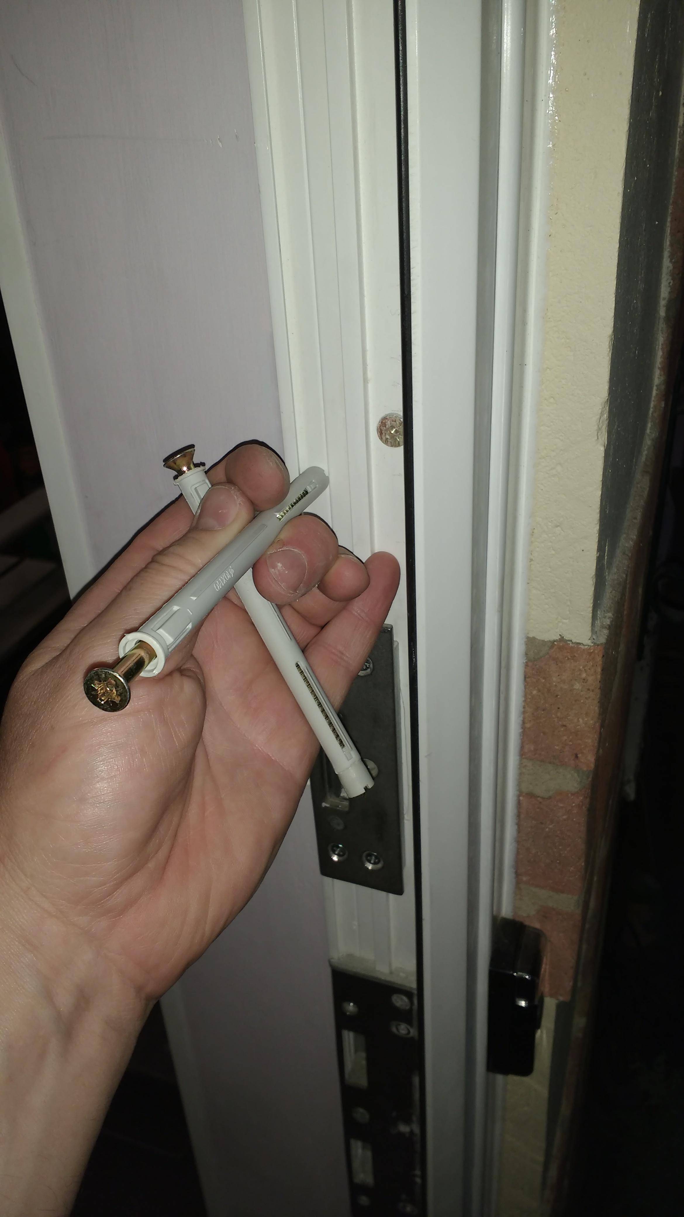

Onoff Posted July 29, 2018 Posted July 29, 2018 37 minutes ago, zoothorn said: Onoff Ive gone over your reveal pics again 3x (I get the idea now- all a blur before tbh!). Ok once your upvc trims removed your window seems to be floating.. remind me how its fixed in will you, or I'm nervous removing my trims thinking the window's gonna fall out! Ok screwfix tmrw to get that soudal stuff, & a gun-type standard foam can. And to pillage some 2" polystyrene from s'where.. now I get the idea to wedge in my cavity gap & then foam onto. Is norm,al polystyrene the idea (is this eps?) or do I need builders grade stuff. You say your 27mm pb 'screwed on' the batten at front.. are all the PB > stud fixings screws? or is it only the reveal.. I thought the PB > stud fixings were those grey big flat head 1" or so 'roofing felt' nails.. no? Upvc windows...who knows how they're fixed! On a retro fit ideally the frames are first put in using frame fixings. Then the frame is glazed. It's been know for the windows to be held in place and JUST foamed! As yours was an extension they might have used little clips that attach to the frame and get incorporated into the mortar joints as the wall was built. Afraid you won't know for sure until the trim comes off. If you can't score some eps just use gun foam. Don't forget a can of gun cleaner, it's essential imo when changing cans over on the gun! It doesn't last long when using so get two if you can stretch to it. Pb is fixed to timber battens using special black screws often referred to as "dry wall" screws. Phosphate coated I think. Shown here 35, 45 & 55mm long. I bought them in bulk, cheap when Lidl were doing them last. I used the longer ones to fix thru the 27mm insulated pb. I also bought an auto feed plasterboard screw gun again from Lidl that takes these: Thats another story. Presume you'll be using a cordless and standard pb screws. 25mm drywall screws are the shortest usually but I'm thinking you might want to go 32mm as your battens might not be dead straight. https://www.screwfix.com/p/easydrive-black-phosphate-bugle-head-twin-thread-uncollated-drywall-screws-3-5-x-32mm-1000-pack/16374#product_additional_details_container
zoothorn Posted July 29, 2018 Author Posted July 29, 2018 Bugger I thought PB was fixed on quick/quick with those felt nails.. gonna be a long job with screws & a big heavy cordless. I'm also wondering how the heck I'm going to hold the PB up to fix it on.. anyway I need to get xyz done before this prospect. I'm out of my depth again i can feel it. Still chewing over this damn window area. With no experience I can't tell if I undo the trims whether the window will fall out/ if they are part of the structure of the frame or not. I might therefore have to leave them as is & just try & do the sill area.. far from easy for me just this. Onoff do I need a dpm or not? as I said I found none before under the sill I took out, so if it aint broke..
newhome Posted July 29, 2018 Posted July 29, 2018 53 minutes ago, zoothorn said: I'm out of my depth again i can feel it. Still chewing over this damn window area. With no experience I can't tell if I undo the trims whether the window will fall out/ if they are part of the structure of the frame or not. I might therefore have to leave them as is & just try & do the sill area.. far from easy for me just this. I feel like that every time I do something TBH but this forum is amazing and generally sets me right. You'll be fine.
PeterW Posted July 29, 2018 Posted July 29, 2018 Ok @zoothorn You should be able to remove all the red arrowed bits, the glass will only fall out if you remove the blue arrowed one..!

zoothorn Posted July 29, 2018 Author Posted July 29, 2018 1 hour ago, PeterW said: Aha nice one Peter- useful gizmo to add arrows! most helpful again. Do you think you can guarantee if I undo these, the frame won't become loose? I'd like to think its set in with either mortar &/ or frame fixing screws like my concrete jobs > then glass pane on. But the way this place was built so badly makes me very wary.

Onoff Posted July 29, 2018 Posted July 29, 2018 Take a look and see if there's any evidence of the frame being fixed with 'em. This is one of my doors, got off a mate as a freebie and repurposed! Some spare frame fixings shown too: As I said earlier though, with fixed windows they tend to fix the frame first then put the glazing in so you don't see the fixing. With openers you should see the fixing like above. Sometimes one visible at the top too though this can be a pig to drill because of the lintel. Take the trim off of one side to start with. I almost can g'tee you'll see a scary gap. You can then see if there's any frame fixings in there. Fill the gap with low expansion foam. Keep any windows shut whilst it sets is another tip. That way it fills up the unwanted gap at the side rather than expanding and squeezing the opened window opening! You can protect the uPVC with some masking tape etc against foam getting on the frame. In your case I wouldn't worry about a dpm like I did.
