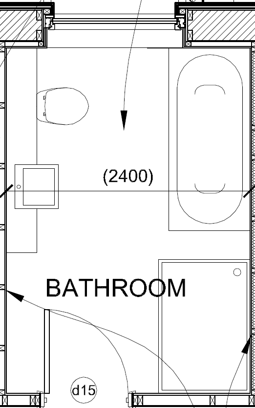

jack Posted June 18, 2018 Posted June 18, 2018 13 minutes ago, Nickfromwales said: That's exactly what @jacks plumbers did with wait times of 45 seconds for hot water to basins. They somehow did worse than that. The shower in this bathroom takes 3 seconds to start warming up. The basin takes over 40 seconds. The downstairs plant room with UVC is just to the right of right hand wall: I assume the shower pipework goes straight up inside the wall, whereas the basin suffers from a much longer route. It's possible the longer route was required to get around, eg, drainage and MVHR runs. I'm just not sure. We should definitely have had HRC to our kitchen (~12m run from UVC) and downstairs toilet (~8m run).

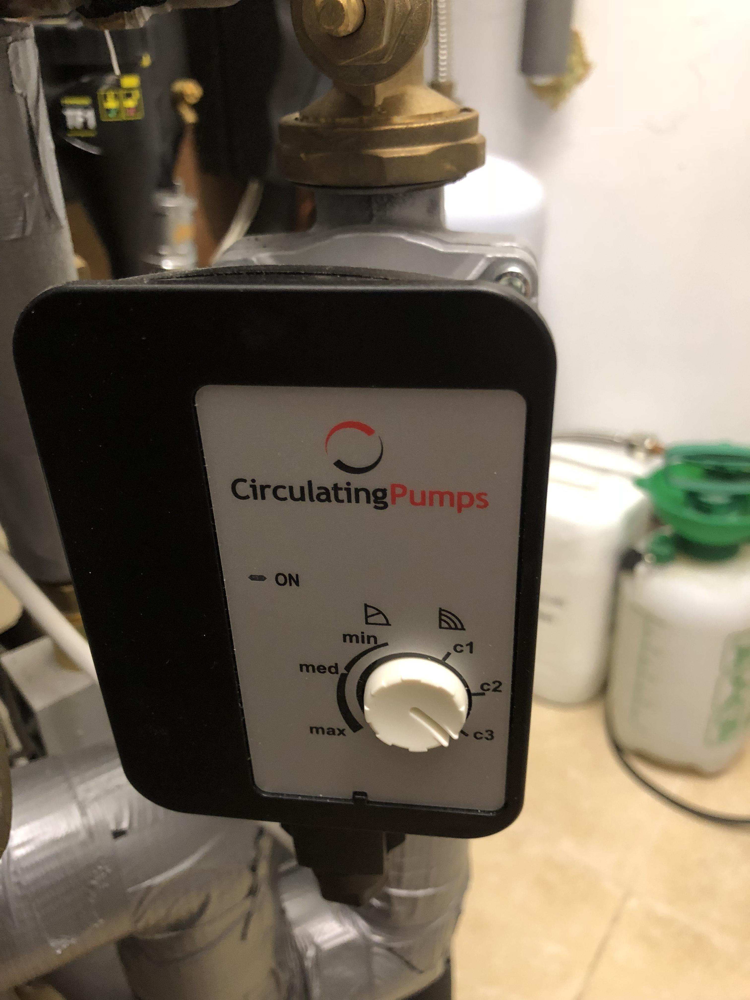

newhome Posted June 18, 2018 Posted June 18, 2018 (edited) 51 minutes ago, PeterW said: And all the joy of a TS with a HRC.... hmm.... flow switch and pump anyone..?? @newhome...? I think the fact that I have no idea what you’re on about is probably a good thing at this point What’s an HRC? Edited June 18, 2018 by newhome 1
newhome Posted June 18, 2018 Posted June 18, 2018 8 minutes ago, Nickfromwales said: What happens on tour stays on tour. Was that when @PeterW dressed up in my clothes when I was collecting that bloody flow switch from hundreds of miles away?
Nickfromwales Posted June 18, 2018 Posted June 18, 2018 1 hour ago, newhome said: What’s an HRC Hot Return Circuit. The pump you have that ( when fitted correctly ) massively reduces the delay in getting hot water out of any outlet. 1
newhome Posted June 18, 2018 Posted June 18, 2018 1 minute ago, Nickfromwales said: Hot Return Circuit. The pump you have that ( when fitted correctly ) massively reduces the delay in getting hot water out of any outlet. Thanks! So I don't have one of them?
PeterW Posted June 18, 2018 Posted June 18, 2018 Yep you’ve got one @newhome and the flow switch makes it work ..... worth the 7 hour drive eh..??
newhome Posted June 18, 2018 Posted June 18, 2018 1 minute ago, PeterW said: Yep you’ve got one @newhome and the flow switch makes it work ..... worth the 7 hour drive eh..?? Cool! Yeah, I've finished my time in rehab recovering from that day so all good now .

newhome Posted June 20, 2018 Posted June 20, 2018 5 minutes ago, Nickfromwales said: ( whispers gently ) it's the green pump, behind that one So which is the HRC? The green one or the one I posted further up? And what does the other one do? 2 minutes ago, Nickfromwales said: You do, but I doubt that whomever plumbed the system ran the HRC return pipework all the way to each basin so, although the system works, it's not reducing the delay for hot water as effectively as it could be. Better than nowt though, and you'd soon notice the difference if it wasn't working at all. Aye, it's a bit of a pain but hey at least the hot water arrives eventually. Previously I had none unless the heating was on!
Nickfromwales Posted June 20, 2018 Posted June 20, 2018 The smaller green one that originally had the cover missing and the wires exposed. That's the HRC pump. The one in the pic is the pump that's heats the PHE so it can produce hot water. Without that pump the PHE would stay cold and you'd get no heat into the cold water going into it. The PHE is an instant water heater but needs heat passing through the primary side of it first so it can pass that heat indirectly to the secondary side. 1
