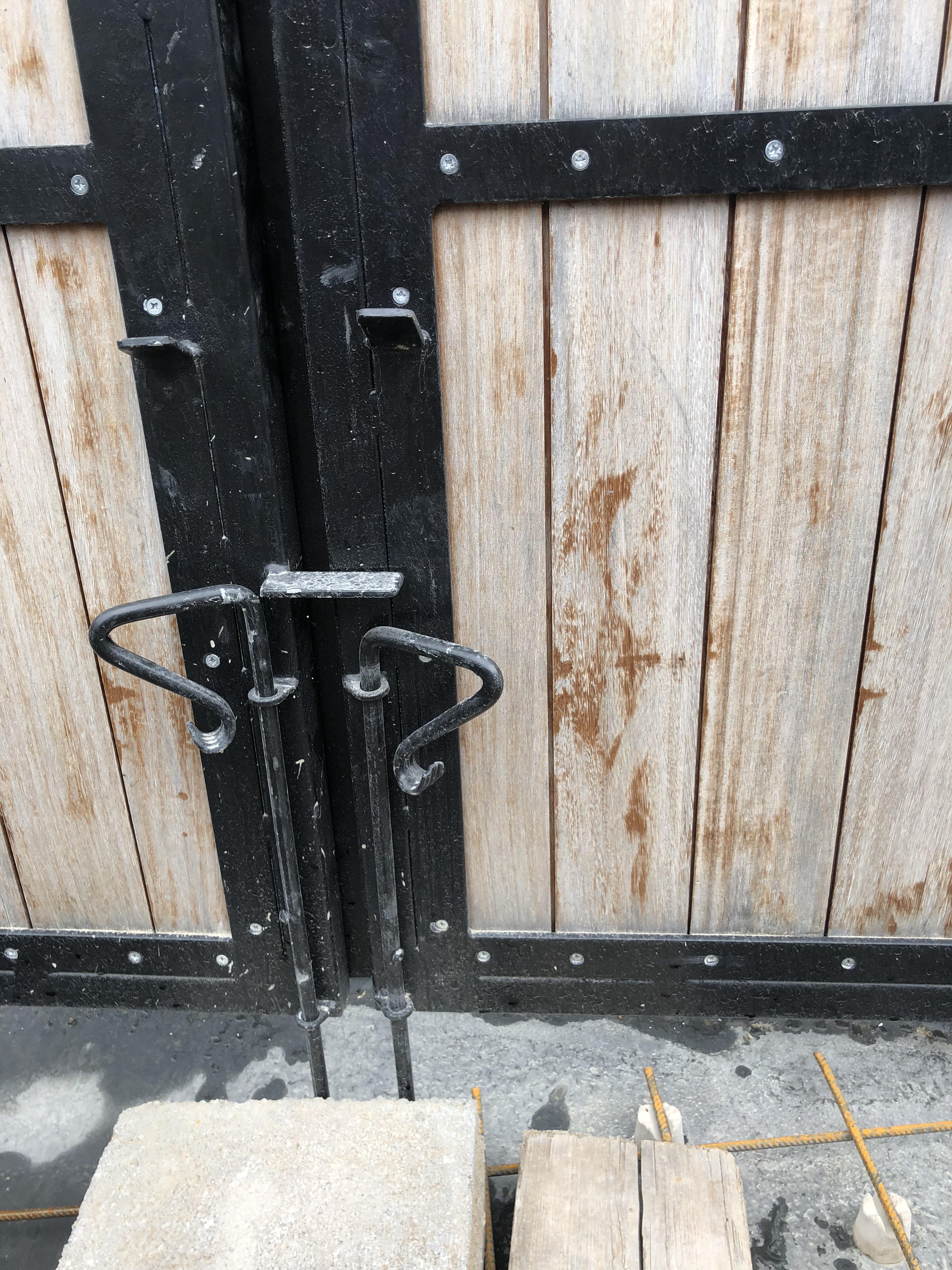

Pocster Posted June 16, 2018 Posted June 16, 2018 Hey all My gates have faded somewhat I think they are made of Iroko (????) You can just make out the remains of the deep rich colour they once were . Any recommendations for a varnish that will bring the natural colour back out ?? cheers

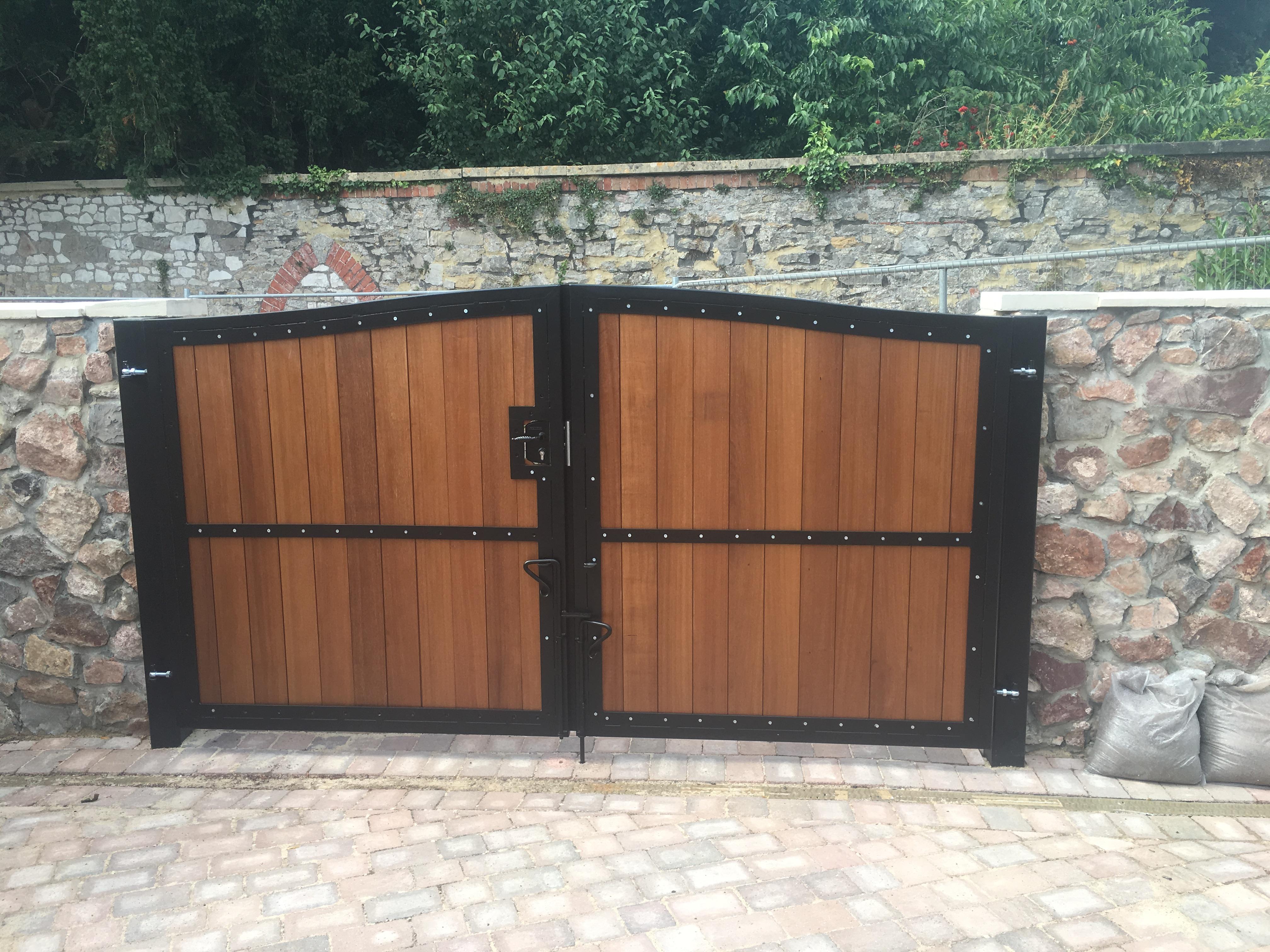

Pocster Posted June 16, 2018 Author Posted June 16, 2018 Just found this old photo - wow , it’s faded a lot !!
Onoff Posted June 16, 2018 Posted June 16, 2018 Isn't iroko a cheaper substitute for teak? Maybe this: https://www.force4.co.uk/wessex-teak-care-system-1ltr-pack.html? FFS don't use "teak oil". It's got nothing to do with the oil from teak and will damage the teak's own oils.

Onoff Posted June 16, 2018 Posted June 16, 2018 You need to clean the wood first I think hence suggesting the teak kit which comprises a cleaner then sealer. Used on boat decks etc.

Jeremy Harris Posted June 16, 2018 Posted June 16, 2018 Stains don't work that well with iroko, in my experience, as it's very like teak; naturally oily and very close grained, so stuff doesn't soak into it at all well. There are yacht deck treatments, like Deks Olje, that work well. Not cheap though.

Jeremy Harris Posted June 16, 2018 Posted June 16, 2018 16 minutes ago, pocster said: Thanks not worried about cost ; just want the best product for the job You probably want to look at restoring the colour first, using one of the teak deck colour restoring treatments. Anything that works on teak generally works fine on iroko. This stuff works well at restoring the original colour: http://www.teakcleaner.co.uk/

James H Posted June 17, 2018 Posted June 17, 2018 They look like they are made of Iroko, when new they probably had a coat of oil based varnish on. To bring them back to what they were tahes alot of work to compleat and maintain some sort of work needing every year and may be more often. First it would all need sanding down to bring back the colour, or you paint it dark colour. You would still have the problem of water peneration under metal parts and in the t&g joints which would then lift the finish off and lead to rotting. I am sorry to sound so down it could look lovely but it is alot of work. My advise is to let it grow old gracefully.

Jeremy Harris Posted June 17, 2018 Posted June 17, 2018 Worth trying teak cleaner to see if it brings the colour back: http://www.teakcleaner.co.uk/ 1
