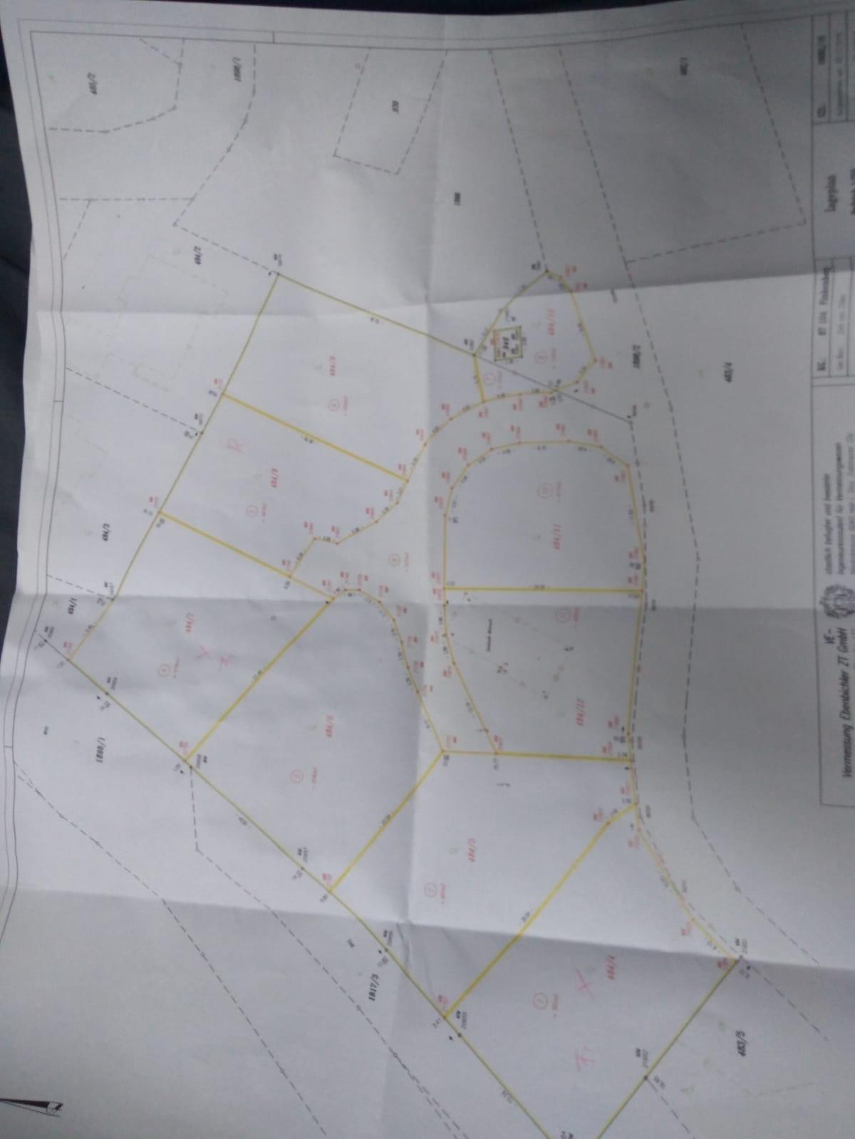

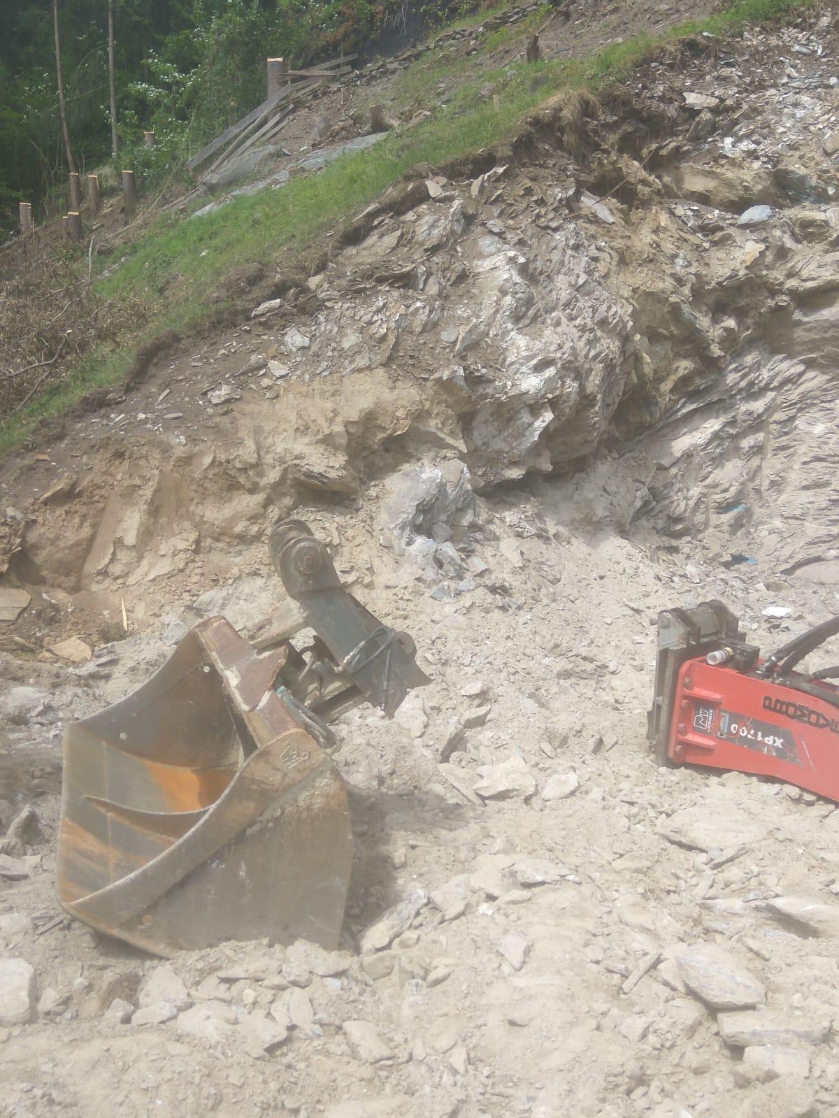

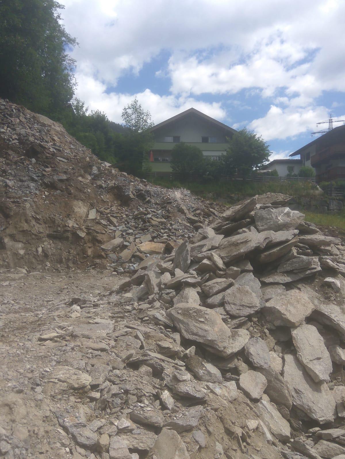

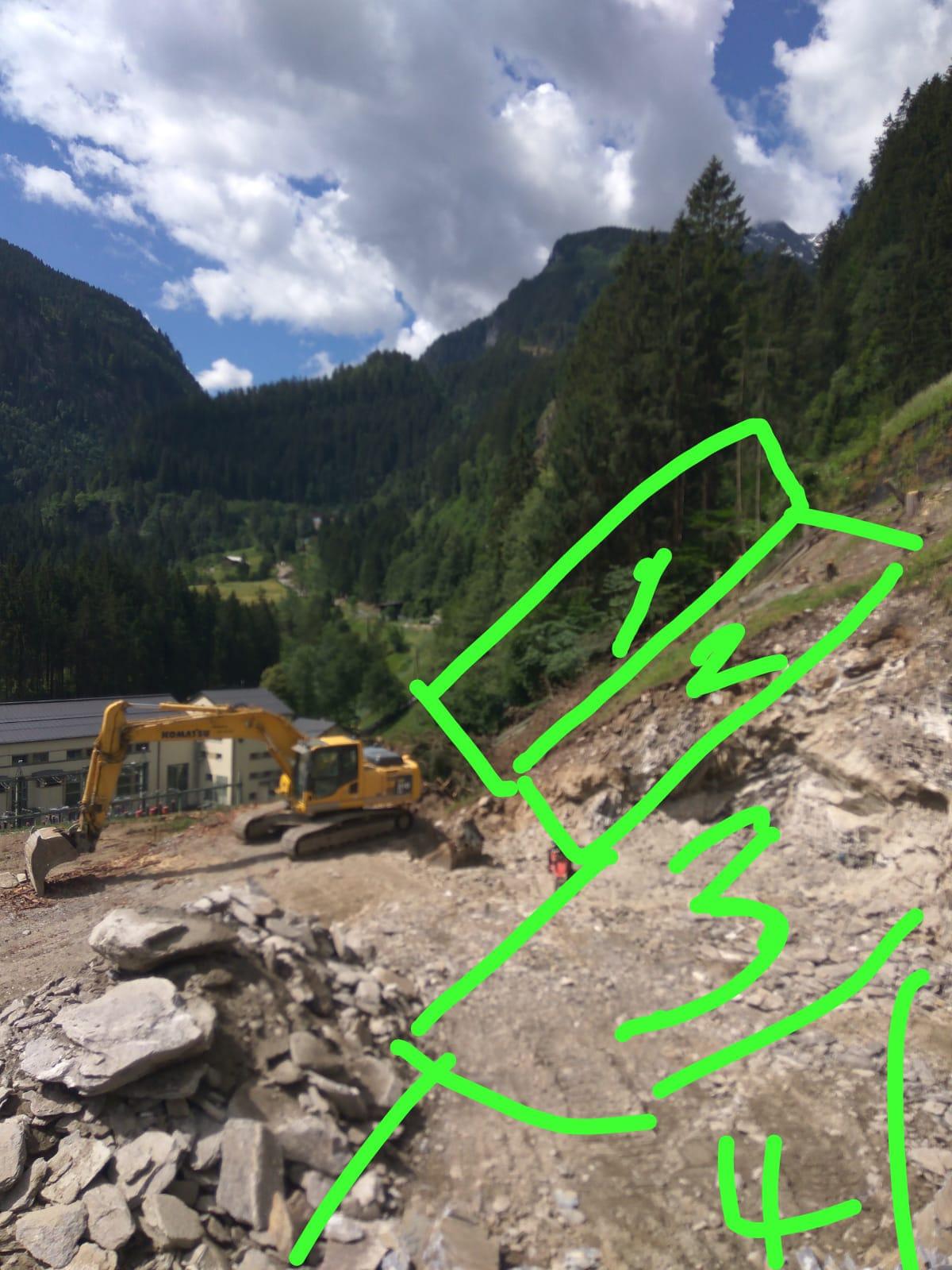

Lydia Posted June 13, 2018 Posted June 13, 2018 Hi, We're tempted to sign for a plot of land 450m2 but it's very steep and rocky. Plot one. How much should we budget for a retaining wall? What options are available to us? Has anyone got personal experience of this? Do you have any advice or tips? Thanks for your time.
ProDave Posted June 13, 2018 Posted June 13, 2018 That is one challenging plot. Perhaps made easier by the fact it is on solid rock? That will surely be very expensive to build on, and even when you do, what garden are you going to have? We looked a a plot with only half that slope and walked away as it would definitely end up costing more to build than the house would be worth.

Russell griffiths Posted June 13, 2018 Posted June 13, 2018 Would this not be easier if the developers put in the retaining structure surely there needs to be some symmetry between all the walls in the other gardens. Also looks like he already has kit on site and must have consulted somebody before he chopped the side out of that hill.
