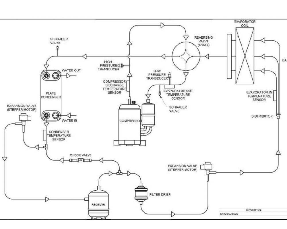

ProDave Posted June 8, 2018 Share Posted June 8, 2018 I am trying to comission my ASHP and can't get it working, and finding the supplier so far frankly useless. At first I thought it was a controls issue, because the web based diagnostics is not showing the water flow rate, so I thought it was refusing to run because it thought there was no water flow. But now I am coming to the conclusion that is a red herring and the on line diagnostics are not much of a reflection on what is actually happening. So I am trying to do some self diagnostics and wonder if it's a refrigerant problem. Here is the refrigerant pipework diagram from the manual What is happening, you give the heat pump a heating demand. the fan starts up. The compressor starts up and ramps up in speed. After a short while the output pipe from the compressor starts to warm up. Notice the term warm up, it is by no means "hot" just warm. Nothing much seems to flow around the regrigerant circuit, you can just detect slight warmth in the pipe going into the reversing valve, but I can't detect any warmth making it past there out of the reversing valve and certainly no warmth reaching the plate condenser. After a couple of minutes the inverter ramps up a bit faster in speed then it all shuts down. Am I right to be thinking this may be a lack of regrigerant in the system and that might be the problem rather than an electrical fault? I am trying to formulate an understanding of what might be wrong before I go back to the supplier wihich probably won't be until Monday now. Link to comment Share on other sites More sharing options...
Onoff Posted June 8, 2018 Share Posted June 8, 2018 I just asked an AC guru I know from site, he wrote: "If it’s new and no refrigerant has been lost on installation then perhaps check the operation of the reversing valve as it can only do one operation at any one time If it’s going in through two circuits at once the compressor may shut down due to the transducer reading pressure/ temps that aren’t correct" Cheers Terry for the pointers if you're reading this! Link to comment Share on other sites More sharing options...
ProDave Posted June 8, 2018 Author Share Posted June 8, 2018 Just to clarify it was sold to me as "new" 11 months ago, but I found out when I got it it was not actually "new". It looks in new condition i.e. it has not been installed anywhere outside, but the paper labels on all the connectors on the wiring loom suggest it might have been used as a training or demo unit. Anyway I have just found the "event log" and that confirms it is tripping on a "low pressure" fault so I think that confirms it either has a leak, or was supplied to me with no refrigerant. Monday's phone call could be "interesting" I did a quick search for refrigeration engineers up here and only one answered the phone this late on a Friday. He estimated £160 for the labour to re gas it and a similar amount for the gas. That sounds like a piss take to me. I can't think it's more than an hour to re gas it, and how much does 1.8Kg of R410A actually cost? Can you ask your mate what a proper re gassing cost would be? And to be clear it's a monoblock unit. Link to comment Share on other sites More sharing options...
Onoff Posted June 8, 2018 Share Posted June 8, 2018 Says Terry: "R410A is anywhere from £80 to £100 a kilo in this part of the world When he runs it feel the temperature across the drier and the check valve If there’s a temp diff the drier may be choked or the check valve may be stuck" Link to comment Share on other sites More sharing options...
ProDave Posted June 8, 2018 Author Share Posted June 8, 2018 So the gas cost I was quoted is about right, I need to work on getting someone cheaper for the labour. I will let you know how the conversation goes on Monday when I suggest the supplier pays for the re gassing. As I say when you run it, it is ONLY the output from the compressor that gets at all warm. That warmth never makes it anywhere near far enough around the circuit so at the drier and check valve both input and output pipes to both are stone cold. As the gas is so expensive, is is possible to fill the system say with compressed air to check for leaks first (obviously without trying to run it like that) and if the pressure holds, vent the air and fill with gas? Can I make any pressure tests at either of the Schrader valves? what sort of pressure would we expect at each? Link to comment Share on other sites More sharing options...
Jeremy Harris Posted June 8, 2018 Share Posted June 8, 2018 Regards the labour, if the bloke is going to do it properly, then he needs to do the following: Fit a vacuum pump and pump the refrigerant side down to ensure there is no moisture in there. Do a vacuum test to check for gross leaks. Weigh in the exact amount of refrigerant (he'll put the bottle on a scale and measure the weight of refrigerant added to get it right). Add fluorescent dye when filling with refrigerant (which may well come with dye already in). Let the temperature and pressure stabilise for 15 to 20 minutes. Check for leaks with a UV lamp. Test the unit and check that the low and high pressure sides are at the right working temperature and pressure. Just filling the unit up with more refrigerant, without doing the checks, could well be a waste of money, as there has to be a good reason for the unit having lost gas. Generally they are like refrigerators, and rarely just lose gas without there being a leak somewhere, and as they are sealed systems the leak can be very small and hard to locate without the dye and UV light. Link to comment Share on other sites More sharing options...
Onoff Posted June 8, 2018 Share Posted June 8, 2018 This just back. I was going to say nitrogen too so I must have picked something up from him! "Wouldn’t put anything else in but OFN (oxygen free nitrogen ) as all the others may have consequences Anything put in will require vac out to about 1 torr and some gases become explosive when mixed with fridge oil The only way to check the refrig side is to put some fridge gauges on it to assess gas levels Does sound short or possibly completely empty to me , compressor discharge should be to hot to touch" Link to comment Share on other sites More sharing options...
ProDave Posted June 8, 2018 Author Share Posted June 8, 2018 Given the history., I am hoping it is not a leak, but was supplied to me with no or low gas. When I first got it, I tried to run it up, but with no water connected. I expected the input to the PHE to start getting very hot very quickly and I would have then shut it off. but it didn't. it behaved as it is now, the compressor ran for a couple of minutes and nothing got hot. I didn't do any more then as I thought it was shutting down because of no water flow. And to be clear I didn't just run it and cook the thing, it honestly did not get hot. So if it's got no gas, that is how I received it. EDIT Just looked back at the event log for 10 months ago and it is logging water flow AND low pressure as faults so it was low on gas then, it has not just leaked out over the last 10 months. Link to comment Share on other sites More sharing options...

Jeremy Harris Posted June 9, 2018 Share Posted June 9, 2018 Well worth pushing to get it fixed under warranty, especially as it sounds as if it had lost refrigerant before you received it. I suspect it has a leak, which means it will need to be vacuumed, held under vacuum to get any moisture out, then refilled and leak tested. Any refrigeration/air con engineer that holds an F gas ticket can do the job in an hour or so. The main concern that I'd have is whether a warranty repair might end up being just a re-gas, without a proper leak test. If there is a leak, then just re-gassing the unit may get it working for a while, until the refrigerant leaks out again after the warranty has expired. Link to comment Share on other sites More sharing options...
ProDave Posted June 9, 2018 Author Share Posted June 9, 2018 If it has a leak, I think it is a gross leak as I am 99% sure now it had no gas when I received it, I don't think it has slowly leaked out over the intervening 11 months. So hopefully that wold be obvious on re gassing. I am convinced, for various reasons, that this unit was previously used as some form of in house training or development. If that theory is right, regular de gassing and re gassing might be something they did to it and forgot to fill it again. Well you can live in hope. Link to comment Share on other sites More sharing options...
