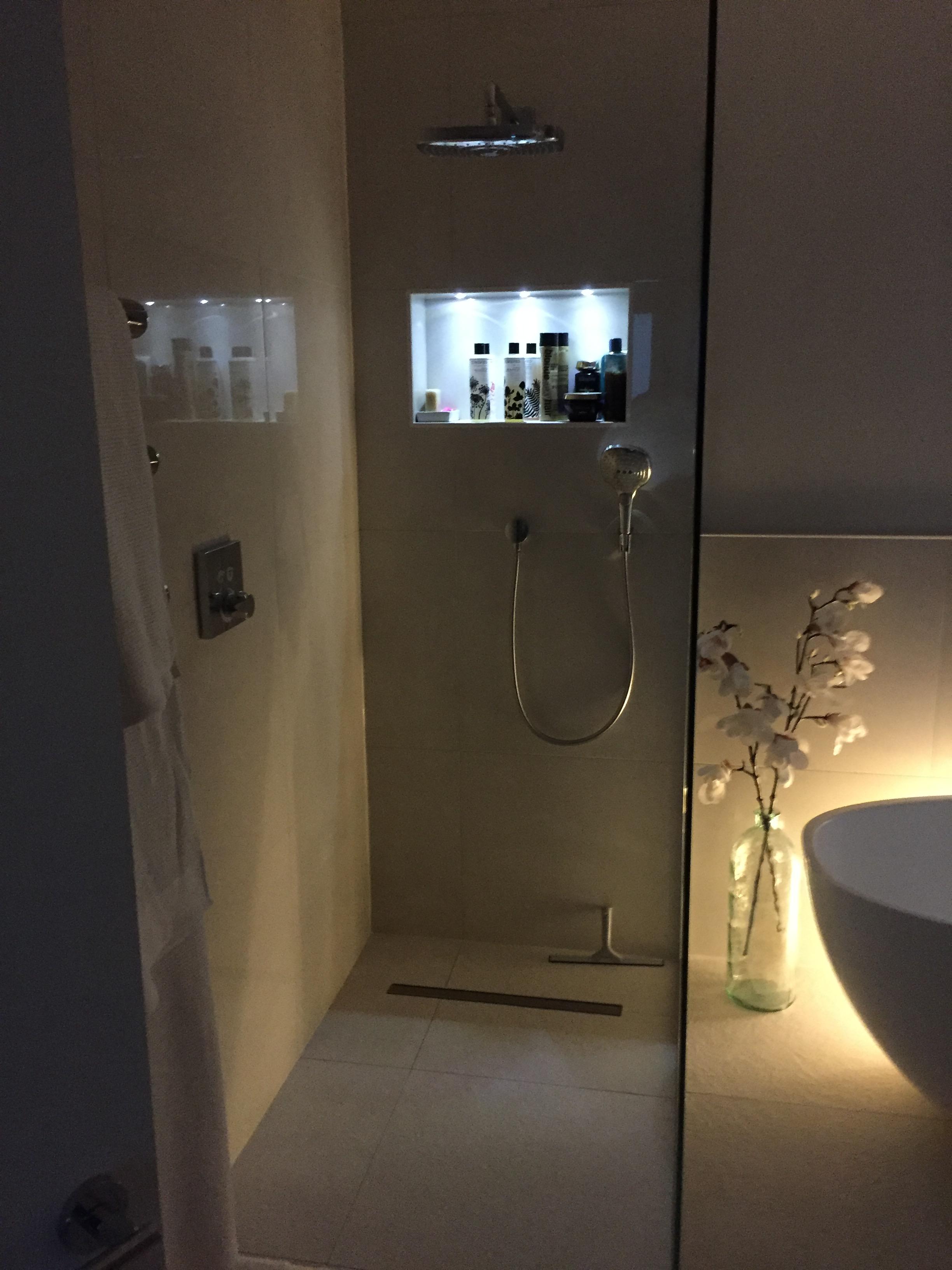

nod Posted May 28, 2018 Posted May 28, 2018 Like others on here Ive built in a small alcove in the showera My wife has decided she would like it lit I can easily fish a wire down and Conections to the downlights But I’ve looked online and can’t seem to find the lights we want Small as possible and waterproof

Onoff Posted June 10, 2018 Posted June 10, 2018 My cheapo deck lights: 30mm dia: https://www.screwfix.com/p/lap-apollo-led-deck-light-kit-polished-stainless-steel-blue-0-05w-10-pack/96379 Cheap as chips. They do some 15mm ones too.
Declan52 Posted June 10, 2018 Posted June 10, 2018 Decking lights where also the best option I could find.
Onoff Posted June 10, 2018 Posted June 10, 2018 Very thin stainless body so they sit really flush. I actually bought a second set for spares. Having them in 3 pockets, along the bottom of the bath and possibly in a ring around the rainfall shower head.

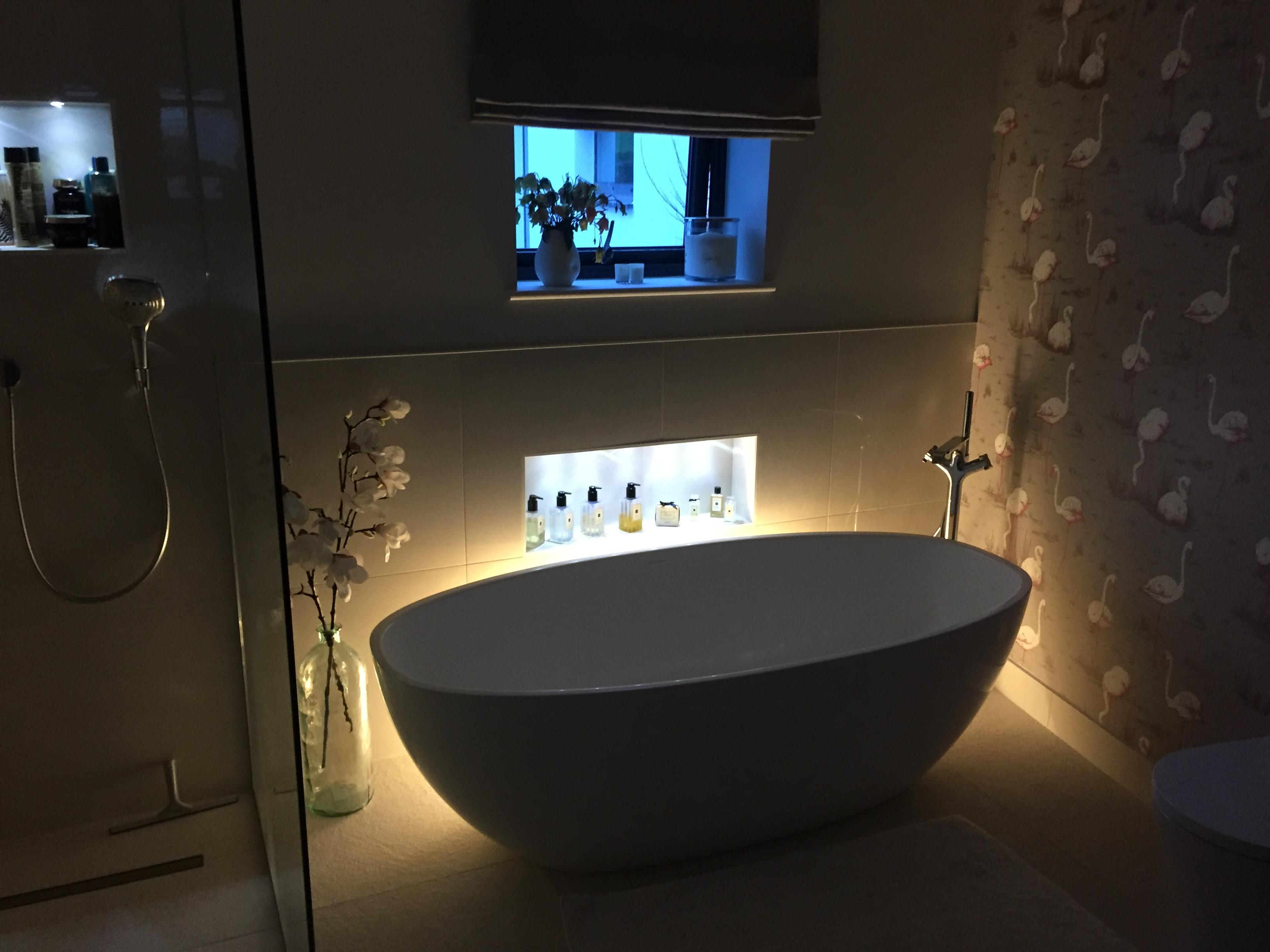

Nickfromwales Posted June 10, 2018 Posted June 10, 2018 Same ones I used for a few. Still going strong. Used the 15mm ones here but couldn't find them in warm white. And a single 10w warm IP65 behind the bath. All on their own switches so they could just backlight the bath when having a soak. The bath spot and the main spots dimmable, and the vanity mirror lights and pockets were on dimmers. 1
