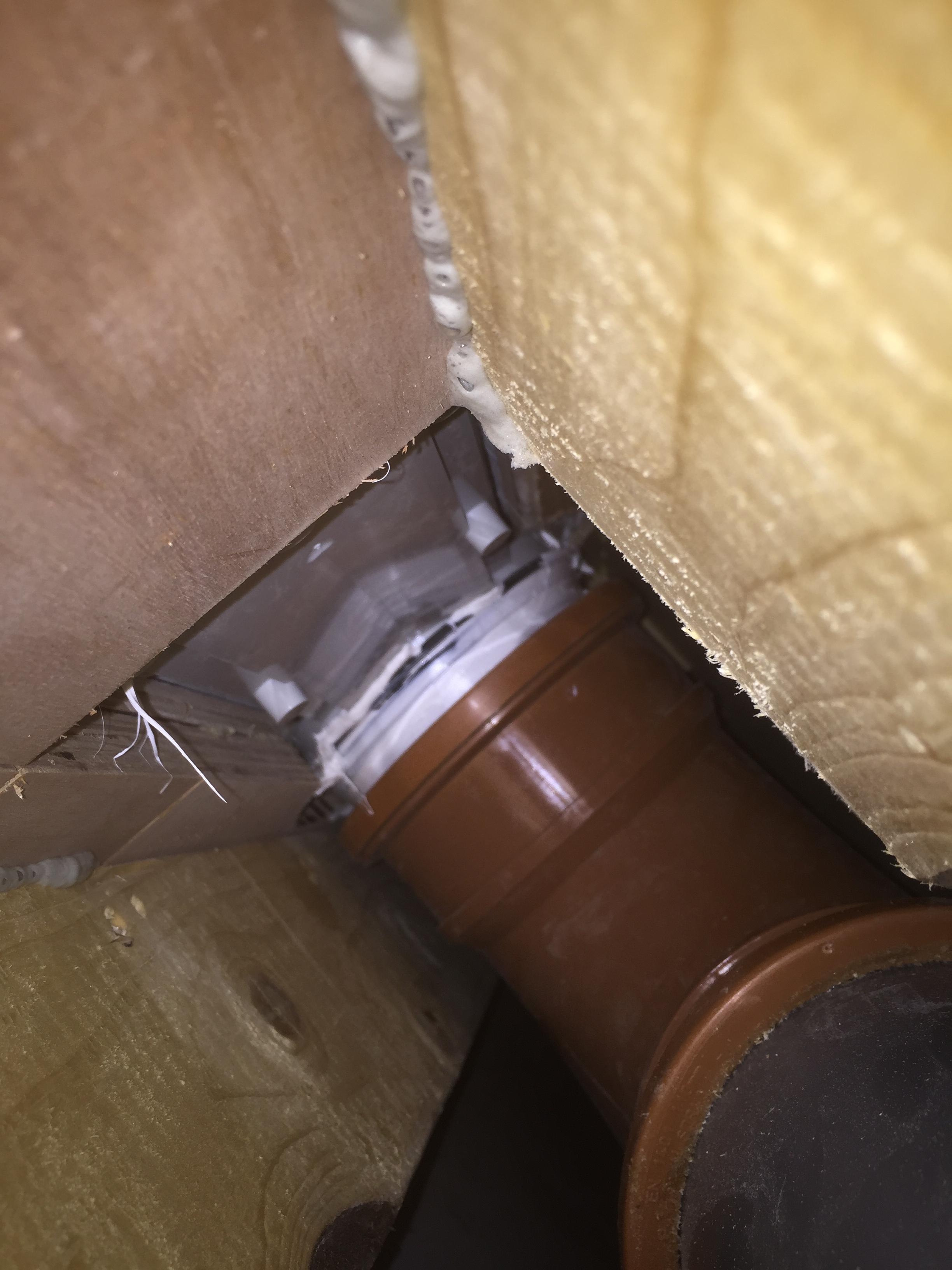

Nickfromwales Posted May 28, 2018 Posted May 28, 2018 3 hours ago, bassanclan said: Are there any other 2" waste/trap options around? If you look at that linked trap, it's ( I think ) the same as the Impey vertical wastes that go straight into a 110mm pipe. I'll post a pic in a mo.
Nickfromwales Posted May 28, 2018 Posted May 28, 2018 The 110mm trap body pushes into the soil pipe fitting which is as good as it gets.

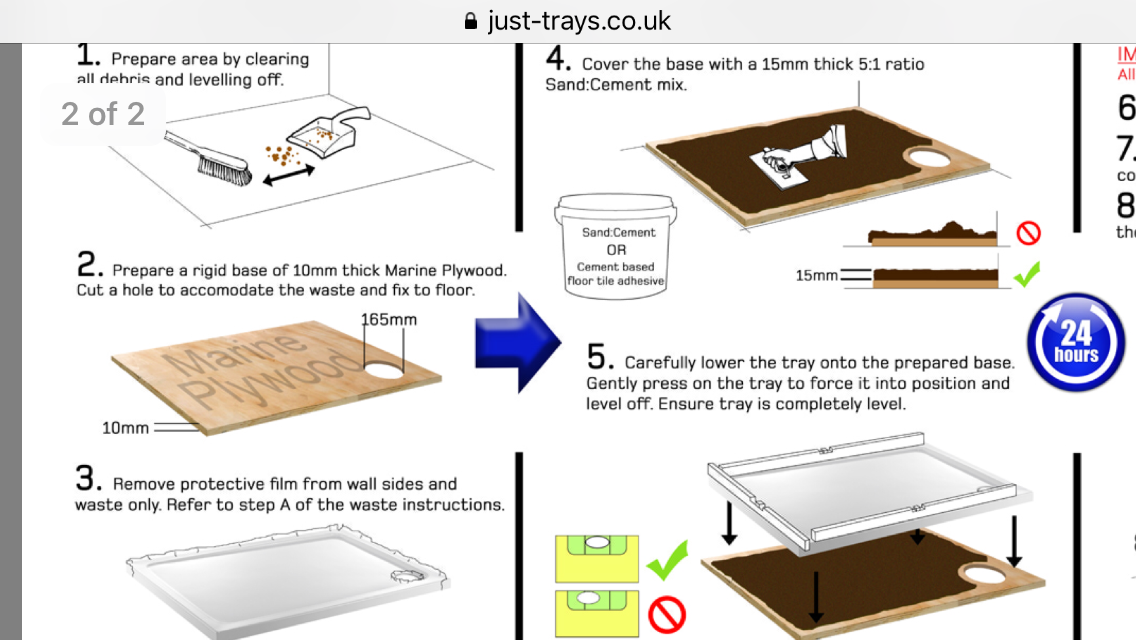

PeterW Posted June 5, 2018 Posted June 5, 2018 @bassanclan you need to cut a bigger hole for the waste and the manufacturer supplied waste will fit. It’s in the MIs for the tray - you need a 165mm hole for the waste to go through the floor. A 25mm stone resin tray will more than cope with someone standing on it with no support. This is from the MIs Using their info and the trap they provide you just need another 45 elbow to redirect the flow on the end of the supplied unit.
bassanclan Posted June 5, 2018 Author Posted June 5, 2018 Yes I think you are right, I need to make the hole in the plywood bigger and then a 45 degree out. The just trays waste is chrome plated plastic, so I will probably go for something like this https://www.bellabathrooms.co.uk/mcalpine-stw12-rb-1-x-80mm-seal-resealing-shower-trap-85mm-cp-brass-flange.html
