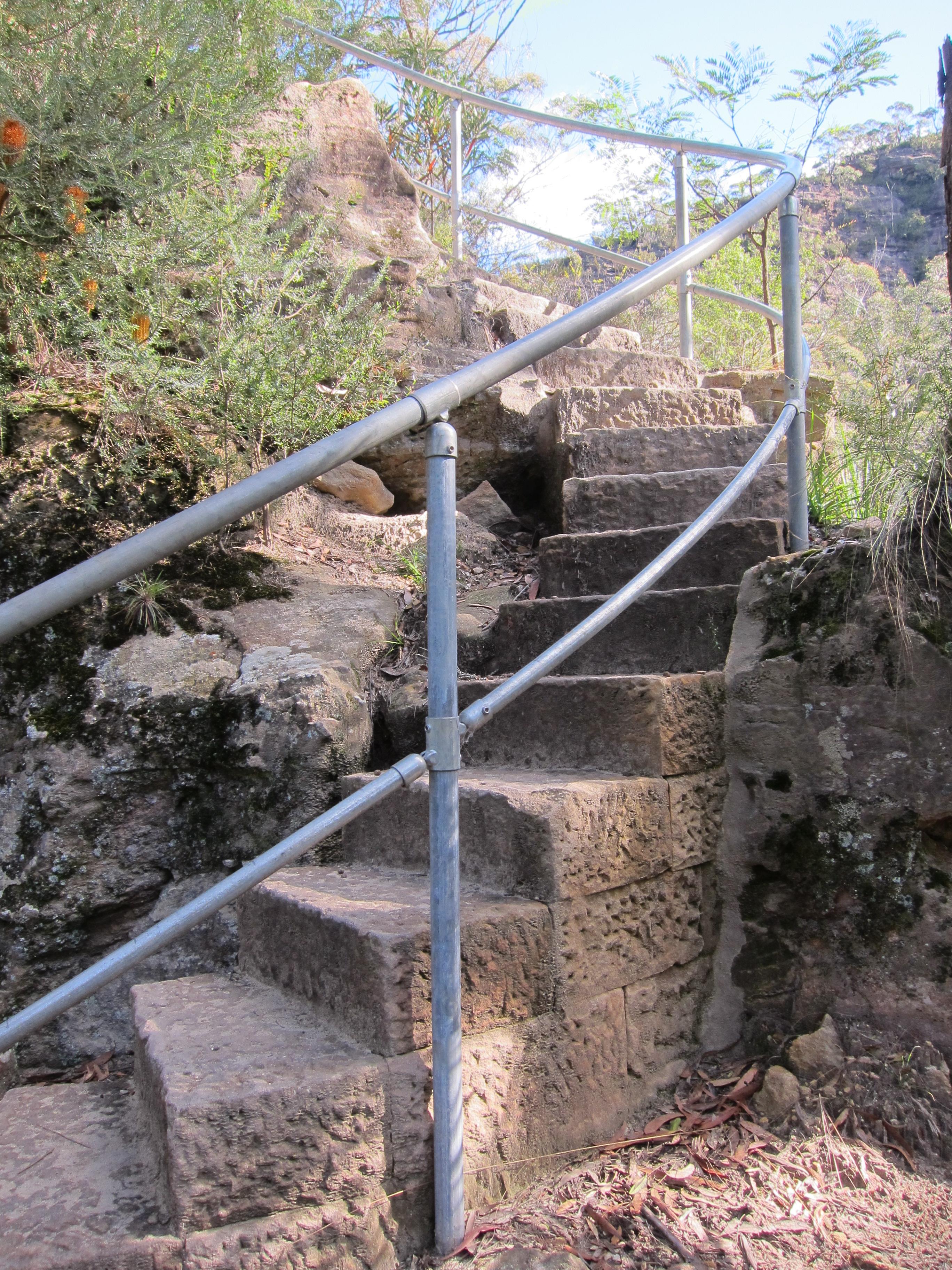

Cpd Posted May 23, 2018 Posted May 23, 2018 56 minutes ago, ProDave said: You need a good electrician to bend and thread galvanised conduit and get it looking sharp like that. Or you just buy a set of benders and learn, I did that in Australia and soon had many contracts as I really loved bending the pipe to match the track alignment. I was bending multiple sweeping bends and after a while it’s just fun, simple bends like in the house photo would be easily mastered if your that way inclined. 1
