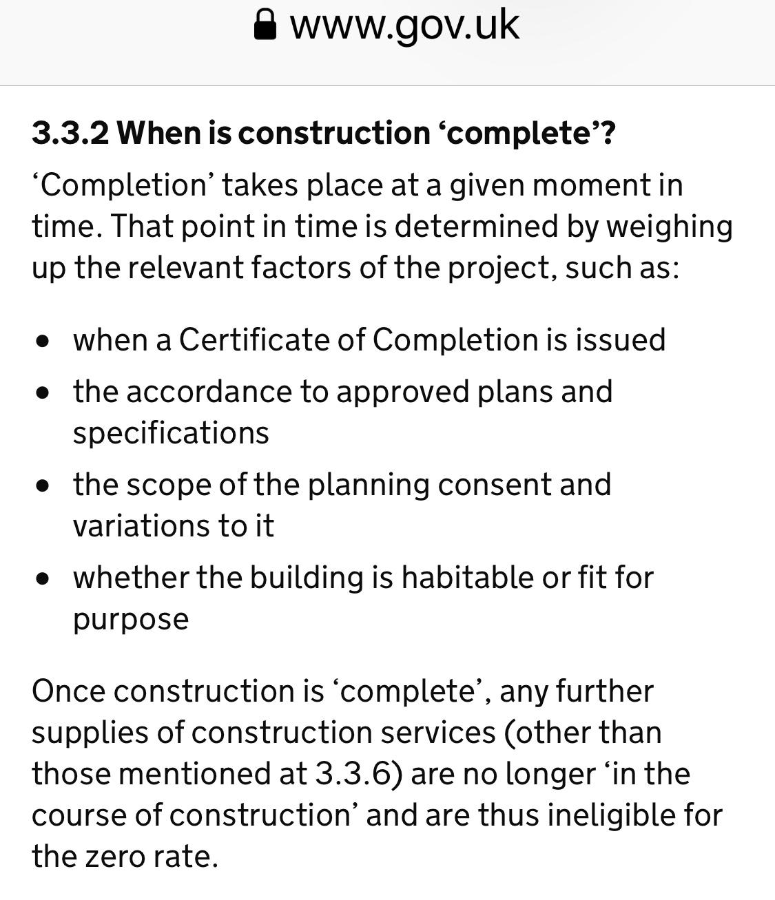

Gone West Posted September 6, 2018 Posted September 6, 2018 11 hours ago, newhome said: @PeterStarck did you get yours zero rated? No, because our demolition is taking place after we submitted out VAT refund. We had been living in the bungalow up to completion of the house. The VAT refund application is now at 13 weeks since submission
newhome Posted September 6, 2018 Posted September 6, 2018 34 minutes ago, PeterStarck said: No, because our demolition is taking place after we submitted out VAT refund. We had been living in the bungalow up to completion of the house. The VAT refund application is now at 13 weeks since submission That doesn’t matter. The VAT refund is not the point that you lose the ability to get zero rated supply and fit, it’s just where you lose the ability to reclaim VAT from HMRC on supply items. The stop point for VAT being zero rated is when the work is ‘complete’ and if demolition is part of the PP you should still be ok for zero rated jobs IMO. You could have got the refund once it was listed for council tax for example which doesn’t mean that the work is complete at that point. Here is what it says in VAT Notice 708. Obviously you can’t keep getting zero rated for years but you should be ok for the demolition if the PP states that the building must be removed. My reclaim took over 5 months ??
Gone West Posted September 6, 2018 Posted September 6, 2018 @newhome Apparently we weren't charged VAT for the asbestos removal. Wendy has looked after the accounting side of the build, she's better organised than me with paperwork. 23 minutes ago, newhome said: My reclaim took over 5 months ?? So potentially still quite a wait for us . 1
newhome Posted September 6, 2018 Posted September 6, 2018 Just now, PeterStarck said: @newhome Apparently we weren't charged VAT for the asbestos removal. Wendy has looked after the accounting side of the build, she's better organised than me with paperwork. So potentially still quite a wait for us . Ah that’s good news then. You might get it quicker than me. They queried something on the PP that delayed it for a couple of weeks or so. Mine was all paid out straightaway and it still took 5 months. If anything had been queried it would have taken even longer for those items. 1
