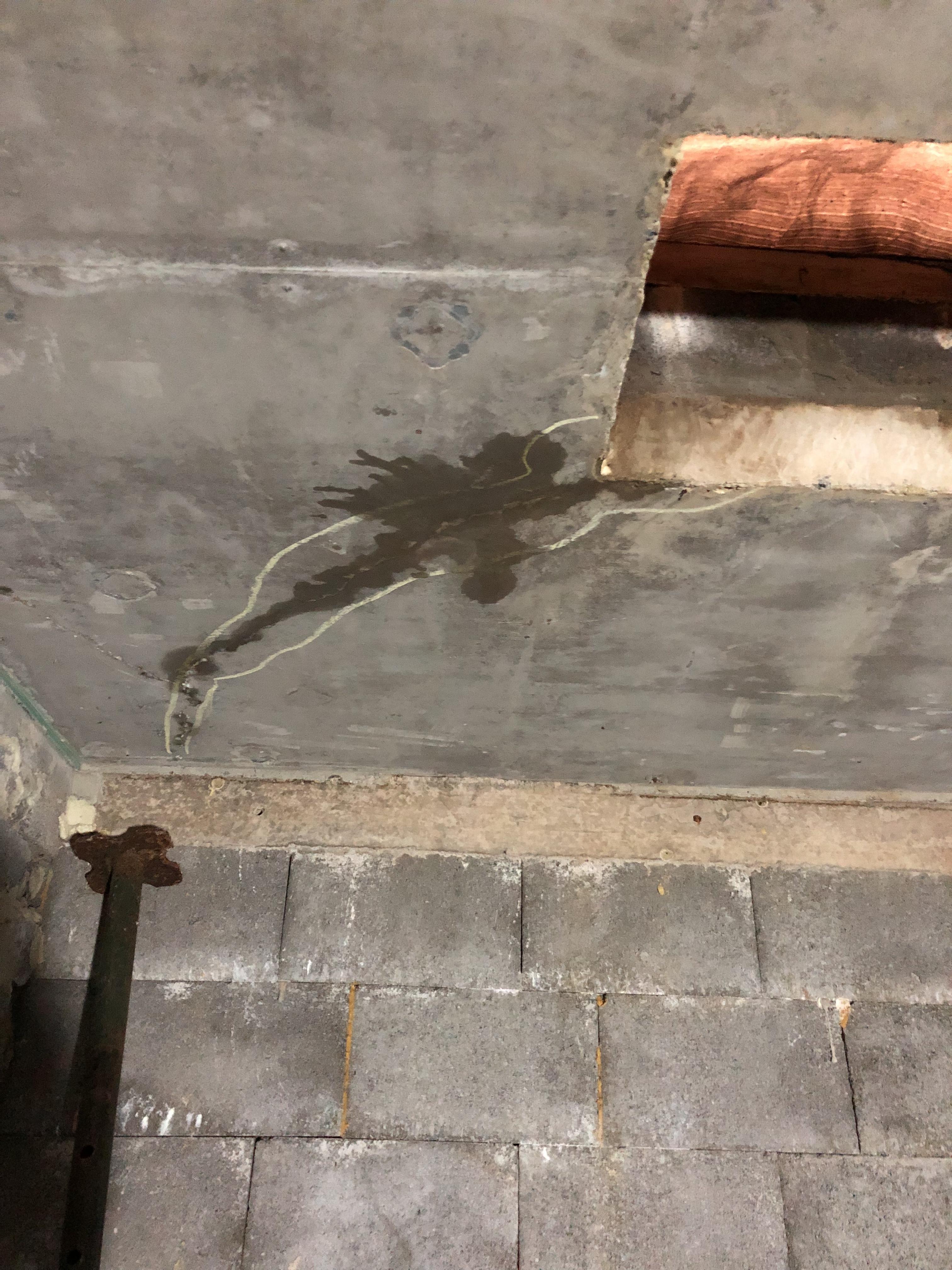

The outside of the wall goes onto a lane . I suppose there’s a possibility rain on the lane seeping through a gap in the stone work . Checked the wall with a screwdriver no obvious gaps . Tomorrow might hose that lane side of the wall and annoy neighbors

I know .
its probably half a cup full if that .
Its really upsetting me though because you feel like you’re failing everyday ?

When it rains the walls down below do get damp - I haven't installed the dimpled membrane and drainage channel around the perimeter yet.
So water is effectively in there.
Evaporates and hits the ceiling but also the plastic sheet over the walk on sky lights ( plastic sheet is wet on the inside! ).
Drips back to floor or tracks along any deviations in the concrete ceiling.
As water is never actually removed (until drain, MVHR etc. are in) the cycle just repeats
I've got the actual roofer guy coming to look tomorrow so I hope his logic backs this up!

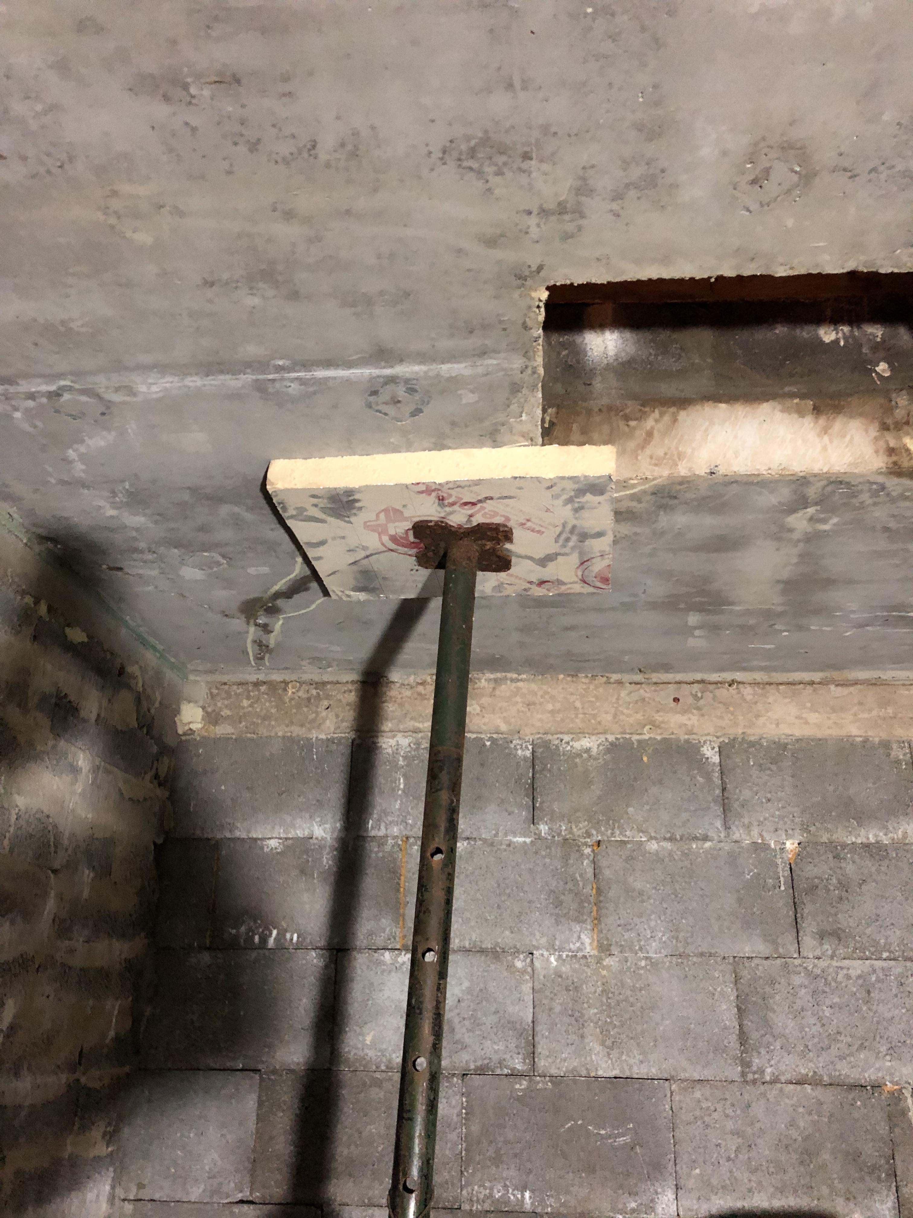

He also agreed my 'logic' of sticking a piece of PIR over a 'leak' was sensible. As *in theory* tomorrow there should be no track marks under it as the moisture hit the PIR and not the ceiling....
Posted
Before and after removal of PIR
Not a good test though I think
Roofer arriving soon
Think I might stick PIR in the upstand . Then if condensation will run down PIR and not track across ceiling

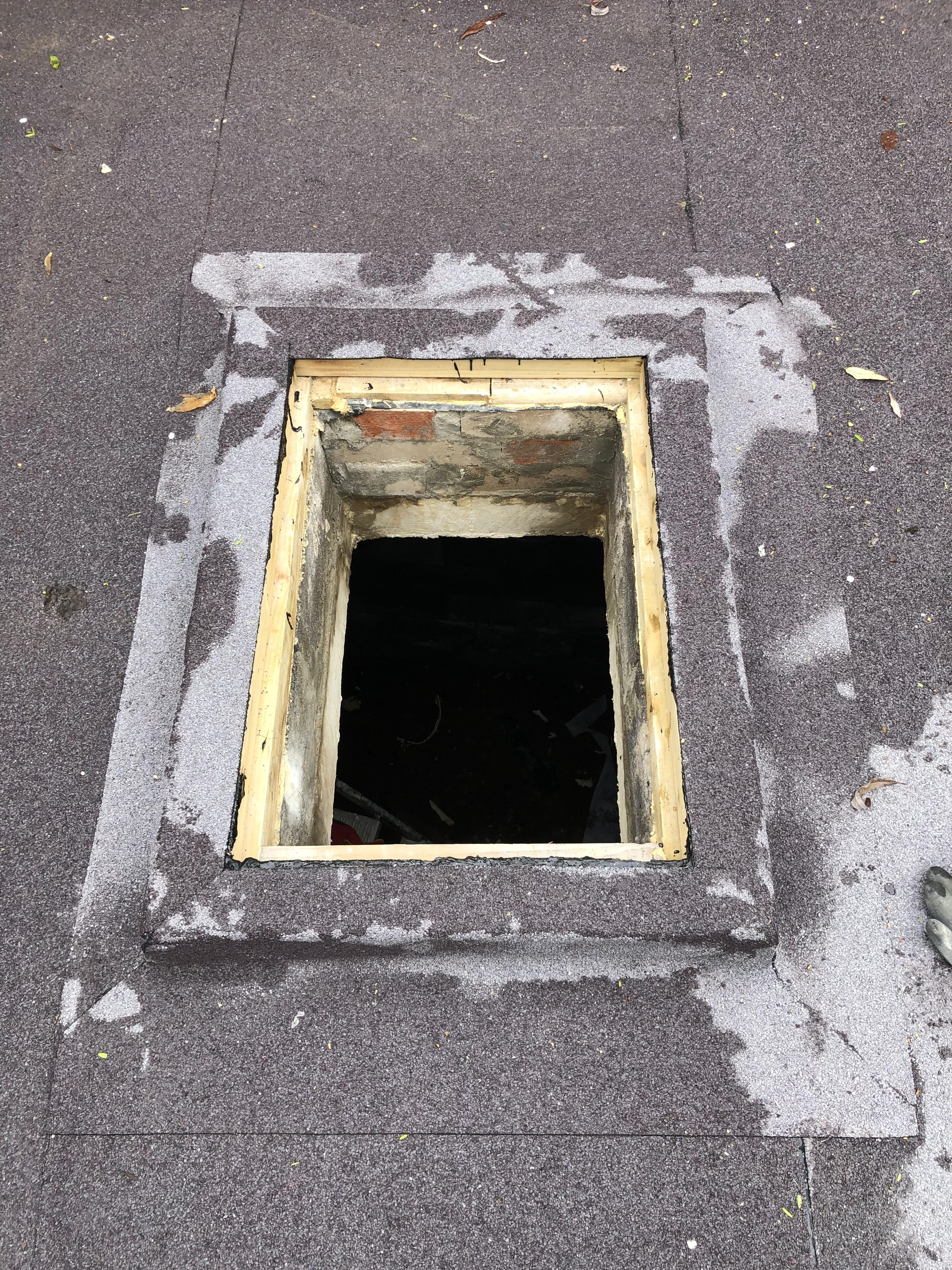

Took plastic sheet off hole .
You would expect the top of the stand ( where felt lips over timber ) to be dry .
Not though .
Does suggest condensation on the sheet dripping onto felt

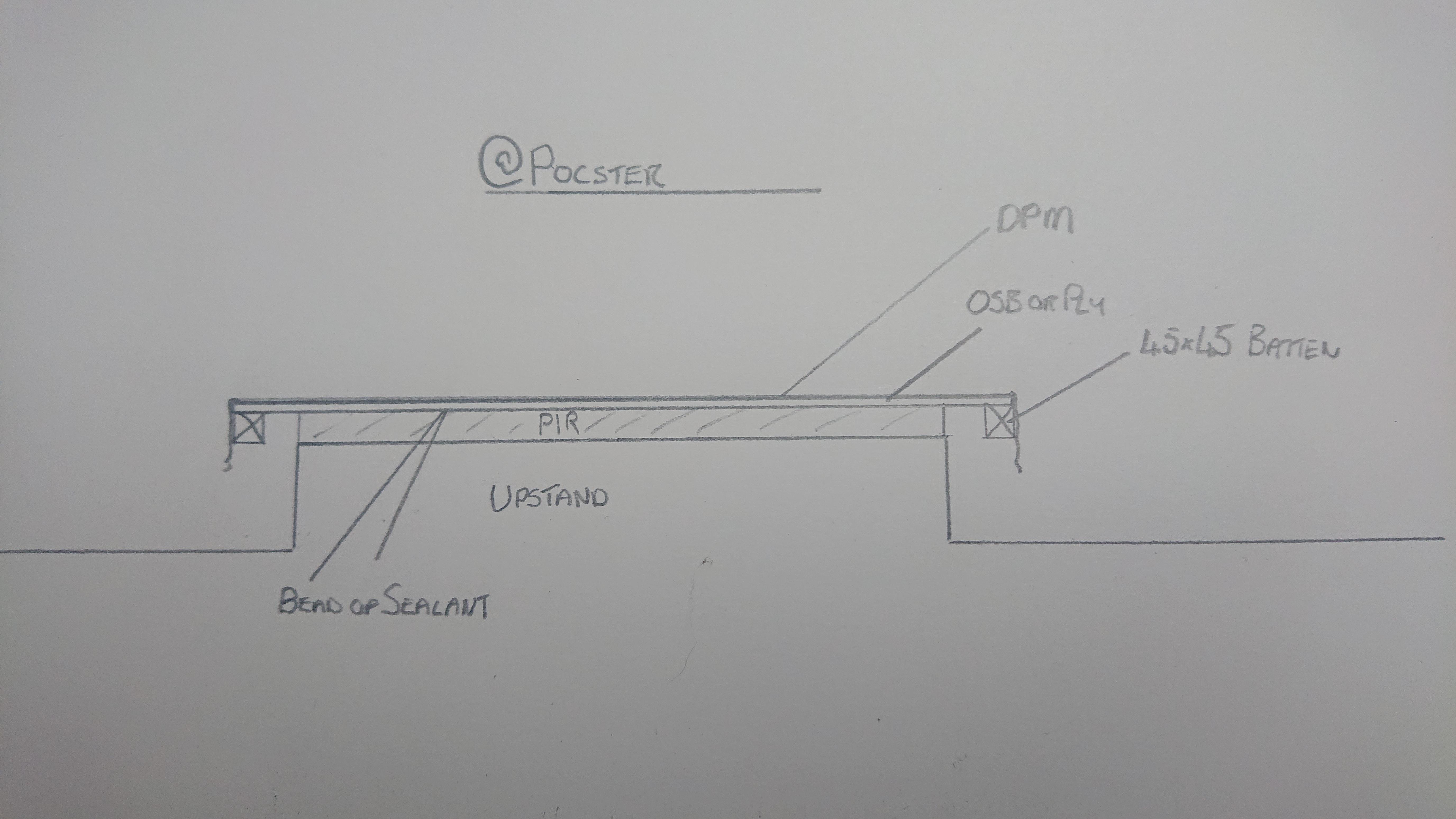

So, if we go with the condensation theory, which is valid , then you need to put a sheet over PIR over the light on the outside - completely covering it. Then put the DPM OVER that and lap down the sides to the ground outside.
You need to do two things here
1 - Stop ingress from outside. It's got to be done properly, hence why you need to make sure the light covering goes right over the edges and there is a clear lap downwards.
2 - Reduce condensation likelihood - in your case, the roofer if thinking it's condensing on the DPM and then tracking down - so you need the PIR over the whole of the opening. However, I would sound a note of caution - I have an underground garage made of concrete. I get terrible condensation on the ceiling(which isn't insulated yet) depending on what the weather does (it's fully enclosed inside). When condensation forms, it's uniform across the whole ceiling. In your case, if you can condensation you would see it everywhere across the ceiling. It would be seriously damp. However, you will sort that as thing progress, the PIR should hopefully stop condensation in that area to let you assess if it was gathering and running down the opening.

Sorry - just seem that latest pic - you do have insulation in the slab yes? In which case that explains why no condensation on ceiling elsewhere which is good. You def need to get the covering of the opening right as it might be making things worse. I'll draw up what I mean.
Posted
This is what I would do. Almost creating your skylight. This method will ensure no external ingress from the opening and minimise condensation formation.

Constructed a ‘cover’ as just suggest .
Just waiting for roofer to view before I install .

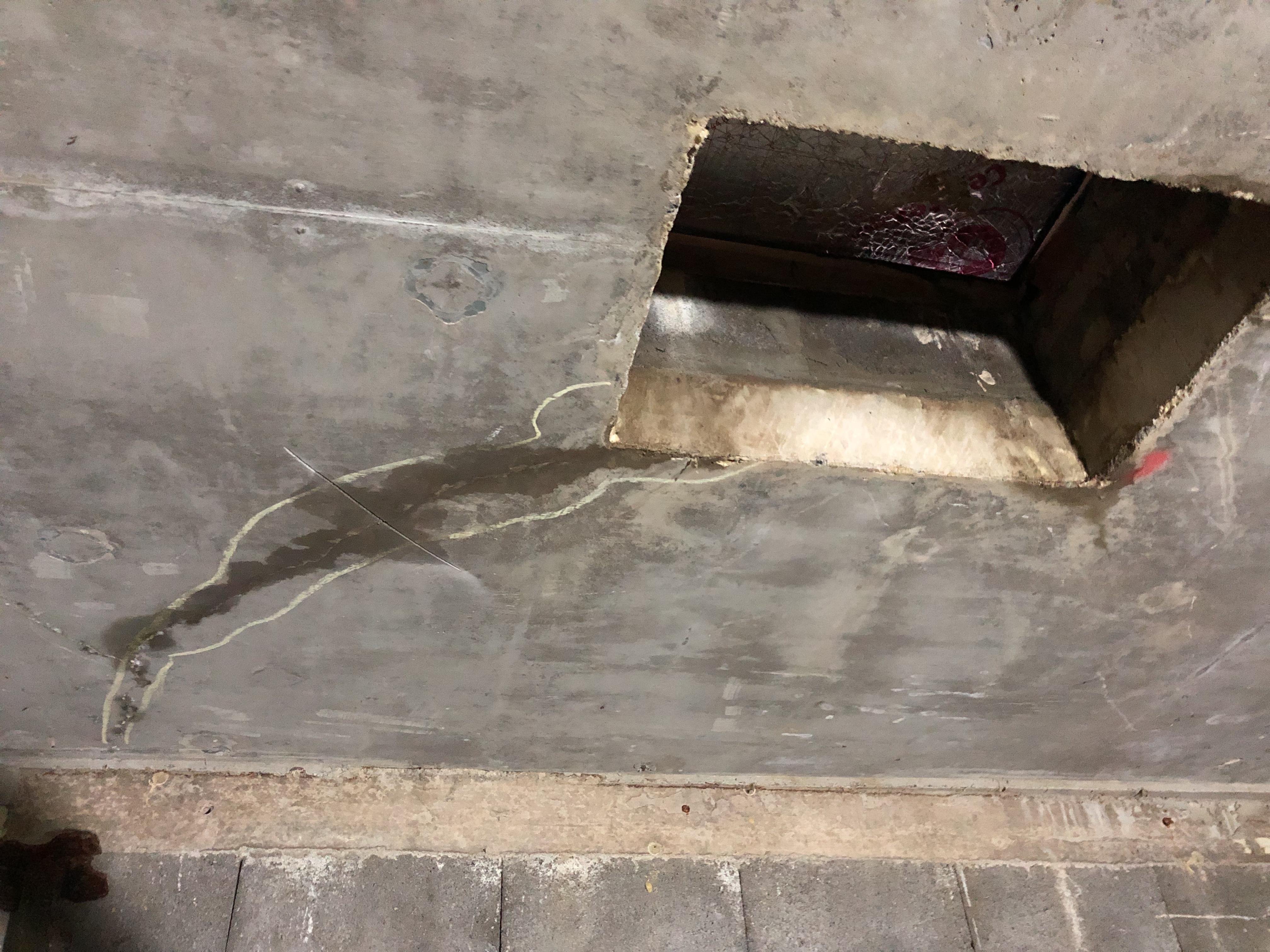

Today looks pretty much the same even with the new cover and angle grinder marks . Doesn’t seem as wet though .
Can see my breathe down here but ONLY in the front bit where those 2 skylights are that ‘leak’.

I think Monday I might angle grind those slots wider and deeper . If it appears on both sides I.e same as it is does that prove condensation??
Posted (edited)
Tempted to dry it out . Then at night leave my Mac there recording the ceiling .....
My gut instinct says it won’t run from corner to edge I.e track . It will appear in ‘patches’ . But that’s just my gut feeling ! ( which I guess suggests condensation)
Condensation or residual moisture being drawn out through the crack. It's interesting no change with the score. Does suggest moisture permeating through. Remember concrete will still be drying (it will for a long time) so maybe that's l this is? Might be no harm in leaving it for the time being and see if it dries up of its own accord? Its no flowing and rain fall doesnt seem to directly affect. You could probably do with a break from it now!
