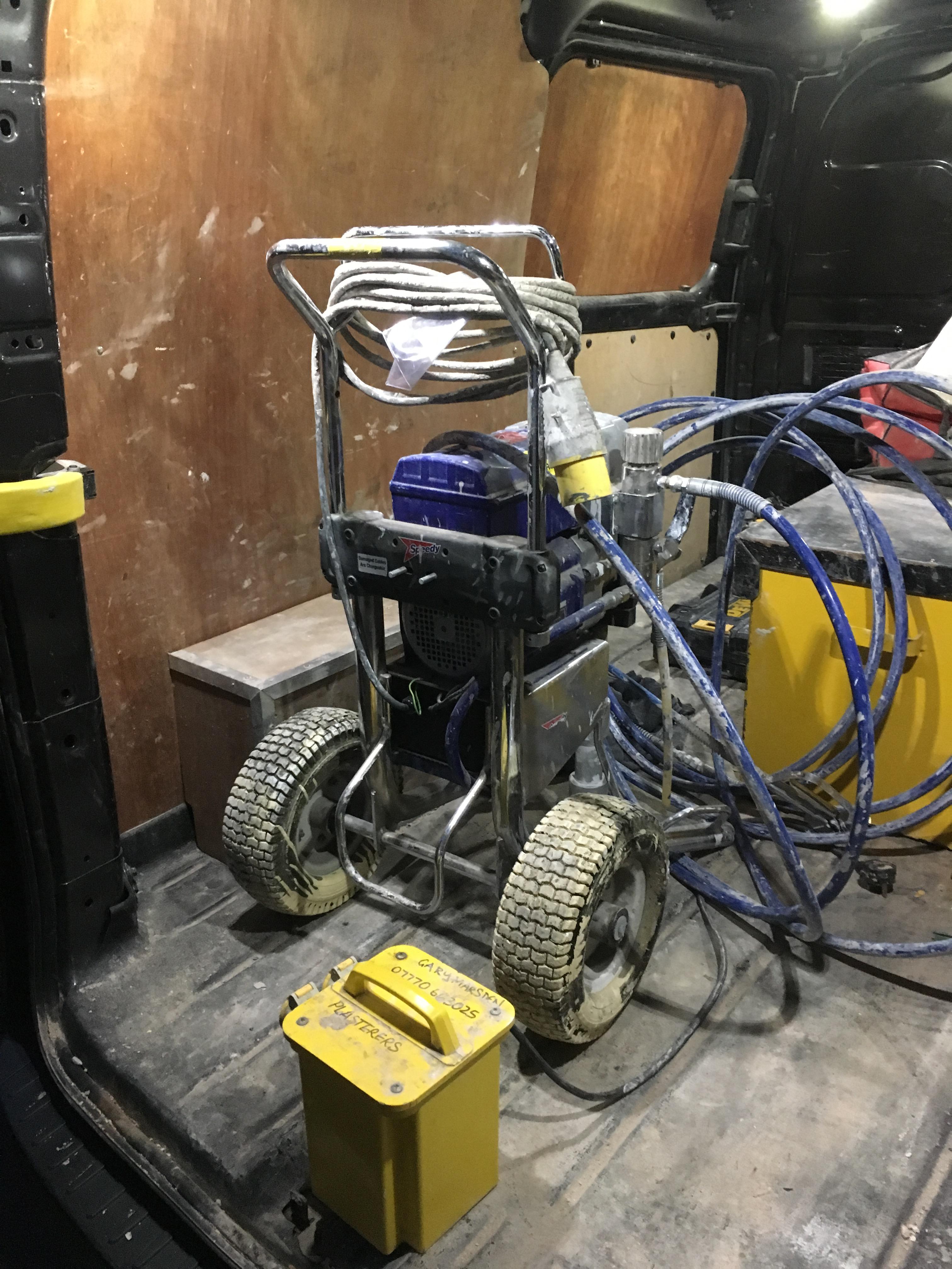

nod Posted May 4, 2018 Share Posted May 4, 2018 We hired a spray machine today £80 for the week Ehat a machine Five bedrooms sprayed to a lovely finish It took a bit of time priming the machine and getting used to it 5 Link to comment Share on other sites More sharing options...

nod Posted May 5, 2018 Author Share Posted May 5, 2018 1 hour ago, epsilonGreedy said: I feel the need for another rookie question. Does spray painting of a new build mandate the same colour for both the ceiling and walls? We are doing all ours white for now Most of the sites tend finish the ceilings in white and mist coat the walls in white Then go along afterwards with a roller for the walls Certainly quicker than a roller and a neater finish Link to comment Share on other sites More sharing options...
Nickfromwales Posted May 5, 2018 Share Posted May 5, 2018 2 hours ago, nod said: We are doing all ours white for now Most of the sites tend finish the ceilings in white and mist coat the walls in white Then go along afterwards with a roller for the walls Certainly quicker than a roller and a neater finish Yup. Mist costing with the sprayer for walls and final coats for ceilings is ultra quick but the overspray will get anywhere and everywhere without careful masking. Thanks to one company I had the worlds first magnolia Bosch jigsaw. 1 Link to comment Share on other sites More sharing options...
nod Posted May 5, 2018 Author Share Posted May 5, 2018 1 hour ago, Nickfromwales said: Yup. Mist costing with the sprayer for walls and final coats for ceilings is ultra quick but the overspray will get anywhere and everywhere without careful masking. Thanks to one company I had the worlds first magnolia Bosch jigsaw. Now you tell me ? Link to comment Share on other sites More sharing options...
Nickfromwales Posted May 5, 2018 Share Posted May 5, 2018 4 hours ago, nod said: Now you tell me ? Where would the fun be if I told you sooner ? ? Link to comment Share on other sites More sharing options...
nod Posted May 5, 2018 Author Share Posted May 5, 2018 10 minutes ago, Nickfromwales said: Where would the fun be if I told you sooner ? ? Your kidding Masked all the windows and floors still gets everywhere Link to comment Share on other sites More sharing options...
Nickfromwales Posted May 5, 2018 Share Posted May 5, 2018 Leave it an hour and wipe off. Stays wet on non pourous surfaces for hours. Link to comment Share on other sites More sharing options...
