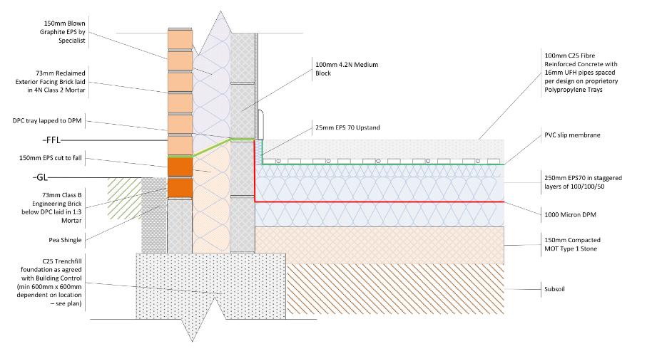

ultramods Posted April 30, 2018 Posted April 30, 2018 (edited) I was thinking about our slab insulation and UFH today. I noticed that our architect specified screed for the UFH. The slab make up is below. GROUND FLOOR: Ground floor to be constructed of 70mm self-levelling concrete screed incorporating underfloor heating system, on 150mm KOOLTHERM K3 Kingspan insulation, on 125mm thick structural C35 grade concrete slab, to be laid with A252 mesh reinforcement as per engineers details at 50mm bottom cover, poured in equal sections and placed onto 1200 gauge polythene damp proof membrane - DPM to be returned vertically up around edges and lapped with horizontal DPC through wall a minimum of 150mm above ground - on a minimum of 50mm sand blinding and well compacted 150mm layers of Type 1 well graded granular fill. 25mm perimeter insulation to be provided at all external edges of concrete slab. U-Value to be no more than 0.11W/m²K. The house will be Timberframe with block+render and granite cladding rain screen. From reading the various posts on the forum to achieve a better u-value and similar UFH operation for around the same cost of the current slab should I ask to architect to change the spec from 150mm PIR to 200mm PIR and use concrete instead of screed for the UFH pipes? Also would this spec also be OK for the garage as I would like to have the flexibility of the garage being a habitable space at a later date. The quotes we have received for the foundations/slab are: Foundations Excavate trenches for foundations, pour C20 concrete (no mesh) 11.00 m3 £185.00 £2,035.00 Backfill foundation with suitable material and 150mm of type 1 sub base compacted in layers (inc garage) 64.00 m3 £30.00 £1,920.00 50mm sand blinding, Radon DPM and 125mm of C35 to house sub floor. 1 layer A252 mesh 152.00 m2 £32.00 £4,864.00 150mm Celotex inc 25mm perimeter insulation 101.50 m2 £24.50 £2,486.75 65mm UFH screed 152.00 m2 £26.50 £4,028.00 150mm concrete to garage floor, I layer A252 mesh 37.00 m2 £26.00 £962.00 Backfill around the perimeter of the found to accommodate the scaffold 32.00 m3 £26.00 £832.00 Edited April 30, 2018 by ultramods

PeterW Posted April 30, 2018 Posted April 30, 2018 3 minutes ago, ultramods said: Ah, that's what i was proposing, isn't it? ? Not sure..? Thought you were suggesting concrete for the top rather than S&C. It it would be bottom up : 150mm MoT sand blinding DPM Insulation slip membrane 120-150mm concrete with rebar and ufh pipes
ultramods Posted April 30, 2018 Author Posted April 30, 2018 1 minute ago, PeterW said: Not sure..? Thought you were suggesting concrete for the top rather than S&C. It it would be bottom up : 150mm MoT sand blinding DPM Insulation slip membrane 120-150mm concrete with rebar and ufh pipes Yes i was proposing concrete instead of screed as it will be cheaper and dry faster and we will be tiling the floors.

PeterW Posted April 30, 2018 Posted April 30, 2018 34 minutes ago, ultramods said: @PeterW when you say ground bearing slab are you meaning having no strip foundations? I have attached the current plans for the foundations. 565-15 Foundation and sections.pdf Sorry - try this as way of explaination. This is one I did recently that gave insulated ground bearing slab and also a filled cavity below ground which helps for UFH losses. 1

Nickfromwales Posted April 30, 2018 Posted April 30, 2018 (edited) On 30/04/2018 at 15:27, ultramods said: if you are using 40mm concrete meshmen then the pipes on top of the mesh is 70mm deep enough, approx 14 mm of concrete on top of the pipes No, but you'd be having 120mm concrete not 70mm screed layer Im all for the proposed approach by others above, as in ditch the concrete subfloor and have the concrete as your top layer over insulation. The way its proposed in the OP is archaic and id rather have more insulation than concrete in my given floor construction ( and given depth ). Yes, do the insulation yourself, but the sand blinding layer need to be spot on flat as that'll leave voids under the insulation otherwise. Id recommend : MOT1 then whack that flat, then sand blind, then 25mm of EPS as a sacrificial layer to protect the DPM, then DPM, then insulation, then light gauge membrane, then 120mm reinforced concrete floor, ( including mesh and UFH pipes as required ), then your chosen floor covering including any surface prep required. Edited May 1, 2018 by Nickfromwales 1
