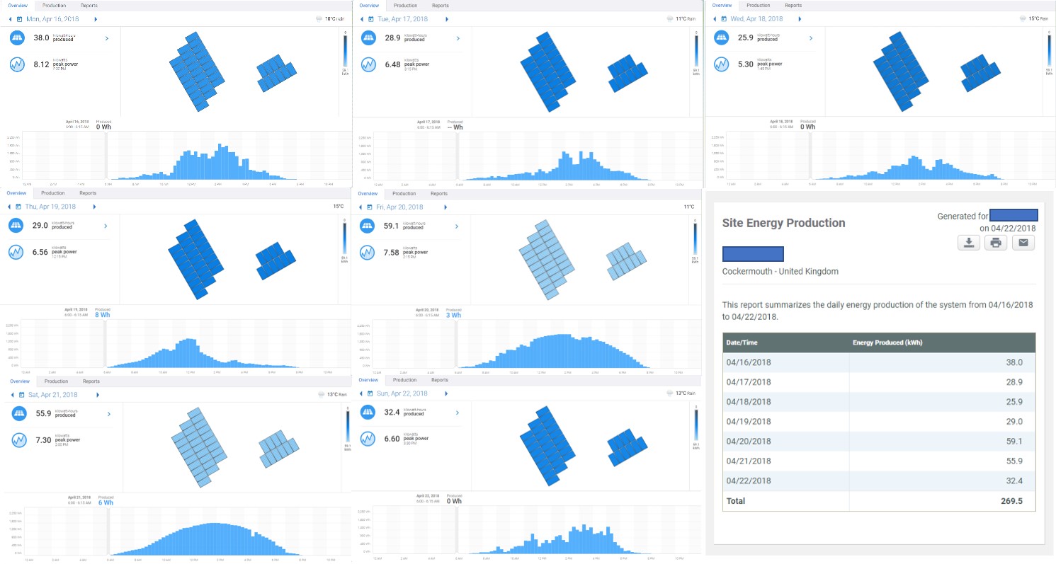

le-cerveau Posted April 23, 2018 Author Posted April 23, 2018 I am sure I will get bored with this but at the moment is is fun to see what I am generating, last week 269.5 kWh That is recorded by online, actually it is probably more as on Saturday there is an evident dropout of some of the panels reporting, on an otherwise clear day!
Dreadnaught Posted April 23, 2018 Posted April 23, 2018 2 minutes ago, le-cerveau said: That is recorded by online Nice graphs. Looks like Tetris! I assume the top part is a schematic of the 2x arrays. Do you have yours on an SE – SW orientation, with more SW? What online service is that?
Dreadnaught Posted April 23, 2018 Posted April 23, 2018 1 minute ago, Dreadnaught said: What online service is that? https://enlighten.enphaseenergy.com/ I think.
Dreadnaught Posted April 23, 2018 Posted April 23, 2018 3 minutes ago, Dreadnaught said: Do you have yours on an SE – SW orientation, with more SW? From the link in your first post. 2 Arrays… Tilt: 25.0°, Azimuth: 240°. The bigger one. Tilt: 25.0°, Azimuth: 150°. The smaller one. Should have read your first post more closely, haha!
le-cerveau Posted April 23, 2018 Author Posted April 23, 2018 27 minutes ago, Dreadnaught said: Do you have yours on an SE – SW orientation, with more SW? The arrays are the maximum that could be fitted on the roof, it is a space limitation. I was considering putting some on the NE roof, but this is a highly sub-optimal direction, it would give me more morning power (in teh summer) and with the low roof pitch 25o would get some sun however the numbers don't stack up; with Nov - Jan next to useless, Feb, Mar, Sep and Oct some power and Apr - Aug good but the rest of the array is also good then, so I have what I have. It still is quite a significant amount as shown by last weeks production and it is smoothed out by the split orientation. In theory it is over 10kW, but appears to top out at around 8kW but I get earlier and later power that a South facing array would.
le-cerveau Posted April 23, 2018 Author Posted April 23, 2018 47 minutes ago, Dreadnaught said: What online service is that? 45 minutes ago, Dreadnaught said: https://enlighten.enphaseenergy.com/ I think. Yes it is as they are enphase micro-inverters the service is provided, you can see all the enphase systems around the world, unless a user has specifically not published the data, I have the limited data available, link in original post.
