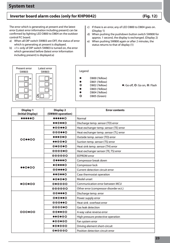

philiom Posted April 9, 2018 Share Posted April 9, 2018 We have a customer with 2 - 15kw Air Source Heat Pumps Model KHP0042, getting 9 flashes on pcb indicating flow switch issues, the only way it will restart is to turn of all power then it starts up for 5 - hrs and goes back to 9 flashes We had a similar fault about 30 months ago and we replaced the flow switches and it worked fine, tried new flow switches this time and it still has the same fault, when we had the fault the last time I could ring Kingspan technical for help, unfortunately they stopped supplying them and the tech help stopped, would appreciate any help or guidance. Link to comment Share on other sites More sharing options...

Jeremy Harris Posted April 9, 2018 Share Posted April 9, 2018 33 minutes ago, philiom said: Thanks for the info, really appreciate yours and Daves input. I have only been reading the flashes (9) on the red led on the board, I am a heating engineer so don't get too involved with the units themselves I usually get someone who knows how the internals work, I think its an external problem as the same fault is occurring on both units and I can't see two identical parts failing on two separate units at the same time. A word of caution if you want to gain access to the main boards - there are live mains terminals that can be very easily touched, even by the outer cover as it's being removed (ask me how I found this out!) so always best to isolate the power, then take the covers off, then power the units back up. The area around the diagnostic LEDs and DIP switches is pretty safe, as it's mainly low voltage DC stuff in that area, it's just the poor protection around the mains power connections that's a potential gotcha (pun intended....). Quite why Carrier didn't just fit insulating shields over the exposed terminals is beyond me, as they really are very easy to accidentally touch, and the unit has to be powered up with the cover off to access the diagnostic LEDs. Link to comment Share on other sites More sharing options...
philiom Posted April 9, 2018 Author Share Posted April 9, 2018 26 minutes ago, Onoff said: Numpty know nothing here.... If you've lost the anti freeze in the system as in liquid volume, could that in effect give rise to a LOW pressure fault, something the system doesn't detect as such? Hi, The system is not empty, its just got water in at the moment and its at 1.3 bar Link to comment Share on other sites More sharing options...
philiom Posted April 9, 2018 Author Share Posted April 9, 2018 21 minutes ago, JSHarris said: A word of caution if you want to gain access to the main boards - there are live mains terminals that can be very easily touched, even by the outer cover as it's being removed (ask me how I found this out!) so always best to isolate the power, then take the covers off, then power the units back up. The area around the diagnostic LEDs and DIP switches is pretty safe, as it's mainly low voltage DC stuff in that area, it's just the poor protection around the mains power connections that's a potential gotcha (pun intended....). Quite why Carrier didn't just fit insulating shields over the exposed terminals is beyond me, as they really are very easy to accidentally touch, and the unit has to be powered up with the cover off to access the diagnostic LEDs. I know I had the cover off a few times and know what you mean about the terminals!! Link to comment Share on other sites More sharing options...

Jeremy Harris Posted April 12, 2018 Share Posted April 12, 2018 It's certainly hard to think of something that could happen after five years to cause this. I reckon that going through the diagnostics using the Command Unit connected might be the best way to track down the sequence that's causing the flow error shutdown. One problem is that the final errors shown on the diagnostic LEDs may not be the actual cause, as one fault can lead to other error messages due to the knock on effects it creates. The big problem is that if it takes 5 hours of running before the thing throws an error and shutdown, you could be there for ages trying to track it down. The fact that it's affecting two units at the same time seems really odd, too, and makes me wonder whether it's something other than the heat pumps that's causing the fault. Equally odd is that when the error occurred 30 months ago you had to replace two flow switches to fix it, it seems a heck of a coincidence for two to fail together. Any chance of a system diagram to try and have a look at what might possibly be the root cause of this? Link to comment Share on other sites More sharing options...
