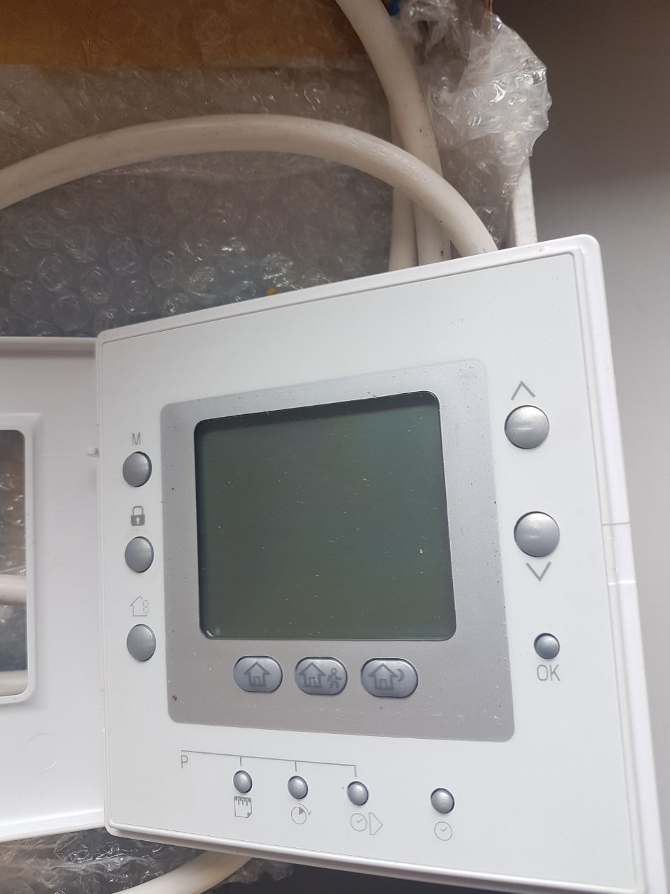

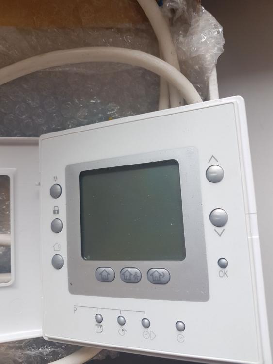

  8. To GS Harris, thanks for the prompt reply, As I said to Dave we are going to try a few things on the system, you mention the controller, I have attached a pic of the controller and will try it on the 2 units.

  10. We have a customer with 2 - 15kw Air Source Heat Pumps Model KHP0042, getting 9 flashes on pcb indicating flow switch issues, the only way it will restart is to turn of all power then it starts up for 5 - hrs and goes back to 9 flashes We had a similar fault about 30 months ago and we replaced the flow switches and it worked fine, tried new flow switches this time and it still has the same fault, when we had the fault the last time I could ring Kingspan technical for help, unfortunately they stopped supplying them and the tech help stopped, would appreciate any help or guidance.
