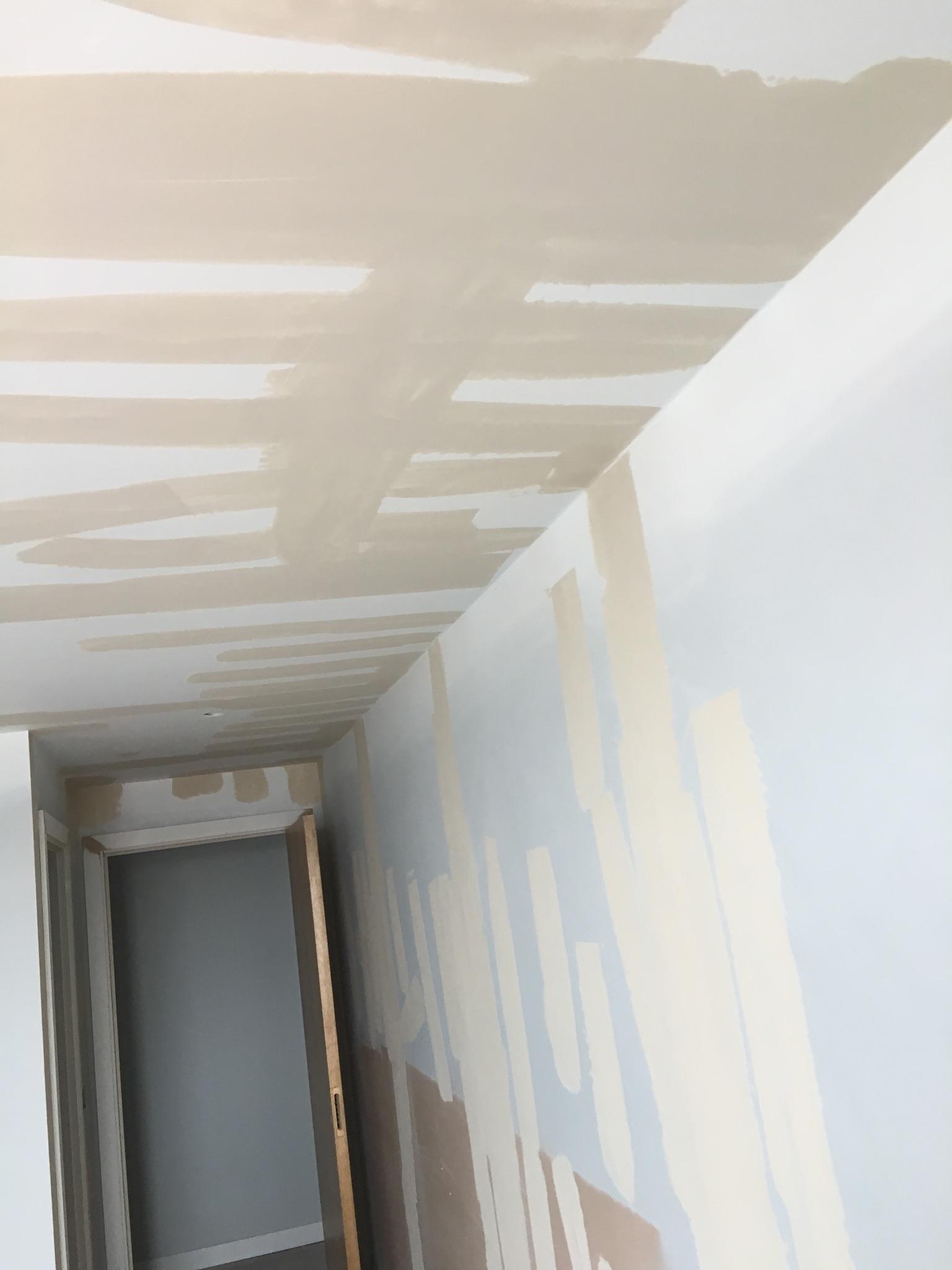

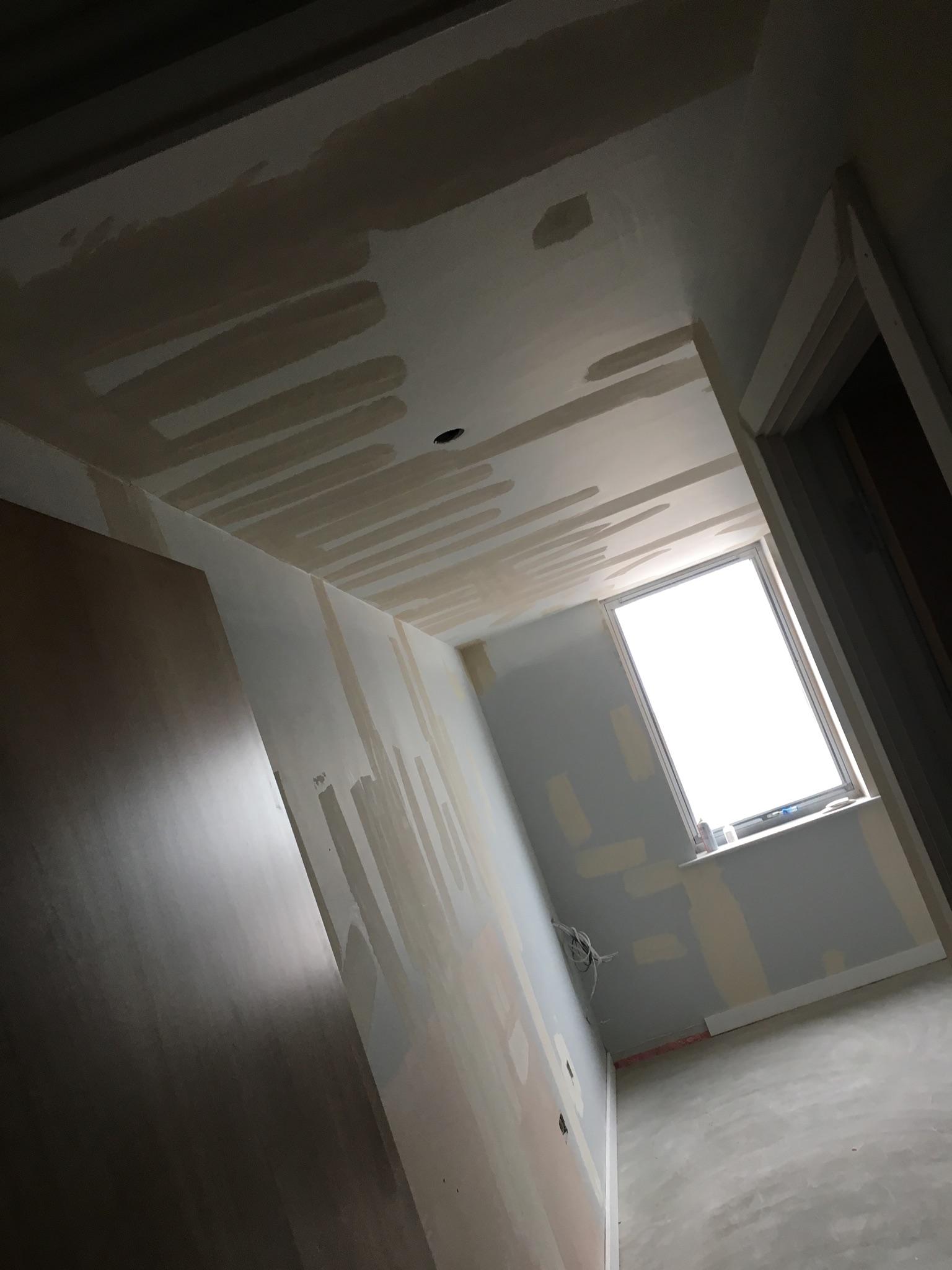

nod Posted September 10, 2020 Posted September 10, 2020 1 hour ago, Onoff said: Feeling pretty good about mine and my lad's plastering efforts in the bathroom now! How do they get it so thick in one place the level rocks like that? Was the wall boarding not flat to start with? I'll admit we did then make use of Easifill 20 and a Mirka sander: Whoever said spotlights hide everything isn't wrong! ? @nod, in the case of a badly plastered ceiling or wall that's been painted, do you have to take the paint off to redo? You can fill like the pictures While joint cement won’t stick to paint Easy fill will If the area has been sanded first 1

nod Posted September 10, 2020 Posted September 10, 2020 25 minutes ago, Steph188 said: It was all brick work so he has every opportunity to make sure his boarding was flat. Yes yours is much better! Glad to see lights do hide a bit as we can't afford to get them all redone. Thank you Many site plasterers put on thick coat on and go over it with these silly quick skim floats or shine with plastic The job pictured was a 60 bed hotel that we lost out to another company I had three tapers there for five weeks sorting it out It all needed redoing really 1 1
