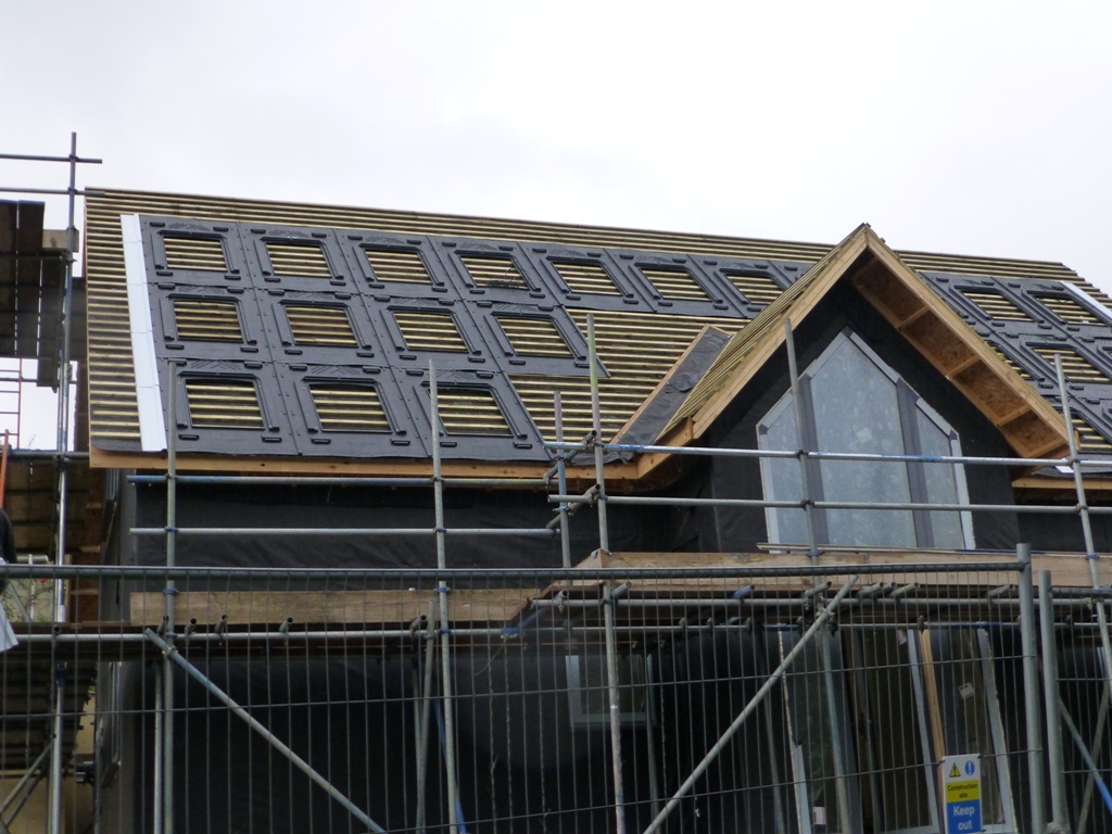

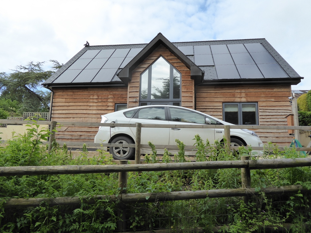

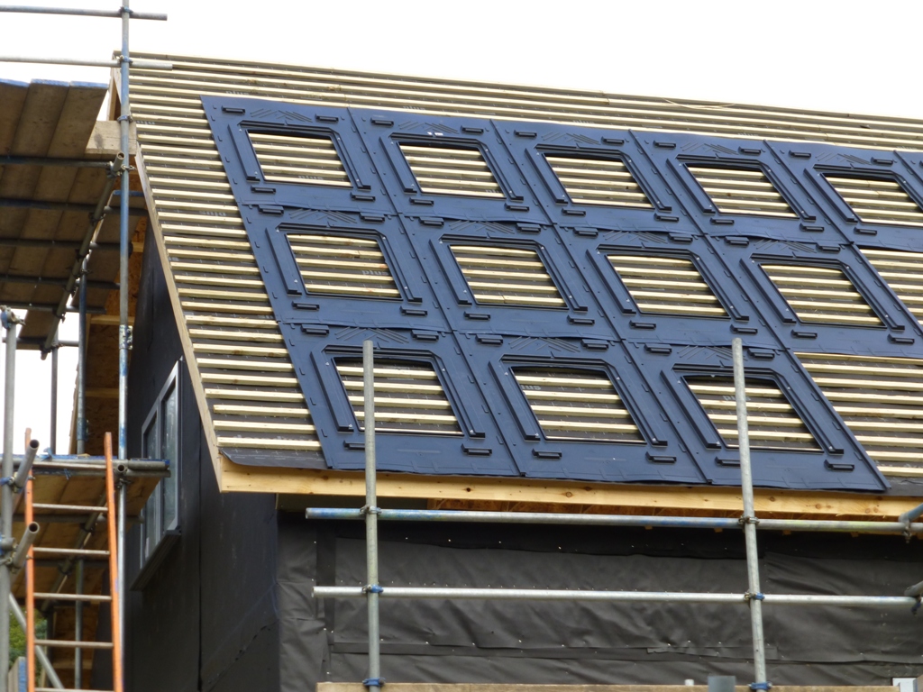

Jeremy Harris Posted April 4, 2018 Share Posted April 4, 2018 These entries show the in roof PV system: http://www.mayfly.eu/2013/11/part-twenty-two-roofing-and-mvhr-and-a-quick-video/ http://www.mayfly.eu/2014/01/part-twenty-six-the-scaffolding-comes-down-at-last/ And here are some photos of the in roof PV system being fitted and the completed front elevation, which looks on to a GII listed building and is inside an AONB and Conservation Area, so we had a fair few planning issues over putting PV on the roof: 1 Link to comment Share on other sites More sharing options...
Ferdinand Posted April 4, 2018 Share Posted April 4, 2018 30 minutes ago, Juj said: Just so that I'm getting this right, I can use a large array of solar panels in place of a roof covering (EDPM etc.) I've never actually seen a solar roof take up the entire roof, normally its bordered by normal roof tiles. I'll have to look through @JSHarris blog in more depth. it is not quite in place of. But you do not need the tiles or similar behind the area where the panels go. So you would have your waterproof Edpm membrane, with panels over, but tiles round the edge only. Here is J’s blog. It is worthwhile reading from end to end. http://www.mayfly.eu/ F Link to comment Share on other sites More sharing options...
