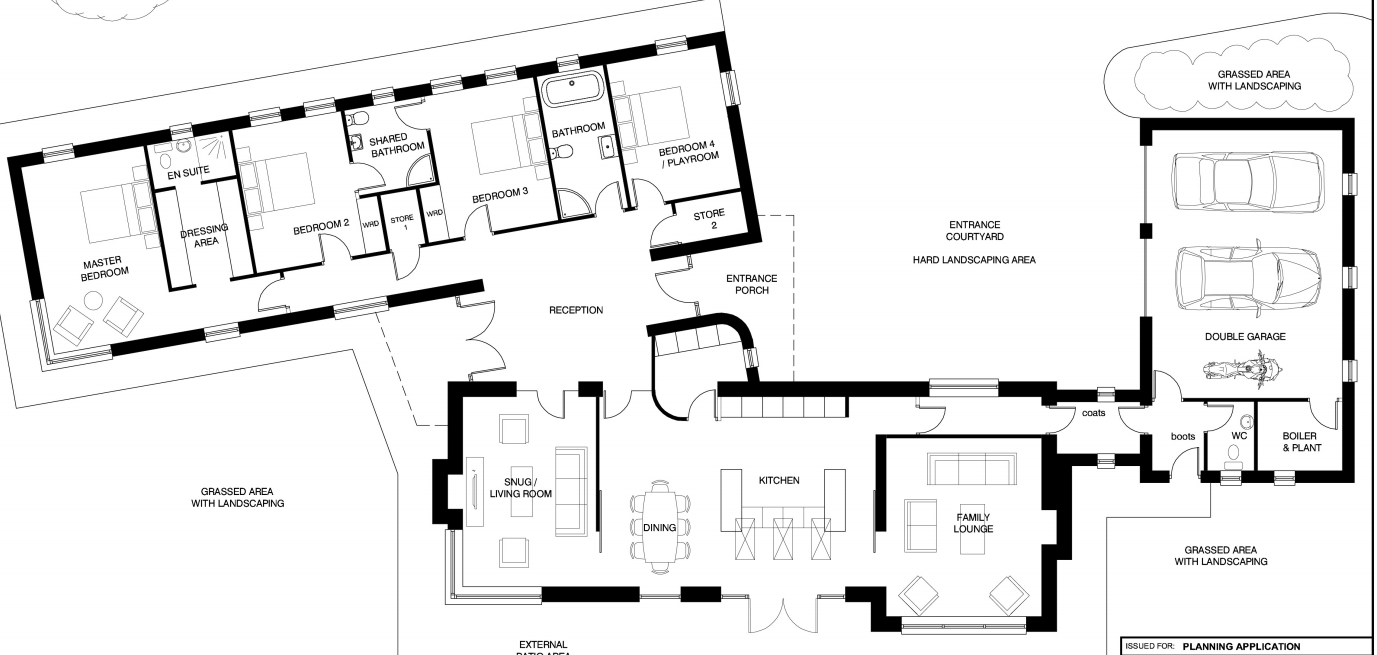

vfrdave Posted April 3, 2018 Share Posted April 3, 2018 I have been avoiding this post for a while and also been busy doing other things at the house. I need to sort out my heating design and it is proving difficult with varying opinions here in the land of the hotpress. I have a plumber who I am relatively happy with and comes highly recommended we just need to bottom out the design somewhat. Above is the floor plan and I have posted on this previously a long time ago, never thought it would take us this long to get to the point we are at. We are going to have UFH throughout along with towel rads in bathroom/en-suites, feature radiator in reception (I don't anticipate this putting much heat out) and provision for radiators in the garage. This will all be fed from an oil boiler (gas is not an option, ASHP I have ruled out and PV wont be happening). I understand that oil and UFH are not conducive for optimum performance but measures can be taken to alleviate this. The default position with almost all plumbers and heating designers here is to just feed the UFH via blending valve straight from the boiler, I hear @Nickfromwales scream what about short cycling on a boiler that cant modulate like a gas one (I have read plenty on here already). Some just don't get it is all I will say. Others agree to disagree. My options are as I see it:- Oil boiler with buffer and UVC. Question here is what size of buffer? It was suggested to me 500L but that was then going to also feed a UVC which I couldn't quite get my head around. Other option as I understand would be a 400/500L thermal store to do the lot. Any time I raise this in discussions no-one understands why I might do this if I have no wood burner etc dumping heat into it. Are there any other options? I dont really understand it all myself and my head has gone to mush with all the reading I have done. I fear my plumber may run for the hills if I dictate too much of the design to him. Please help! Link to comment Share on other sites More sharing options...

Nickfromwales Posted April 3, 2018 Share Posted April 3, 2018 If your plumber will work to a design then great. If they won't, and are adamant about firing ~26kw or more heat directly into a manifold that can only consume about a quarter of that ( IF the house was being heated from cold, because after it's up to temp it's probably less again ) then you have to make a choice. It's your house and your paying the bill for the oil, plus your going to pay extra maintenance if the boiler can't fire for reasonably long burns eg run 'clean' and needs heavier cleaning of the baffles more frequently. You don't need to justify having a TS, and you certainly don't need a solid fuel burner to justify it being fitted either. Stick to your guns and ask your plumber for a meeting. Sit him down and explain why you've decided to fit one. If he runs for the hills then he's not much of a professional. ( When asked to fit 600x600 black and white porcelain tiles in a bedroom I didn't say "no way, they're not to my liking" because it wasn't my house. . Instead I fitted them to the best of my ability and the customer was over the moon with them. That's why we get called "professionals" isn't it ? A lot of plumbers still think an oil boiler can modulate just because it condenses You will need a hot return if your plumber will do the usual knee-jerk '28mm-22mm-15mm' series plumbing, or you'll have washed your hands in cold water and dried them before getting hot water out of the furthest away basins, especially the cloak. A TS will best suit your DHW needs IMO, as long as you set it up PROPERLY eg correctly specified controls, again not something to expect from joe public plumber. If you have a very good cold mains you'll be able to have pretty much constant, instant DHW at very high flow rates, with the ability to run at least 2 good showers at the same time. Not having PV is a bad idea IMO, and I'd at least run cables for it now, which is cheap as chips, if it's down to lack of immediate budget rather than purely deciding against. Link to comment Share on other sites More sharing options...

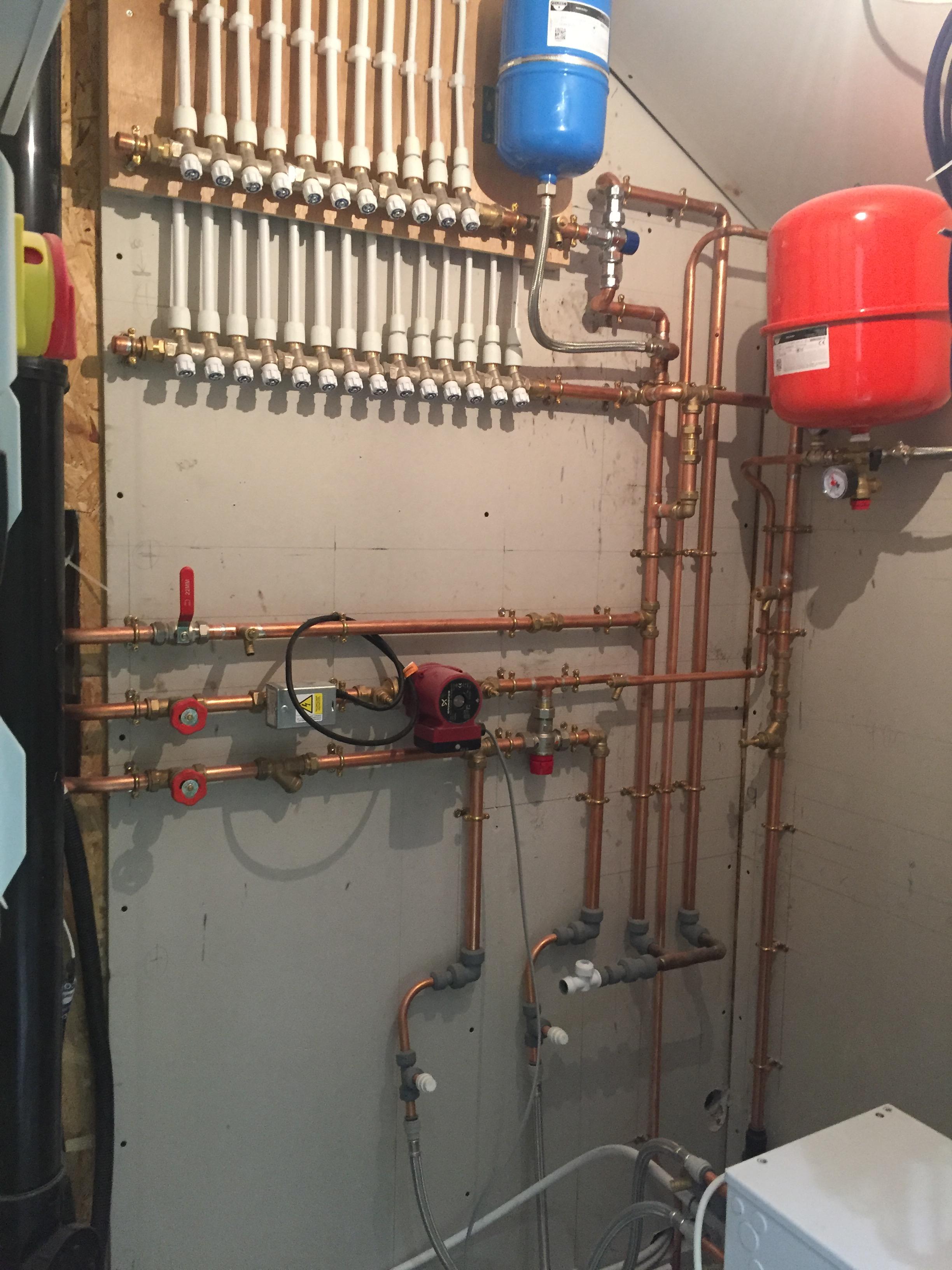

Nickfromwales Posted April 6, 2018 Share Posted April 6, 2018 3 hours ago, vfrdave said: The hot return scenario, if using manifolds for hot water distribution does this help with this scenario? Not entirely. On this one there will still be a hot return pump ( yet to be fitted in the pipe directly above that pump ) which only returns from the furthest hot outlet, the kitchen sink. For this installation I set it up so that the hot to the kitchen sink is the furthest manifold outlet away from the manifold supply inlet, so the hot return travels through all the large bore hot pipework from the water heater ( Sunamp ) and all the way through the hot manifold, and in doing so it pre-heats the whole manifold, thus killing off the dead leg that would otherwise exist. Manifolds, unless directly off the hot water device, still cause an issue because they need large bore runs tobthwm before they reduce accordingly, but they do reduce losses vs traditional series plumbed installations, so each case has to be designed specifically and will be unique. Link to comment Share on other sites More sharing options...
Alexphd1 Posted April 6, 2018 Share Posted April 6, 2018 @Nickfromwales very tidy install! Where did you get the hot/cold manifold from? Link to comment Share on other sites More sharing options...
