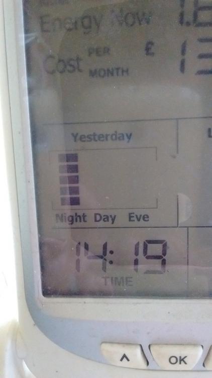

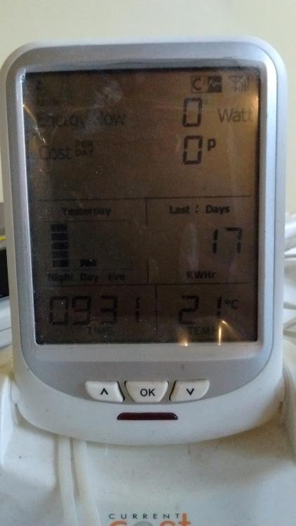

Just for interest, I hooked up my Hopi meter to the unit to measure what it draws electrically.
https://drive.google.com/open?id=1znDd-Y-wLfy_-p1K1BbInqM5qj6620LL
0.76amp - 160w - power factor 0.88.
Enjoy.
