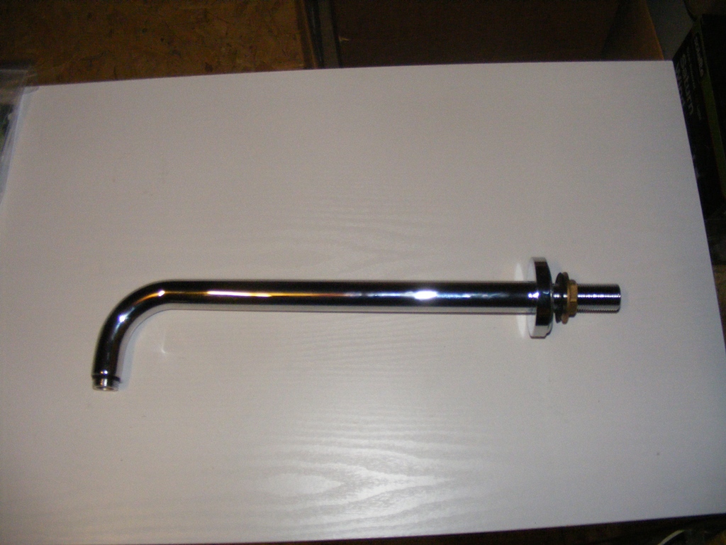

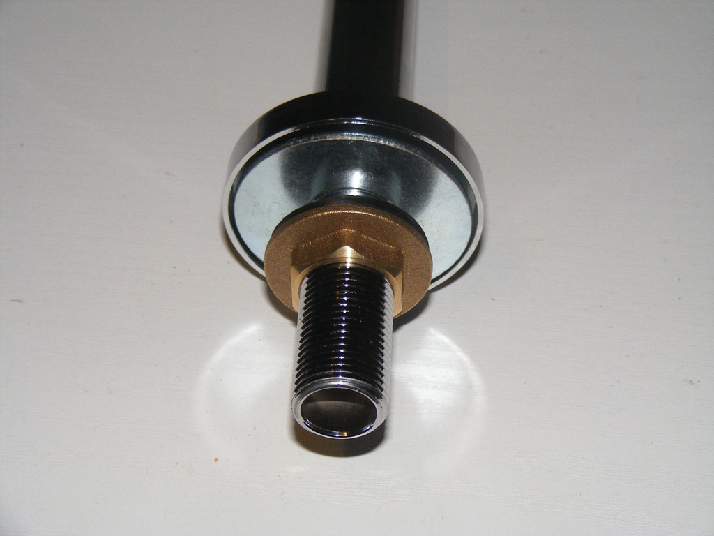

ProDave Posted March 19, 2018 Share Posted March 19, 2018 Plumbing my shower in the wet room at the moment. This is the arm onto which the rainfall head will screw onto. It looks like you should bolt it through the wall panel (wet wall in this case) and then make the plumbing connection. It is a parallel thread and a 1/2" tap connector fits onto it perfectly. However, here is the problem. Where it is going, I do not have rear access to the wall (already boarded skimmed and painted) So what I need is something I can screw (on a suitable cross member) inside the wall frame, connect my 15mm copper pipe to, fit the wall panel, then screw this arm into it. As it's a parallel thread and any fitting I am aware of almost certainly won't have a sealing washer, then it will rely on ptfe tape or similar to seal things. It's only the outlet from the thermal mixer to a rainfall shower head so pressure will be minimal ans none at all when it's off. So what fitting? Link to comment Share on other sites More sharing options...

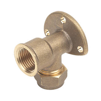

Onoff Posted March 19, 2018 Share Posted March 19, 2018 I'm guessing this: Or See @Nickfromwales post of Jan 14th: Link to comment Share on other sites More sharing options...

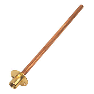

Tennentslager Posted March 19, 2018 Share Posted March 19, 2018 Link to comment Share on other sites More sharing options...
ProDave Posted March 19, 2018 Author Share Posted March 19, 2018 11 minutes ago, Onoff said: 'm guessing this: I thought about that, but aren't those tapered threads? (they always seem to be when screwing an outside tap into one) Link to comment Share on other sites More sharing options...
Nickfromwales Posted March 19, 2018 Share Posted March 19, 2018 Thats what I always use, and im pretty sure that ive never seen a tapered one. I often turn the shower arm thread all the way into this to start the first fix plumbing, and they spin in finger tight without any force, not how it would be with a tapered fitting Use an end feed one instead of compression and your bombproof. 1 Link to comment Share on other sites More sharing options...

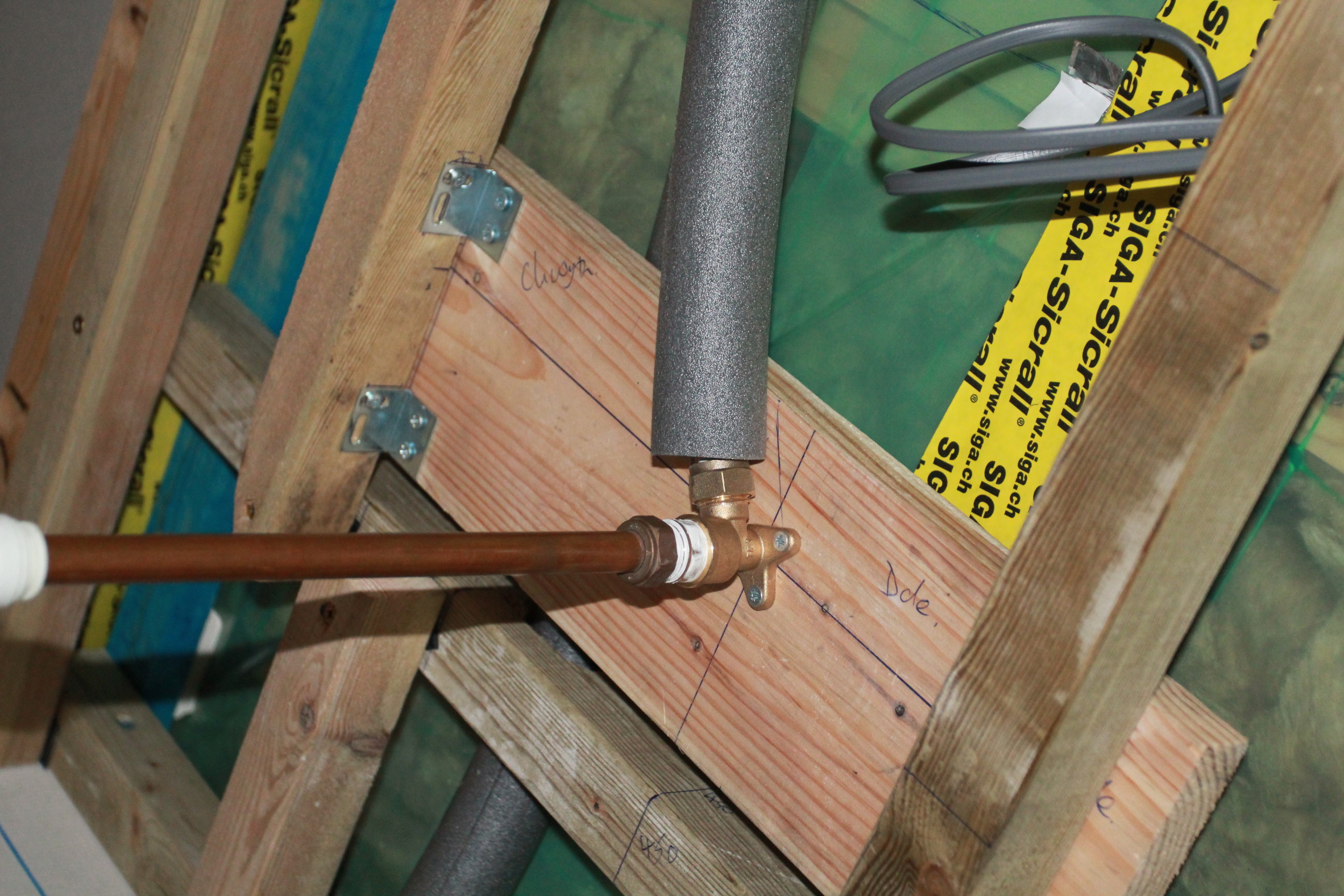

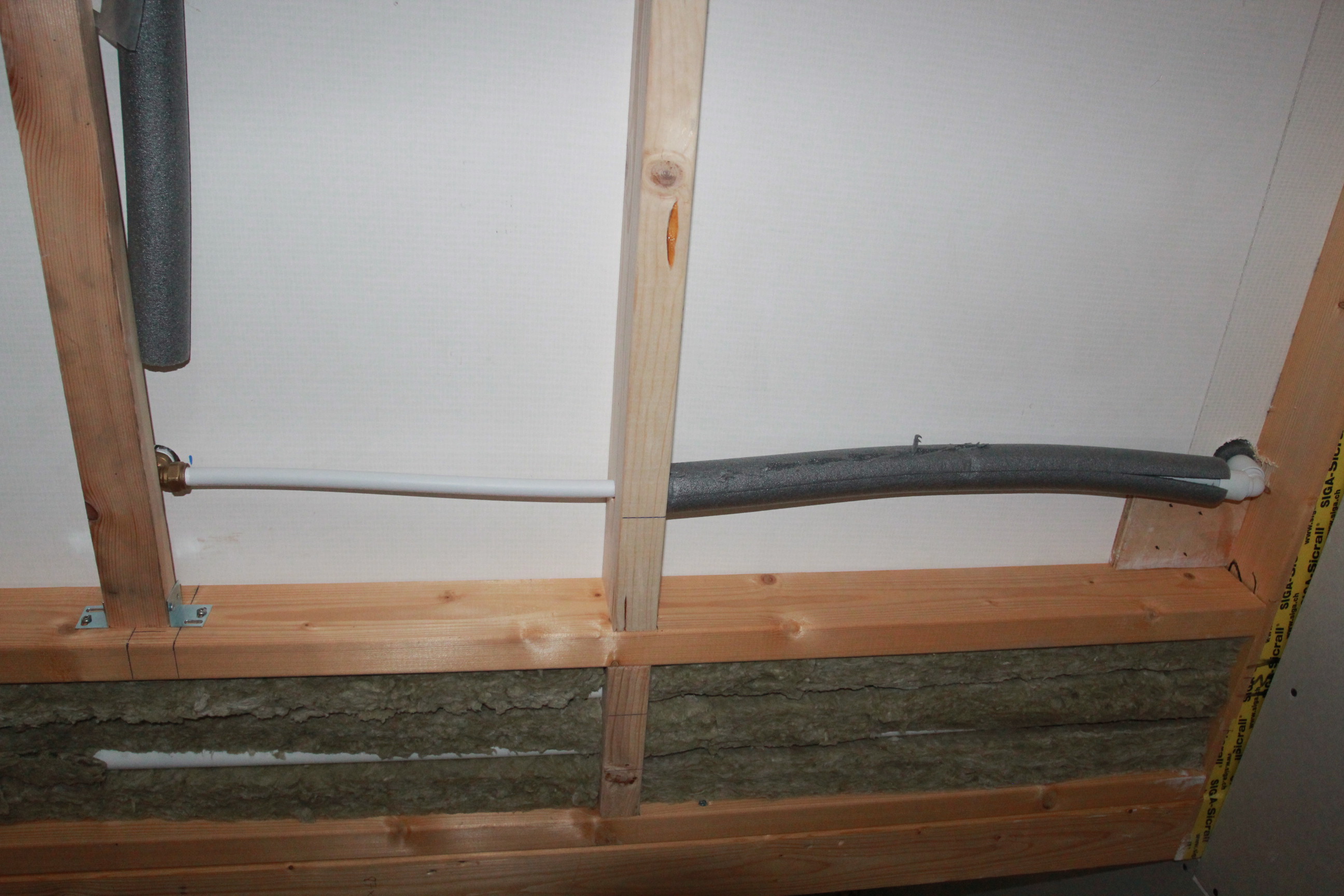

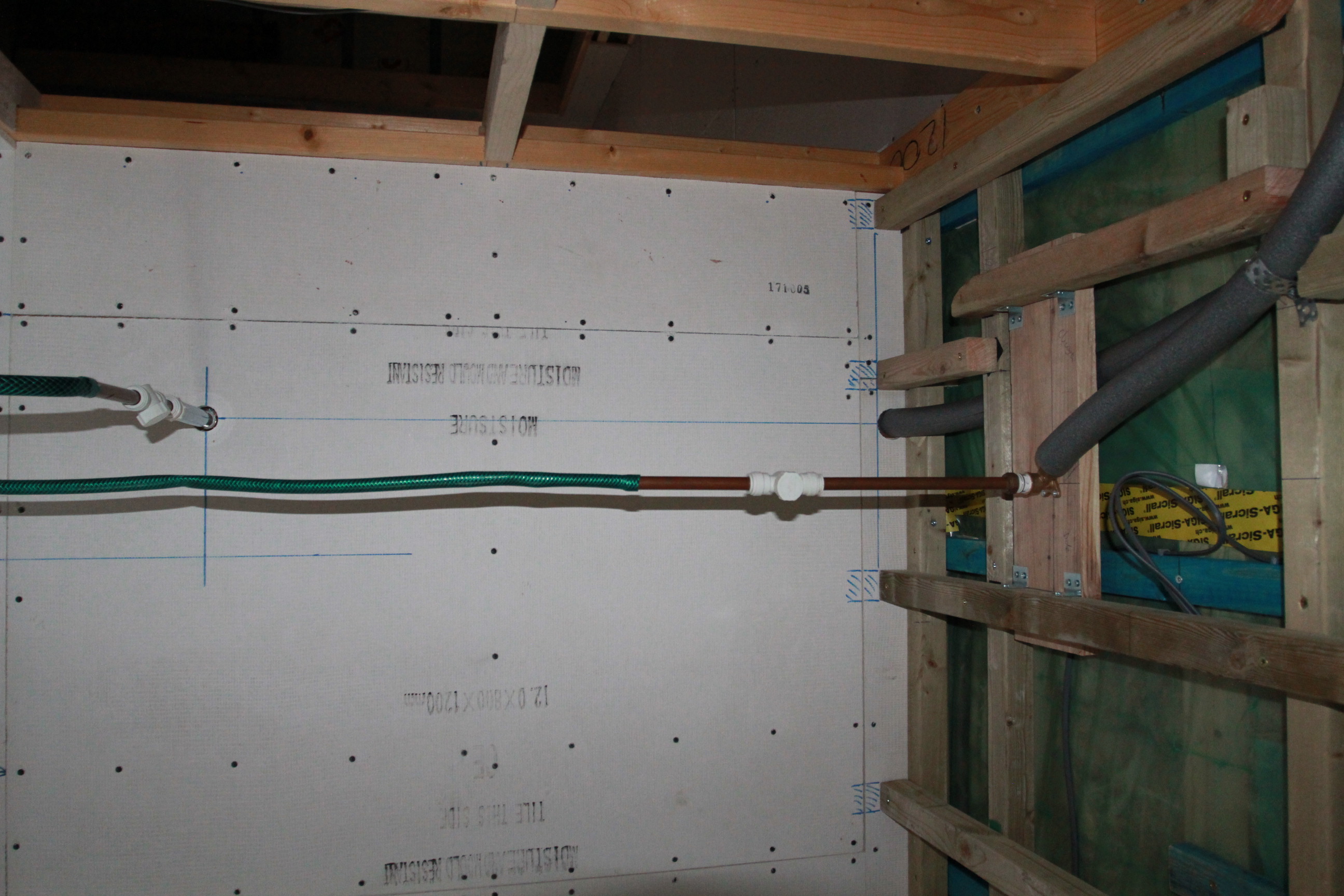

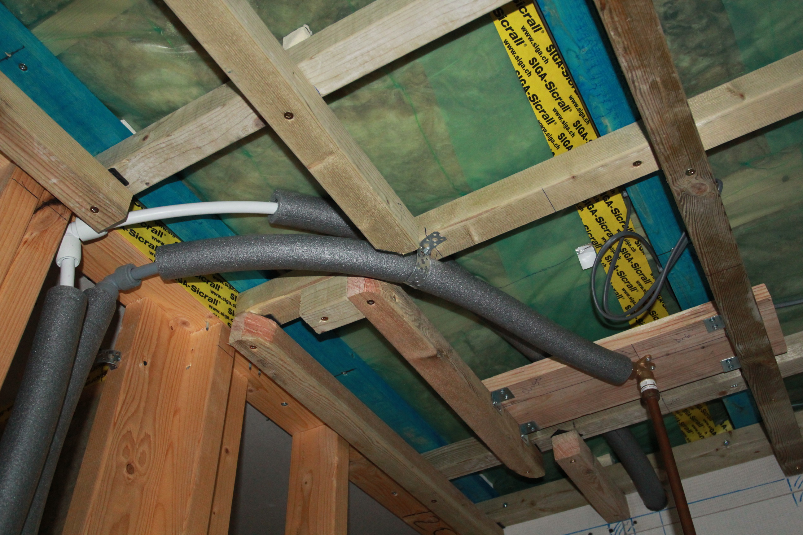

CC45 Posted March 19, 2018 Share Posted March 19, 2018 I've just put 3 of these in - tap connections. Generous ptfe and screw in hand tight. I've tested mine to over 6bar. No leaks at all. They arent tapered. I chose to go with rainfall head being fed from the ceiling (false one so plenty of room for pipe etc) rather than a wall mounted one - wasnt too sure about how strong they are. Happy to post pics if anyone is interested. Link to comment Share on other sites More sharing options...

Nickfromwales Posted March 19, 2018 Share Posted March 19, 2018 End feed, remember Link to comment Share on other sites More sharing options...

Onoff Posted March 19, 2018 Share Posted March 19, 2018 23 minutes ago, CC45 said: I've just put 3 of these in - tap connections. Generous ptfe and screw in hand tight. I've tested mine to over 6bar. No leaks at all. They arent tapered. I chose to go with rainfall head being fed from the ceiling (false one so plenty of room for pipe etc) rather than a wall mounted one - wasnt too sure about how strong they are. Happy to post pics if anyone is interested. Pics please as I plan ceiling mounted. Above the ceiling too if you've any shots. Cheers. Link to comment Share on other sites More sharing options...
CC45 Posted March 19, 2018 Share Posted March 19, 2018 Will take some tomorrow night. ? 1 Link to comment Share on other sites More sharing options...
CC45 Posted March 20, 2018 Share Posted March 20, 2018 (edited) right...... Hopefully these are visible when I hit submit reply. Ignore the various pipes coming off the fittings - its under test (6 bar and no leaks so far). Counter battened ready for led spot lights (didn't want to mess around with the vapour barrier) - got plenty of ceiling height. Any constructive comments gratefully received! PS translation available for those of you who notice the Welsh scribbles..... Edited March 20, 2018 by CC45 update 1 Link to comment Share on other sites More sharing options...

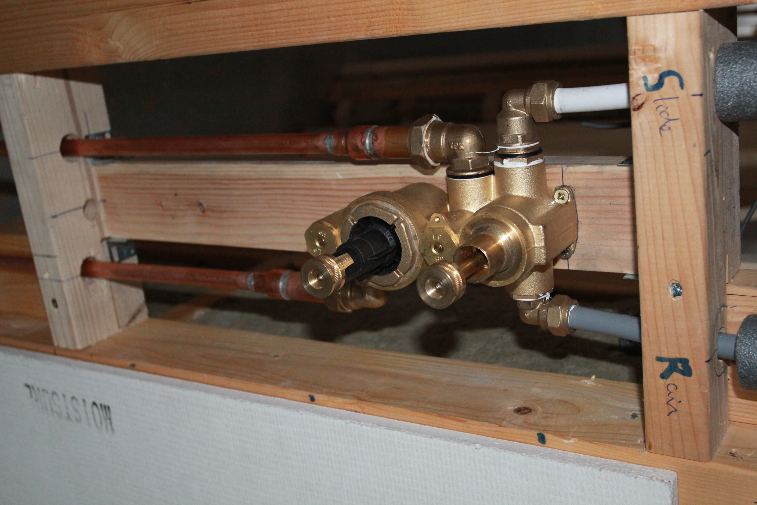

ProDave Posted March 21, 2018 Author Share Posted March 21, 2018 Here you go. Sorry about the poor picture I just could not get the lighting right. 1 Link to comment Share on other sites More sharing options...
Onoff Posted March 21, 2018 Share Posted March 21, 2018 2 hours ago, ProDave said: Here you go. Sorry about the poor picture I just could not get the lighting right. Nice bends (spring?). Is that diverter the same as my one? Link to comment Share on other sites More sharing options...
ProDave Posted March 21, 2018 Author Share Posted March 21, 2018 Himlor bender. Yes that is the same valve. Link to comment Share on other sites More sharing options...
