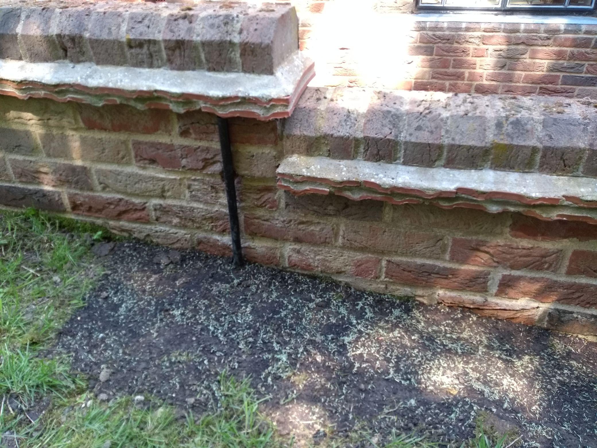

Temp Posted June 11, 2018 Share Posted June 11, 2018 Definitely put the cable in the conduit before filling trenches if that's possible. Makes things much easier. You could transition to rigid conduit where that's visible as I think it looks better... I need to fix the conduit to the wall one day. Ignore the new grass seed and the SS screws, I need to replace those. Link to comment Share on other sites More sharing options...

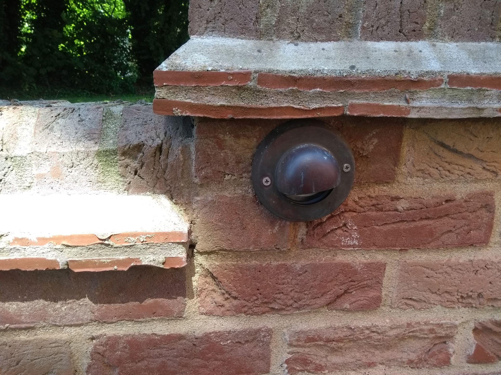

Temp Posted June 11, 2018 Share Posted June 11, 2018 (edited) 1 hour ago, daiking said: No old tiles here just bricks and bricks and more bricks. What type of cable could be clipped to the wall? UV stable, weather resistant, not SWA? What is the gland on the lights designed for and do they need an earth or are they double insulated? Mine were designed for a (eg one, so cant use light as a junction box) "rubber" cable similar to this.... https://www.toolstation.com/shop/p17796 So we have SWA in the ground with potted junction boxes (one per light) to T off in the rubber. This rubber cable runs up to the light from the buried SWA. It needs protecting from the strimmer above ground hence the short length of conduit in my photo. If you are protecting all of the underground run with flexible conduit I think you could use that rubber cable for the whole run but it's really a question for the electrician. Don't forget the marker tape. Edited June 11, 2018 by Temp Link to comment Share on other sites More sharing options...
