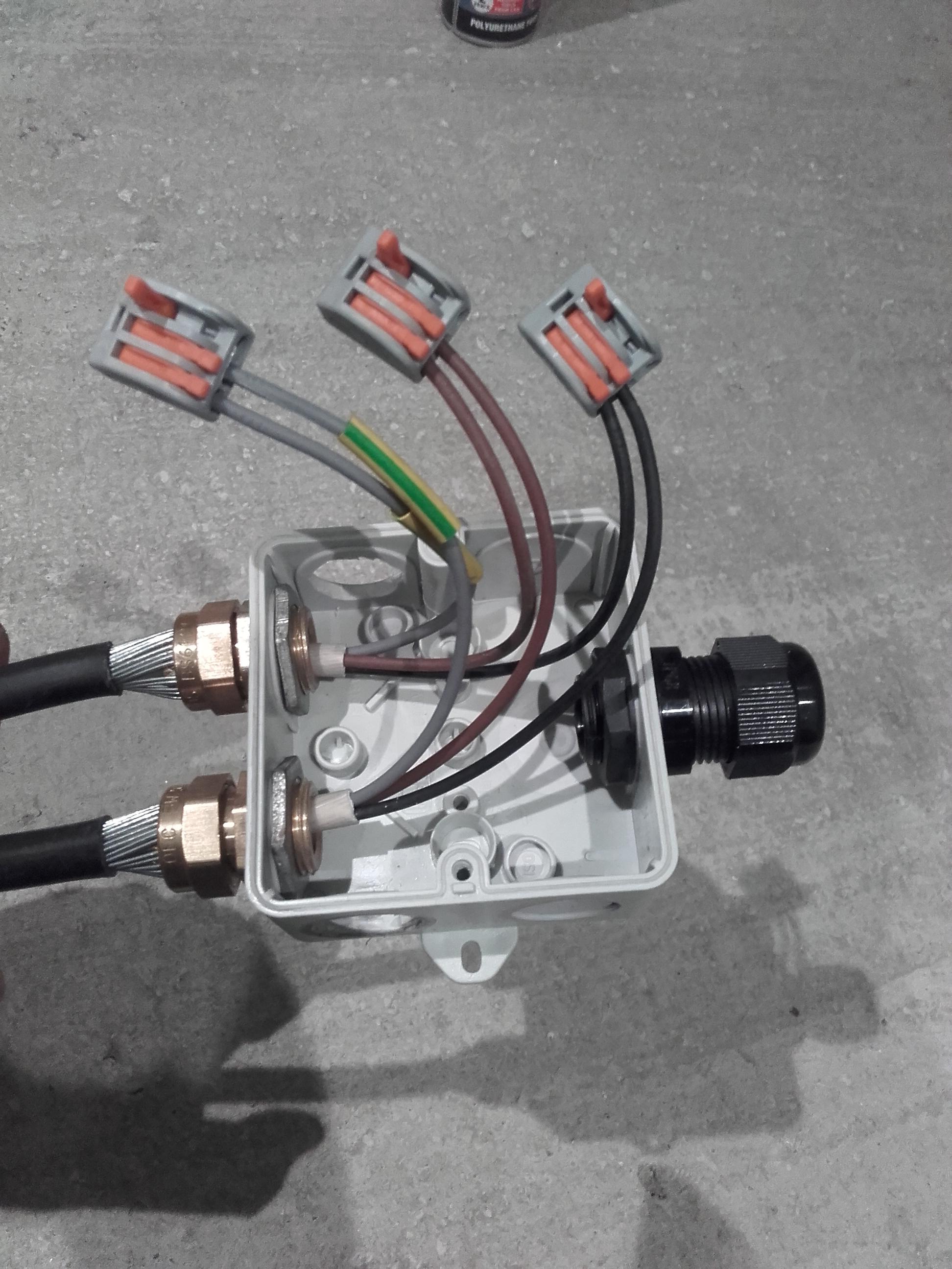

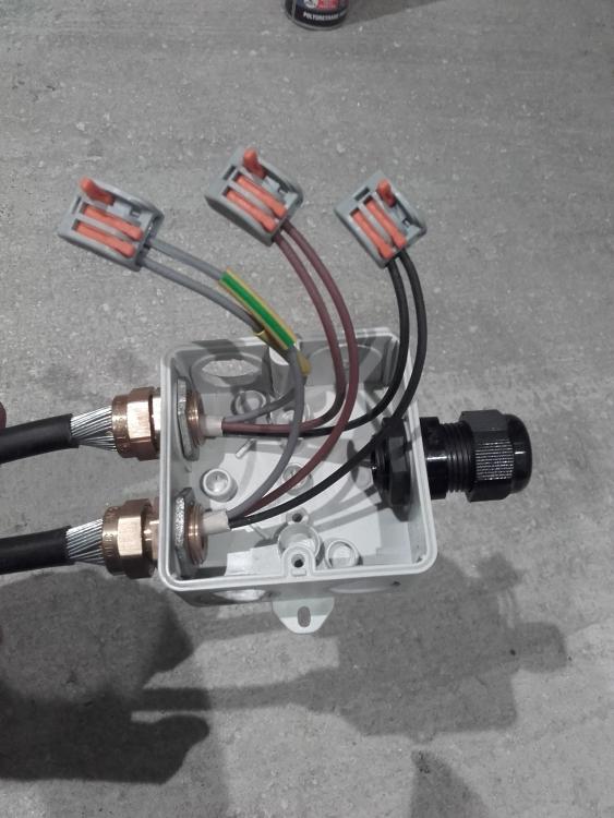

Onoff Posted April 1, 2018 Share Posted April 1, 2018 (edited) How about Wago-Capsules? Cheaper than Pratleys https://www.connexbox.com/wagobox-capsule-ip68-adaptable-junction-box-grey.html In and out with the swa. Internal connections using Wagos so maintenance free. Then a short bit of flex in 20mm flexible conduit to each light. You need the earth plate to keep continuity of the armoured: https://www.connexbox.com/wagobox-capsule-lid-steel-earth-bonding-plate-for-20mm-glands-with-earth-cable.html Edited April 1, 2018 by Onoff Link to comment Share on other sites More sharing options...

Onoff Posted April 2, 2018 Share Posted April 2, 2018 (edited) Just having a play here with an old 80x80x50 box: You'll easily get two swa glands and a flex/conduit gland in plus x3 Wagos. If you used a similar Wiska box: https://www.rselectricalsupplies.co.uk/wiska-308-combi-empty-pvc-enclosure-ip66-85x85x51mm-308emptyb_1734? On the 308 box the swa glands with screw straight in without the locknut. If you get the optional earth bar that takes care of maintaining continuity of the swa: You will need to replace one of the Wagos with a 5-way to take the fly lead from the earth bar. You could.....buy an undrilled enclosure yourself. Drill x3 20mm holes. Put the swa banjos back to back (to maintain continuity) and fit an M6 brass nut and bolt with ring crimp for the fly lead... https://m.ebay.co.uk/sch/i.html?isRefine=true&sid=miromst&isRefine=true&_pgn=1&_mwBanner=1 Edited April 2, 2018 by Onoff Link to comment Share on other sites More sharing options...
daiking Posted April 3, 2018 Author Share Posted April 3, 2018 17 hours ago, Onoff said: Just having a play here with an old 80x80x50 box: You'll easily get two swa glands and a flex/conduit gland in plus x3 Wagos. If you used a similar Wiska box: https://www.rselectricalsupplies.co.uk/wiska-308-combi-empty-pvc-enclosure-ip66-85x85x51mm-308emptyb_1734? On the 308 box the swa glands with screw straight in without the locknut. If you get the optional earth bar that takes care of maintaining continuity of the swa: You will need to replace one of the Wagos with a 5-way to take the fly lead from the earth bar. You could.....buy an undrilled enclosure yourself. Drill x3 20mm holes. Put the swa banjos back to back (to maintain continuity) and fit an M6 brass nut and bolt with ring crimp for the fly lead... https://m.ebay.co.uk/sch/i.html?isRefine=true&sid=miromst&isRefine=true&_pgn=1&_mwBanner=1 Thanks for your efforts it’s appreciated, shouldn’t you be finishing your bathroom? Im amazed I can’t find some guidance to how to do this online. I just want to know how to do the donkey work now with the cables so the hard bit can by done later by someone SQEP’d. @ProDave a pukka domestic electrician is ignoring me, any advice? Just want to bury the cable so the lights can be connected later. Link to comment Share on other sites More sharing options...

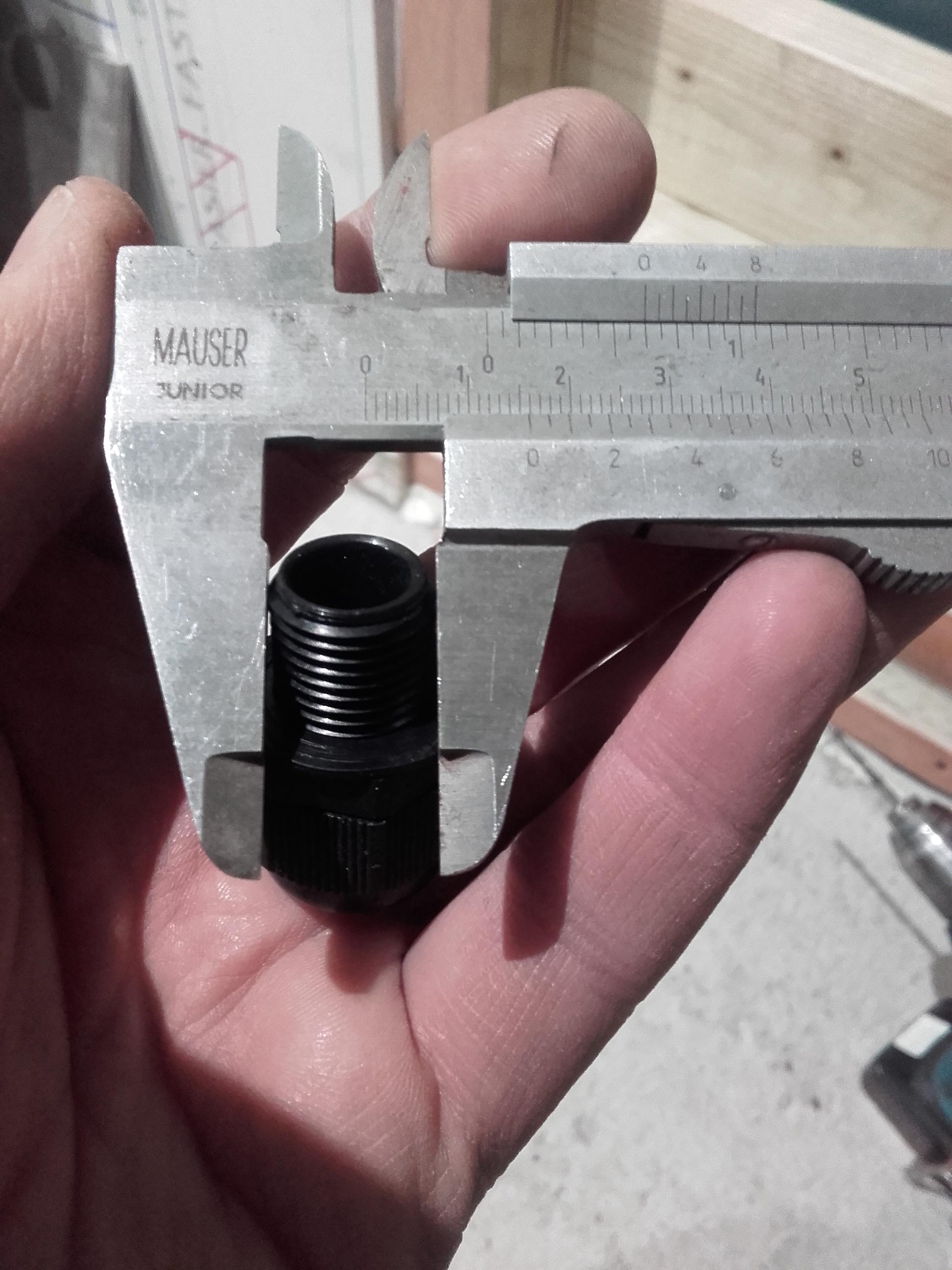

daiking Posted April 3, 2018 Author Share Posted April 3, 2018 FWIW the little brass fittings on the lights have a M12 thread so the hole through the middle is a lot smaller. Link to comment Share on other sites More sharing options...
