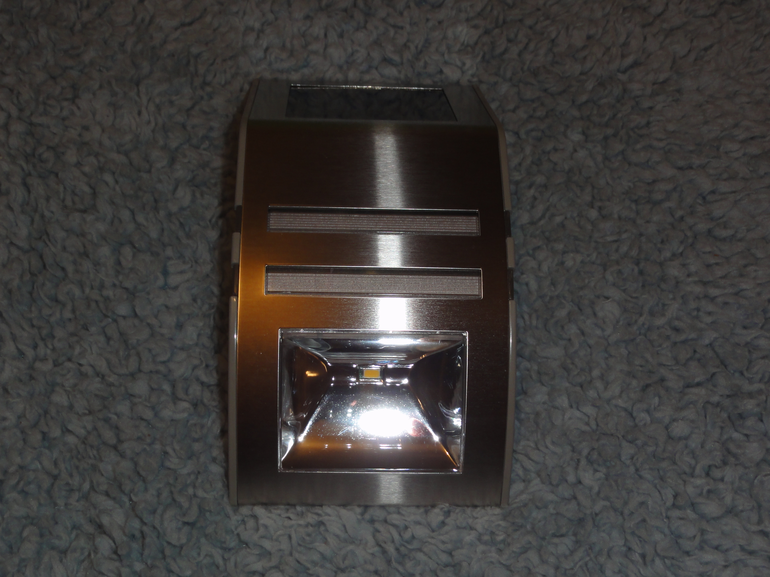

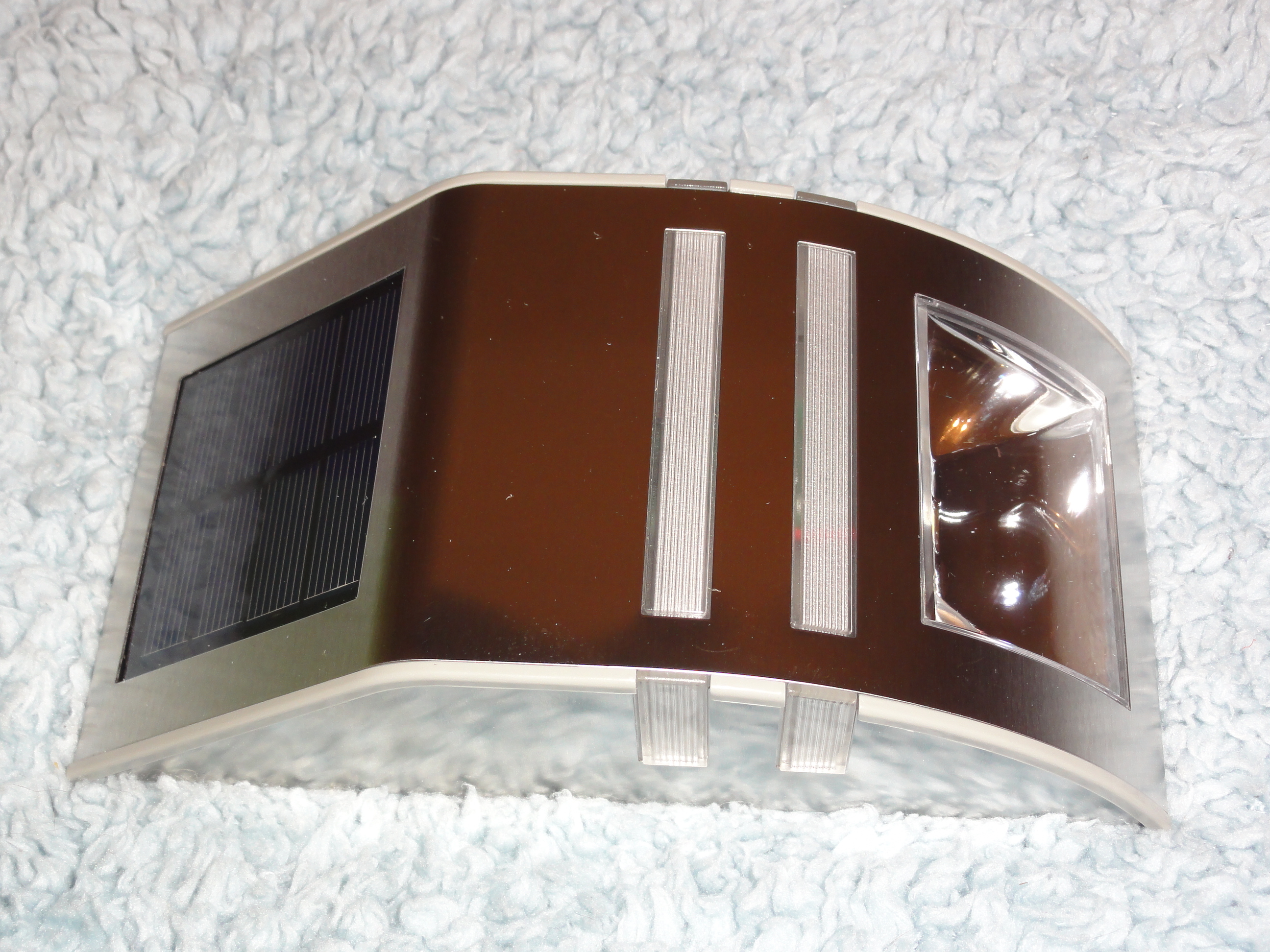

Moira Niedzwiecka Posted March 29, 2018 Share Posted March 29, 2018 @daiking I have just checked on Costco's website & they are not listed. They may only be available in store. I am at work at the moment. I will photo them when I get home. We also bought the Paradise stainless steel coach lights from Costco for either side of the front door. Very nice and about £30 for two. Link to comment Share on other sites More sharing options...
daiking Posted March 29, 2018 Author Share Posted March 29, 2018 1 hour ago, Moira Niedzwiecka said: @daiking I have just checked on Costco's website & they are not listed. They may only be available in store. I am at work at the moment. I will photo them when I get home. We also bought the Paradise stainless steel coach lights from Costco for either side of the front door. Very nice and about £30 for two. Thanks Link to comment Share on other sites More sharing options...
Moira Niedzwiecka Posted March 29, 2018 Share Posted March 29, 2018 @daiking Pics of solar lights. They come with a 1x AA rechargable battery for each as a back up. Stainless steel & give a good light. 1 Link to comment Share on other sites More sharing options...
