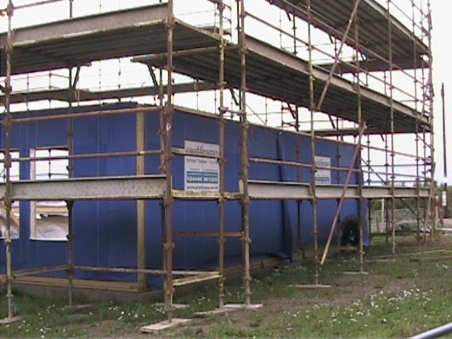

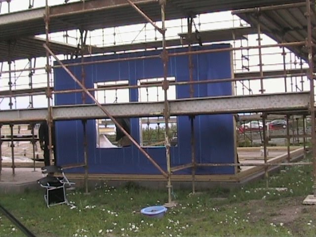

newhome Posted March 14, 2018 Share Posted March 14, 2018 2 hours ago, SteamyTea said: How hard would it be to manufacture a basic wall module that could be knocked up in a shed/garage/shipping container but just about anyone that also complies with the thermal, structural and safety elements that are needed for a house. Thinking that some basic jig would need to be made and people then just slot in the OSB and timbers, then glue/nail together. How hard can that be? Wasn’t the whole hog clearly but this is what we had. Timber frame and ‘Supawall’ panels 9 years ago. Not sure what progress has been made since. Link to comment Share on other sites More sharing options...

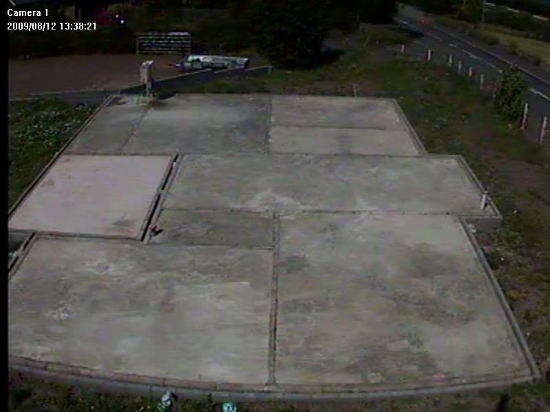

newhome Posted March 14, 2018 Share Posted March 14, 2018 1 hour ago, SteamyTea said: @newhome What sort of foundation do you have, and was it quick and simple to do? Foundations were here already as we bought the plot after the foundations were laid which is why we were also tied to the house design, but planners wouldn’t have been receptive to a different style of house anyway as they kicked off when we wanted to change the fenstration as ‘it would spoil the cottagy look and be out of keeping’. FFS there is nothing ‘cottagy’ about this house and they seem to have completely overlooked the Swiss Cottage type house behind me that is completely out of keeping already! They are quite deep and ‘traditional’. We had more put in for an additional room too (see photo). I know that they are deep as the structural engineer insisted that I dig down to the bottom of the foundations to expose the ground beneath where the original foundations met the additional room to get the SER for the extension. He said they might be 450 - 600mm he thought. He was coming to inspect it on the Monday am so I started digging with a garden spade on Sat am. 1.2 metres down on Sun lunchtime it was too deep and the ground too heavy for me to dig further. I admitted defeat and someone came and dug the rest out in the dark on Sun night. It was about 1.5 metres in the end. Structural engineer peered into the hole and said ok. I was half dead mind Link to comment Share on other sites More sharing options...
