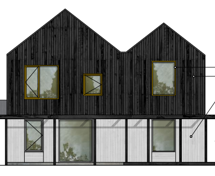

We're looking to self-char some of our timber cladding (about 130m2) and are limited to a propane + gas torch approach.

Yup, that is right, but we simply cant justify the £75/m2+ cost on a full 130m2!
We're going half and half on the charring and the weathering as you can see. Why not do the same ;)

Looks great. What wood will you be using?
Siberian Larch cladding - Grade A / Unsorted @ £28.8/m2 (£3.6/m) from Mill Works. Best quote we could get for this quality.
There's Grade B / Sawfalling (more knots) which is cheaper at £23.2/m2 (£2.9m), so that is our backup in case another line item rises in price.

We hoped to do this.........unfortunately the planners didn't like the idea. I did wonder if the charring would rub off if used at ground level, but maybe the wire brushing stops that.
Did you do it in the end , if so how was the process and result?
