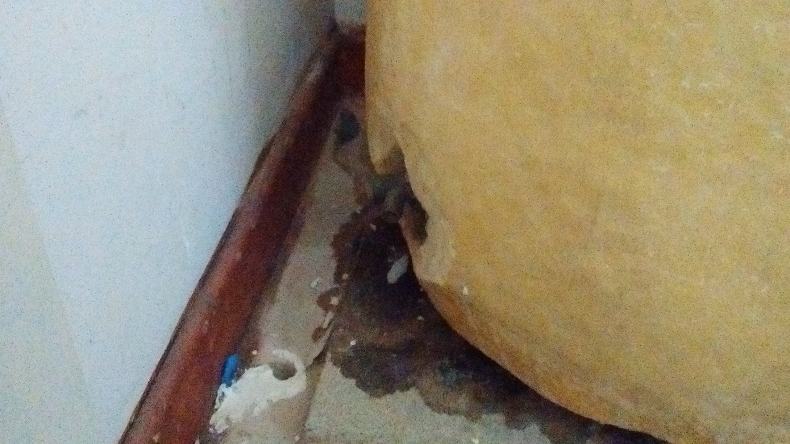

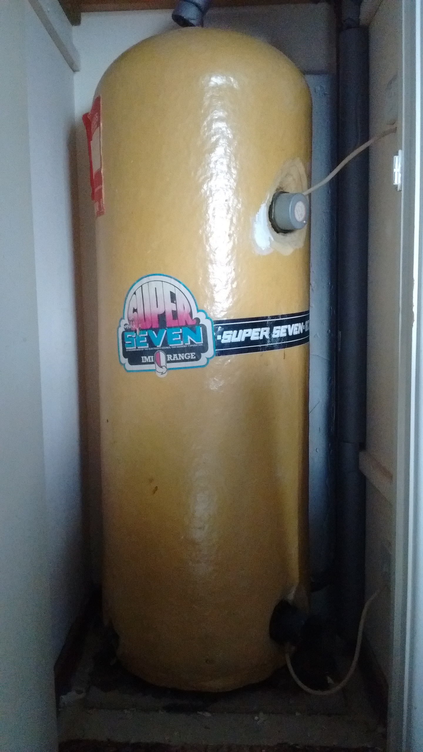

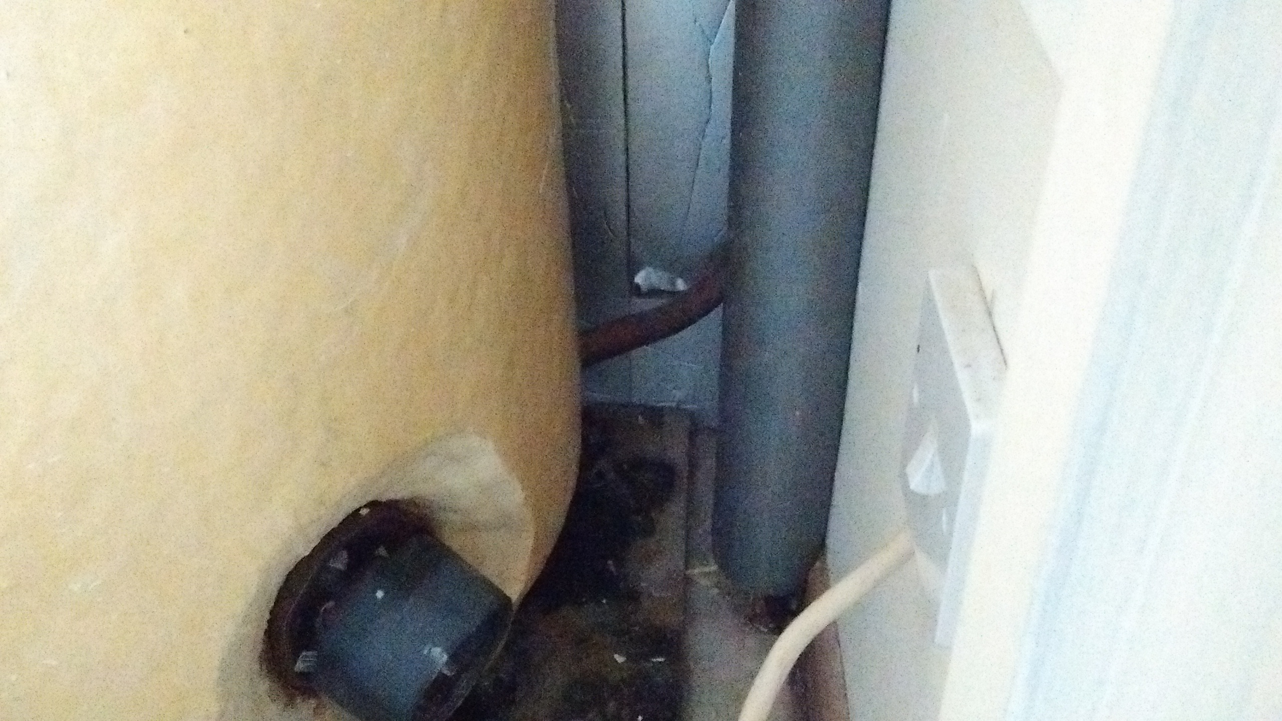

March 7, 20188 yr Having eventually got around to organising myself to change the bottom element on my E7 water heater, I have found it is leaking. So that takes one unknown away. So are all Vented, E7, DHW cylinders basically the same. To the best of my measuring, mine is 1.5m high, 0.5m wide and with about 40mm of insulation. The elements are both on the same side with the feed pipe going in at the bottom and a few degrees anticlockwise, the drain is opposite. There are some pictures below. I have been to a couple of websites and they seem to be around the £300 mark. Is that about right? I am hoping to just get a direct swap as that will save any mucking about with pipes, but I could, fairly easily, extend the top pipe downwards and re-jig the feed pipe. would rather not though. It would give me less heat losses, a slightly cheaper cylinder (though not much) and a larger airing cupboard (which might be useful). (edit, seems the website does not like .png files) Edited March 7, 20188 yr by SteamyTea

March 7, 20188 yr Author Images should be better, nothing wrong with my camera. I was more looking for advice on the cost of a direct replacement, going to be easier all round. So are all cylinders basically the same. So something like this: https://www.coppercylinder.co.uk/1500-60-x-450-18-direct-hot-water-cylinder-economy-7-227-18-ex-vat/ would slot in?

March 7, 20188 yr Author The bottom feed pipe seems to be at the same height from the ground, 100mm. But, the drawing shows it on the other side from mine. Not sure of that is just to make life easy on the drawing, or it is actually there.
March 7, 20188 yr Author Right a quick call to the geezer at the cylinder place and apparently I can specify where the feed goes in. So looking from the top downwards and placing my heating elements at 6 'o' clock, my feed goes in at 3 'o' clock. Does that make sense before I order it? Edited March 7, 20188 yr by SteamyTea Measure twice, cut once
