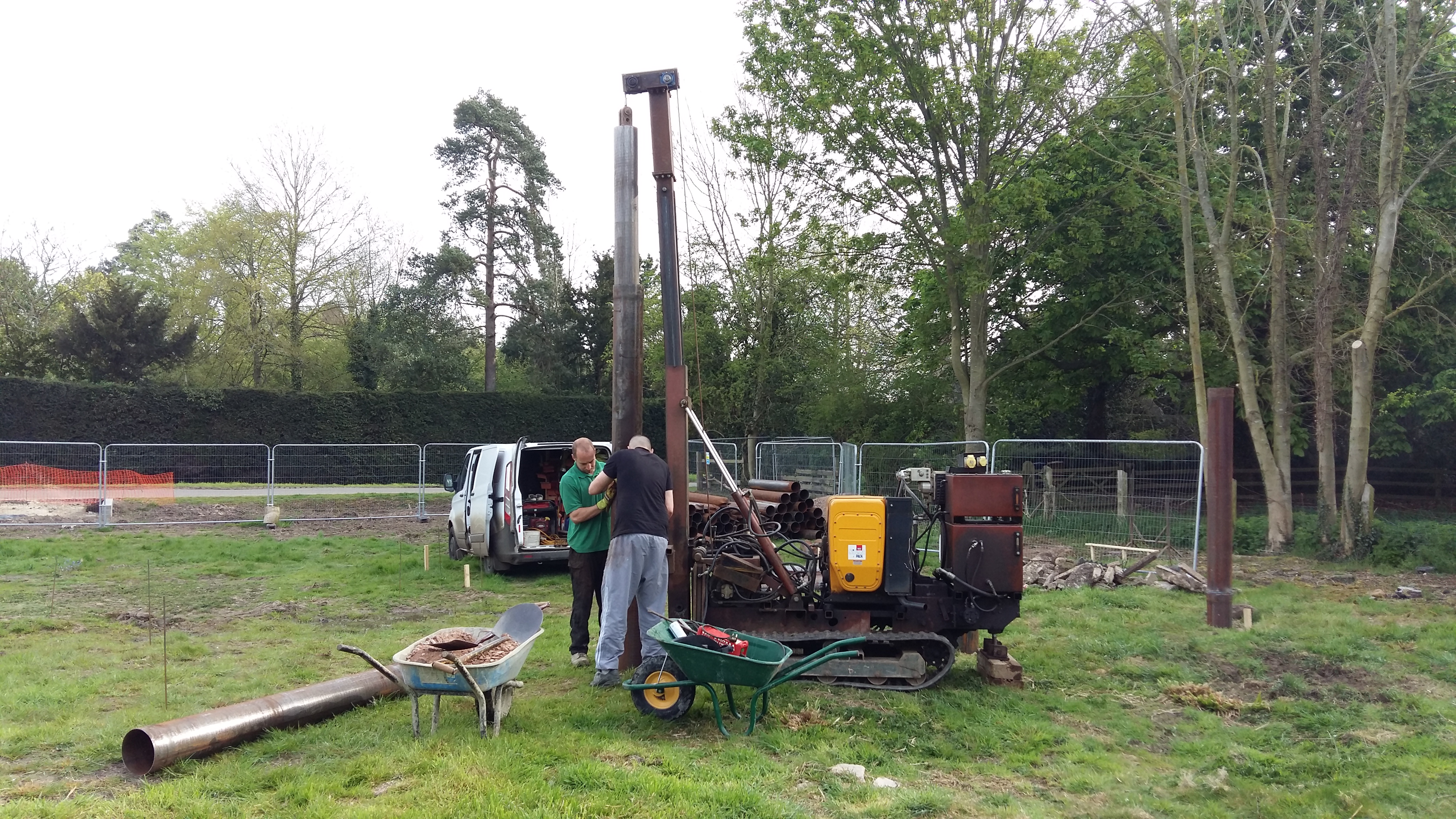

Thats a shame because the job was done in one day.... 64 4 meter  'piles'

I’ve had a good look at your pics @recoveringacademic And I think we will struggle to get the rig around a 90degree corner we have, that’s very quick 64 in a day.

We got the rig round two 90 degree bends. Heart in mouth true enough, but we also got it over a weak bridge  :ph34r:
We had 26 x 10m deep piles as you describe.  It took about a week.  The little tracked rig arrived on trailer behind a 4x4 so no big mobilisation fees, minimal noise and disturbance to neighbours. Filled with concrete with rebar down the centre for tying into the ring beam.  I've no experience of other methods, but I'd happily use this again without a second thought.

Yeah, fenland, so an underlying layer of peat.  Engineered foundations are pretty much par for the course round here.  I've just checked the paperwork - my mistake, 24 piles not 26; in round figures, £9.5k for the piling and £13.5k for 111 linear metres of ring beam ...and this is what it looked like!
