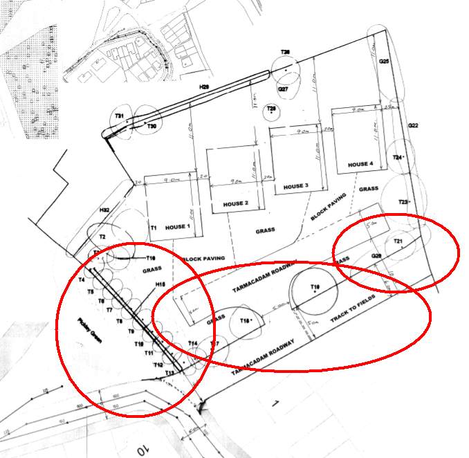

Aha. That looks doable if the consultant is familiar with the local Council policies. But it might be productive to specify a memo report not a posh report.
When I look I was a little concerned about all those trees ... particularly the long row of 70ft Lombardies and who would own them as it looked like common space, and about the house orientation with the back gardens facing. North iirc.
Without researching local prices, I might look at 2 or 3 with a different orientation, possibly a bigger one for you and two smaller houses.
Beware of TPOs, so deal with your trees before PP application.

Posted (edited)
57 minutes ago, Ian D said:
The trees are on our land so we own them
@Ian D
I was looking at the existing planning app, where the Lombardies are a line alongside the common drive/parking area, so could fall into a common ownership of some sort depending on how it is all set up in the new scheme.
The trees circled are the ones where future ownership would not be clear, and the back gardens of the houses lose their sunny aspect as they are on the north side.
That S106 also looks nebulous - afaics it does not say what the Planning Obligation sum is. That may be to your advantage as you can negotiate it or possibly change your Planning App to avoid it entirely.

I think that is quite a good scoping study to give a sanity check on the possibility of a project.
Clearly they know the Council and the Locality.
There is much work to be done after receiving such a document, and the creation of specific proposals plus exploration of more technical constraints, but it is a good start at identifying site and planning policy questions.
IMO decent value, although the sort of thing some on here would be do ourselves. If I couldn't do an initial assessment myself or had too much on I would pay them that much quite happily.
I think that a brief with specific questions and areas of interest may extract even more value.
The only obvious mistake at a quick scan is the suggestion that Trees in Conservation Areas have the same protection as a TPO .. in fact the TPO process to do things to a tree is a free Planning Application needing specific approval ( with an exception of dead, decaying, dangerous or diseased) whilst Conservation Area tree work is give notice and proceed if the Council do not react.
But to be fair to them they err on the side of caution wrt to CA trees, which is the right side to be.
