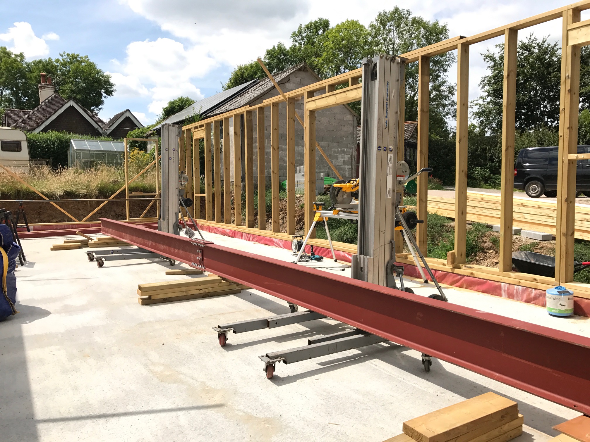

Triassic Posted February 25, 2018 Posted February 25, 2018 I went with. Local steel stockholder, I told the they needed to deliver using a vehicle with a crane (Hyab), no problem, they came with a truck mounted crane that could lift 9 tonnes, a real monster of a thing at no extra cost. 1
Nestor Posted February 25, 2018 Posted February 25, 2018 Worth getting a few quotes. We just slid the steels (305mm x 127mm) off the lorry, moved into place with levers and scaff poles. 2 x 5m spliced and lifted 4.8m with genies. It was a big day. 1
StructuralEngineer Posted March 27, 2018 Posted March 27, 2018 It's superb to see such a clear WIP photo. It worries me slightly that this is supported off timber stud though. 10m is very long for a steel in a domestic situation.
