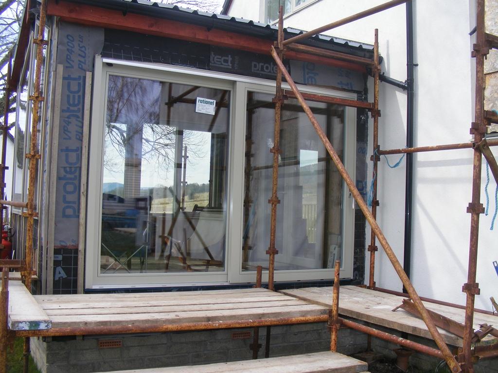

ProDave Posted April 22, 2021 Share Posted April 22, 2021 Must it be aluminium? Would aluminium clad timber be okay? Just fitted this Rationel aluminium clad timber slider. Just under 3M wide and 2.1M tall triple glazed. Very pleased with it. All I would say is Rationel don't do triple sets, so if you must have 3 panes they probably won't do what you want. 1 Link to comment Share on other sites More sharing options...
Ralph Posted April 22, 2021 Share Posted April 22, 2021 33 minutes ago, ProDave said: All I would say is Rationel don't do triple sets, so if you must have 3 panes they probably won't do what you want. I really like our Rationel doors but not having the triple set is a bit annoying, We ended up with what is essentially a fixed pain and a double door set with the frames being different widths. It bugs me a little but no one else seems to mind. Link to comment Share on other sites More sharing options...

ProDave Posted April 22, 2021 Share Posted April 22, 2021 15 minutes ago, DragsterDriver said: Are they expensive? ? That slider was £3079. Roughly double what I could have got a local cheap double glazed slider for. But the rest of the house has Rationel and it would be a crime to fit cheap UPVC to the sun room. I am sure prices have gone up a lot since we bought the rest of the windows nearly 5 years ago. 1 Link to comment Share on other sites More sharing options...
