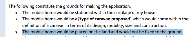

hmpmarketing Posted February 16, 2018 Author Posted February 16, 2018 (edited) 3 minutes ago, ProDave said: In England and Wales, the electrics will be notifiable under Part P. Just use an electrician signed up with one of the self certification schemes and they will notify it for you. No need to contact building control. I would have thought a simple foundation slav is all you need with this building sitting (not fixed) on top of that. Well 150mm and 300mm footings would be considered simple I believe..... Just reading the PDF form the site @Ian provided , regarding Caravans and Mobile Homes, reading the sample description letters: If the SIPS panels are bolted to the slab, wouldn't it invalidate the whole argument of it being a mobile home? Edited February 16, 2018 by hmpmarketing
ProDave Posted February 16, 2018 Posted February 16, 2018 21 minutes ago, hmpmarketing said: Just reading the PDF form the site @Ian provided , regarding Caravans and Mobile Homes, reading the sample description letters: If the SIPS panels are bolted to the slab, wouldn't it invalidate the whole argument of it being a mobile home? Yes. Instead, make a free standing base say of 6 by 2 timbers that just sits on the slab, and fix the SIPS panels to that, making a rigid self contained building that is demonstrably portable by picking the whole thing up as one lump. You can insulate between the joists of that base so it is instantly better than just sitting on a cold uninsulated concrete slab as your floor.
