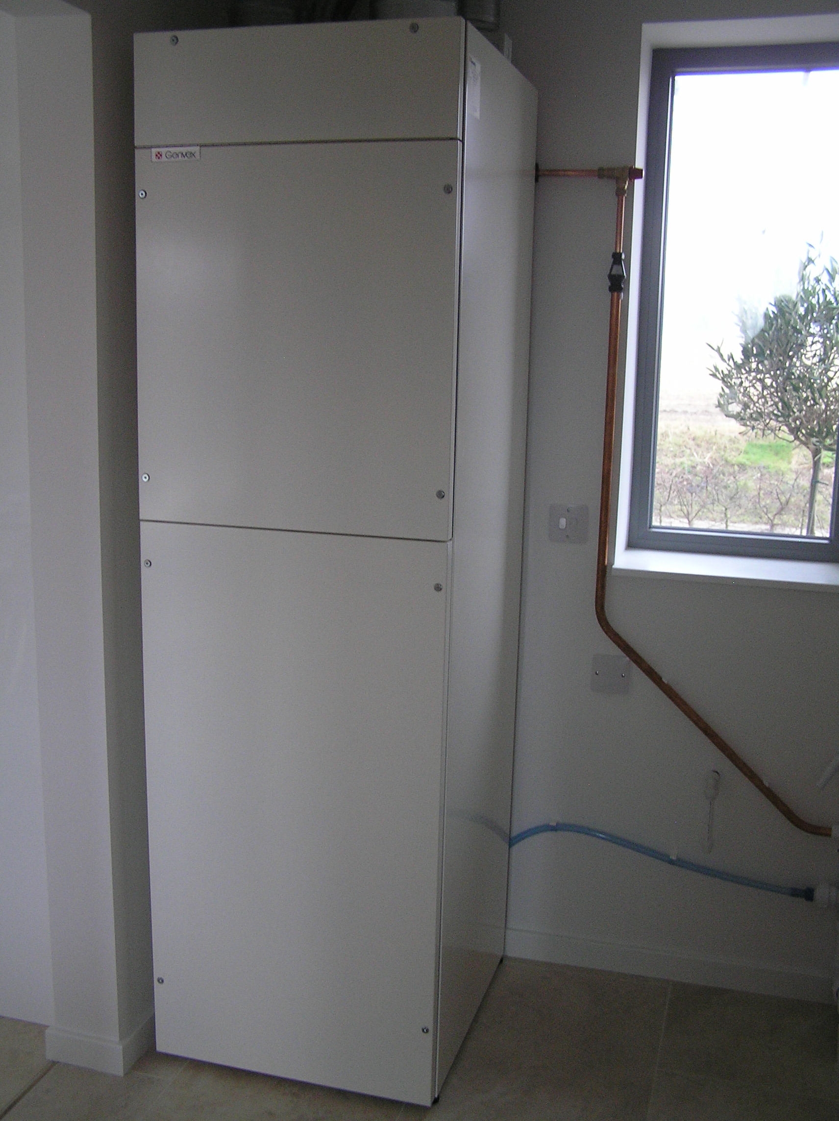

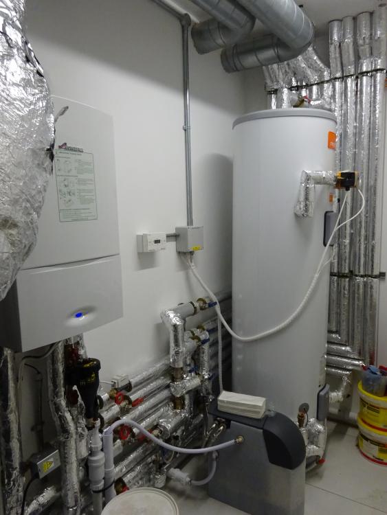

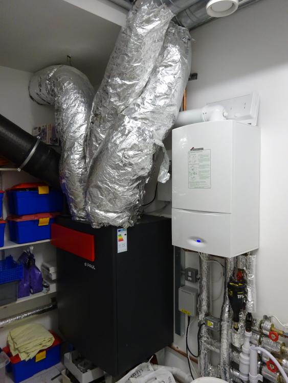

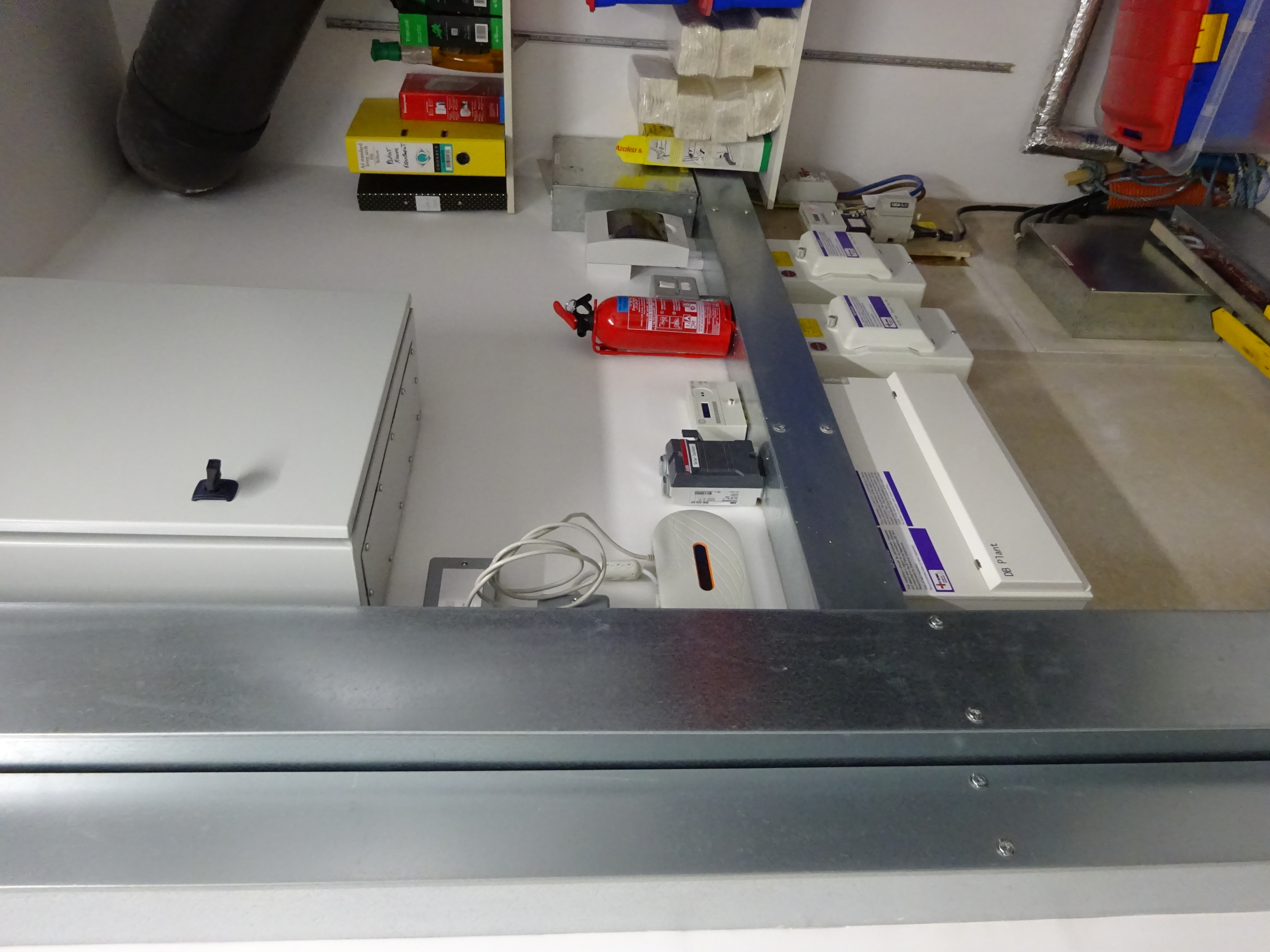

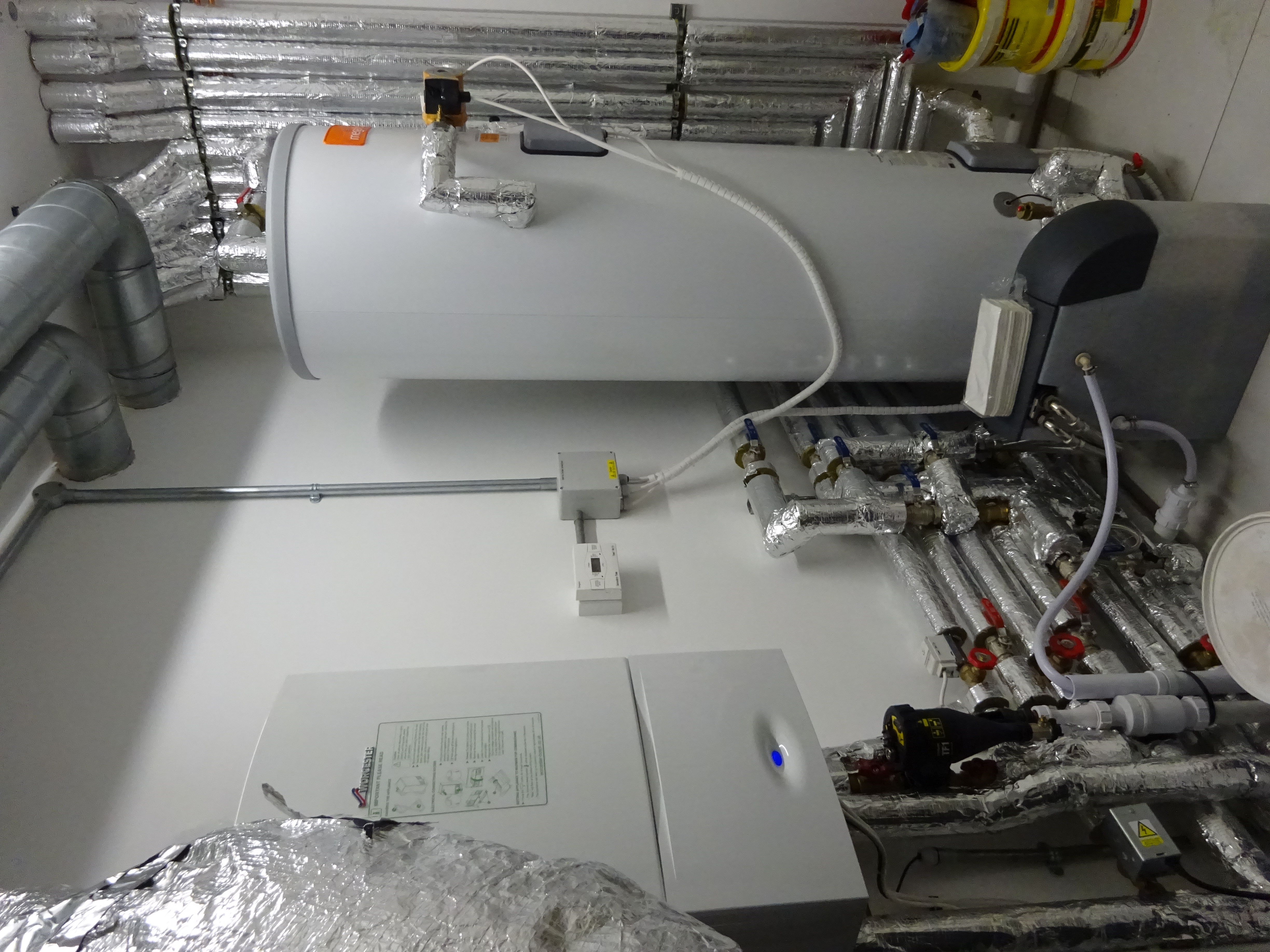

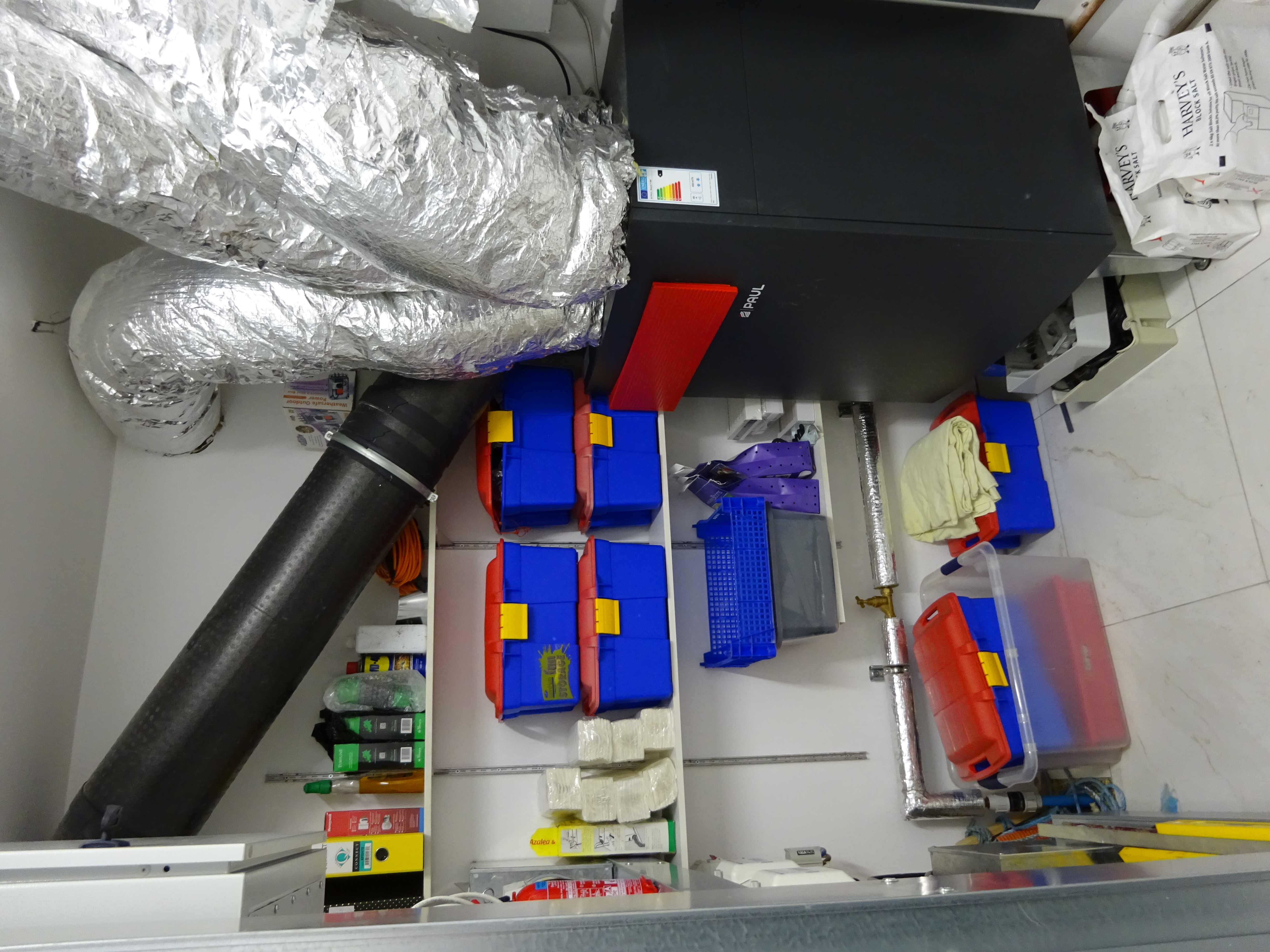

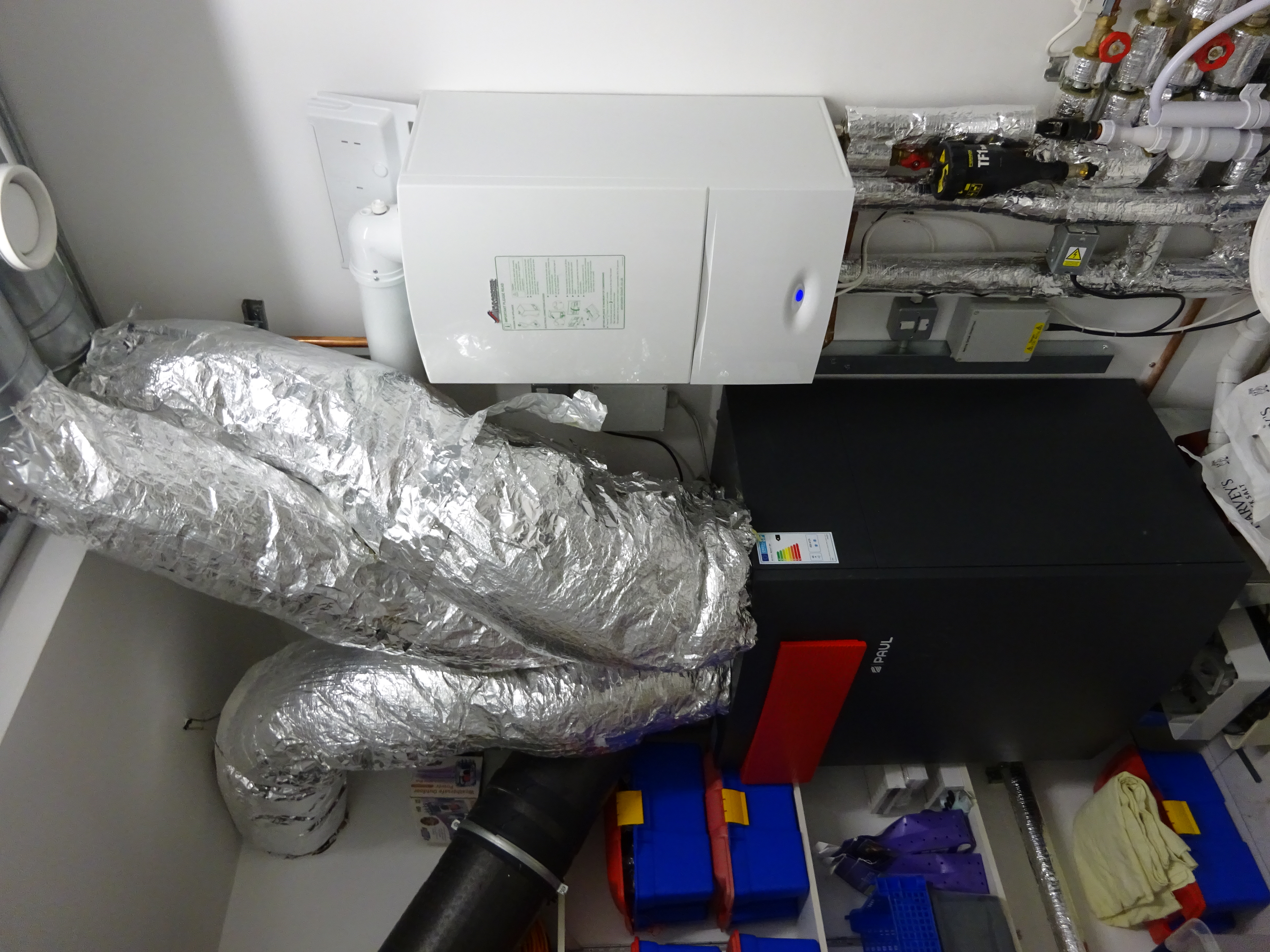

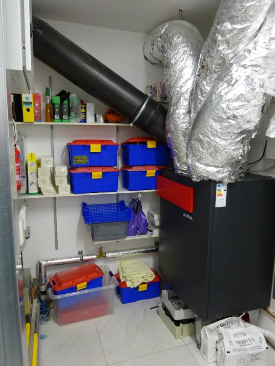

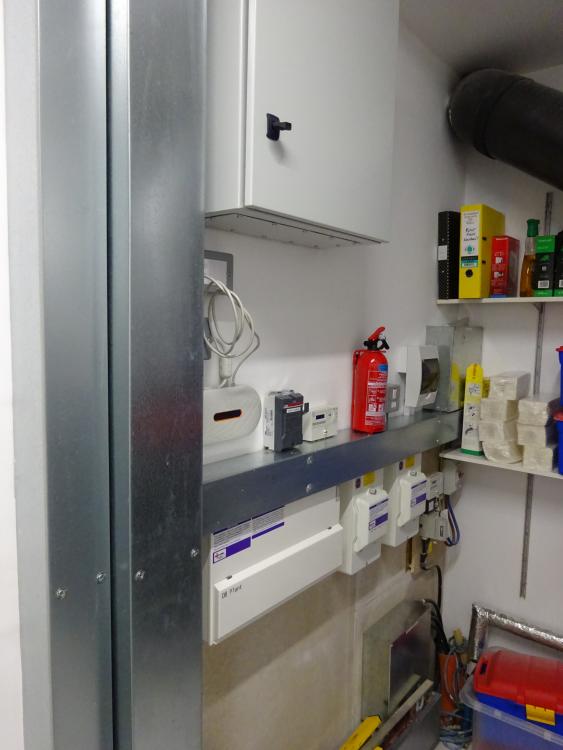

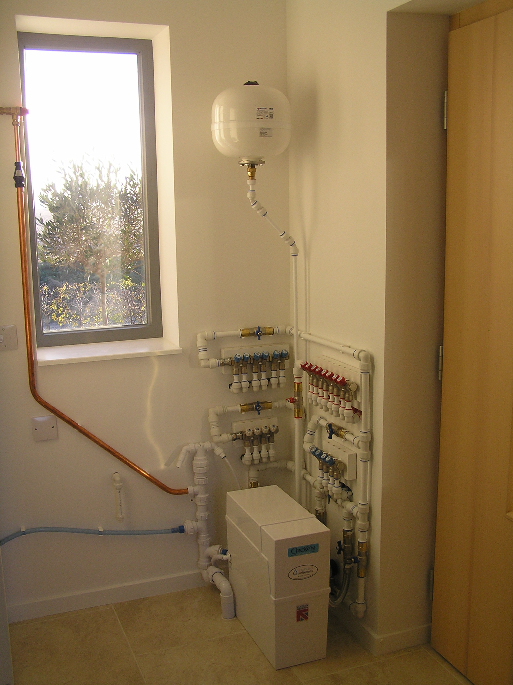

Gone West Posted February 12, 2018 Share Posted February 12, 2018 This is the water supply side. This is the hot water, ventilation and warm air heating unit (Genvex Combi185). This is the electricity cupboard. The washing machine will be squeezed in between the Genvex and water supply cupboard (when built). This is all in a room 1.9m x 2.3m. Link to comment Share on other sites More sharing options...

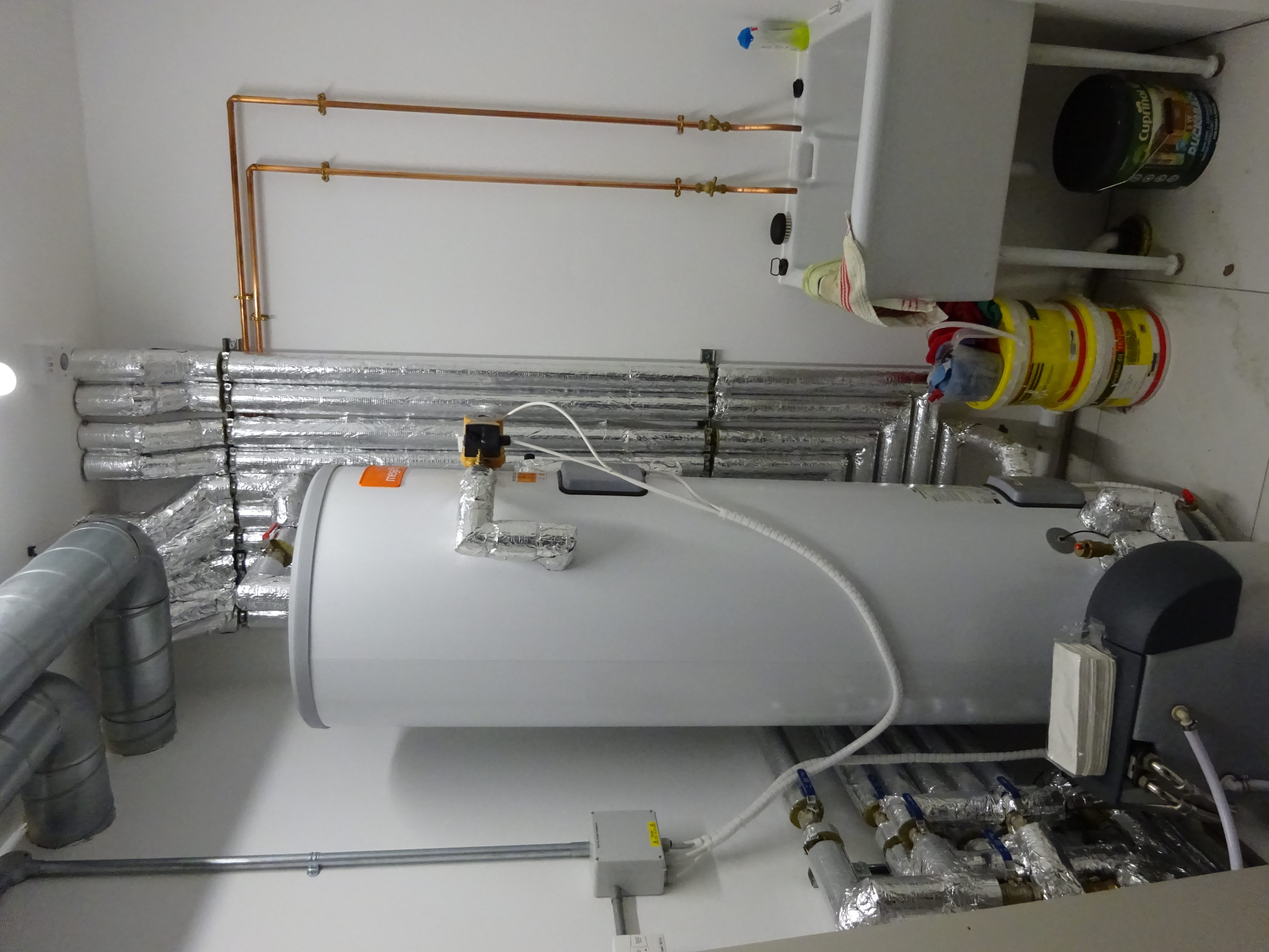

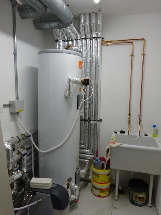

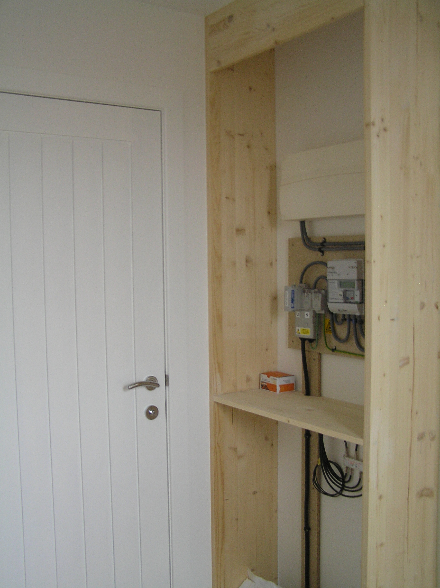

lizzie Posted February 13, 2018 Share Posted February 13, 2018 this is our plant room...not yet finsished but main components in Link to comment Share on other sites More sharing options...
