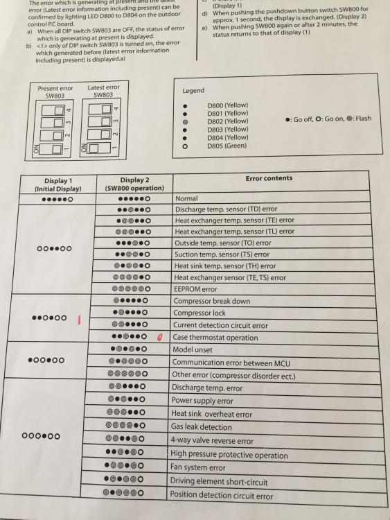

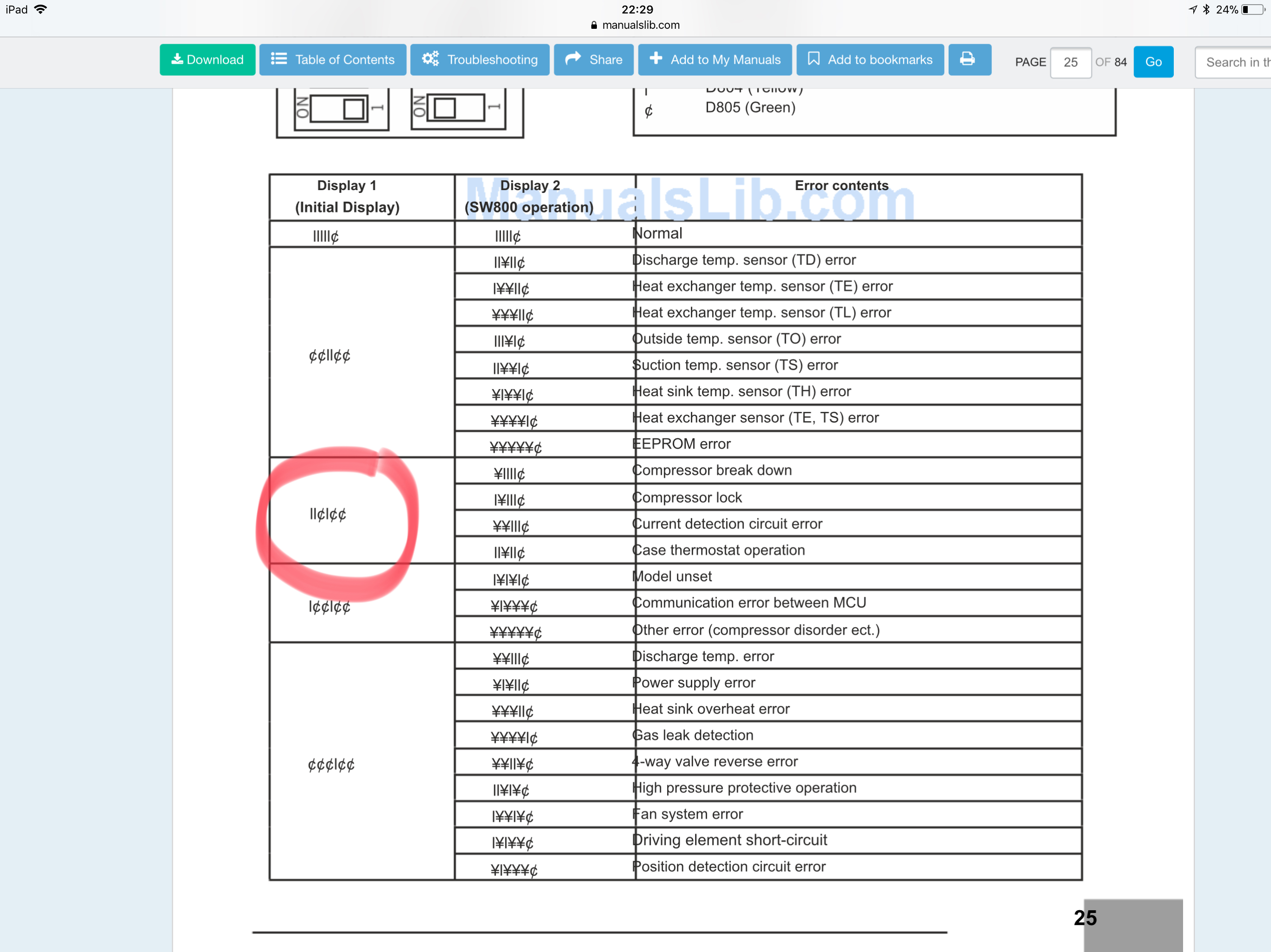

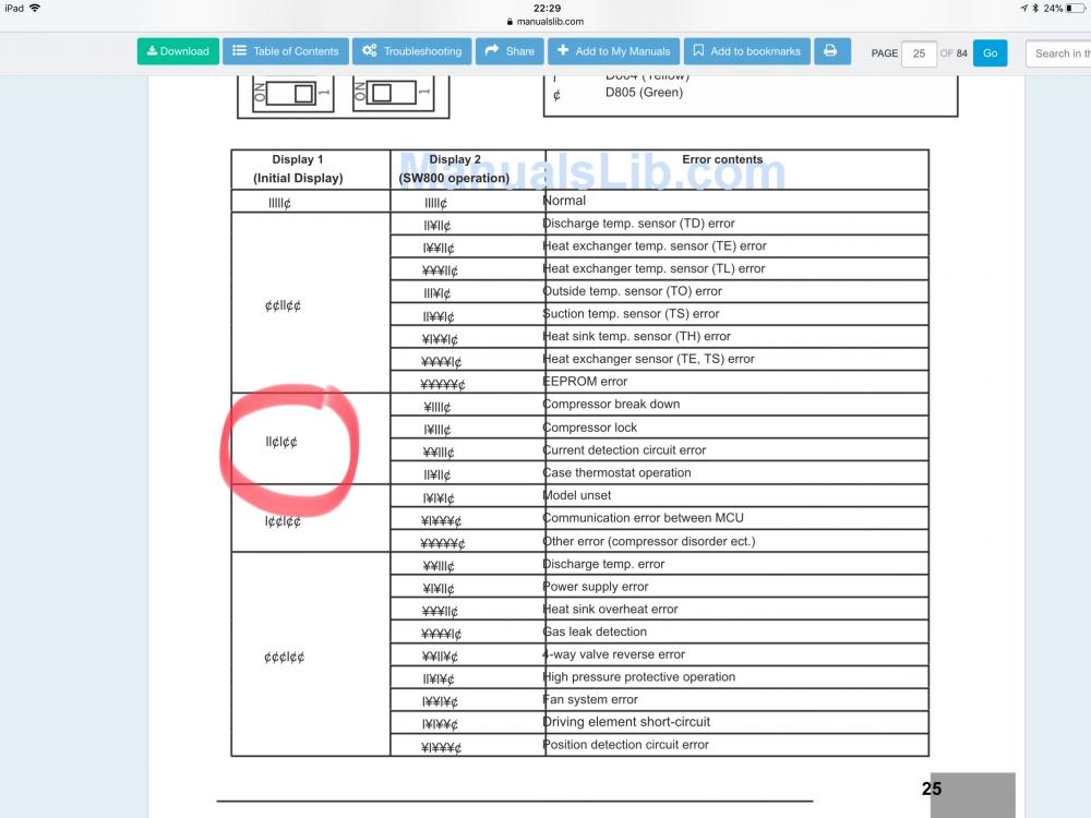

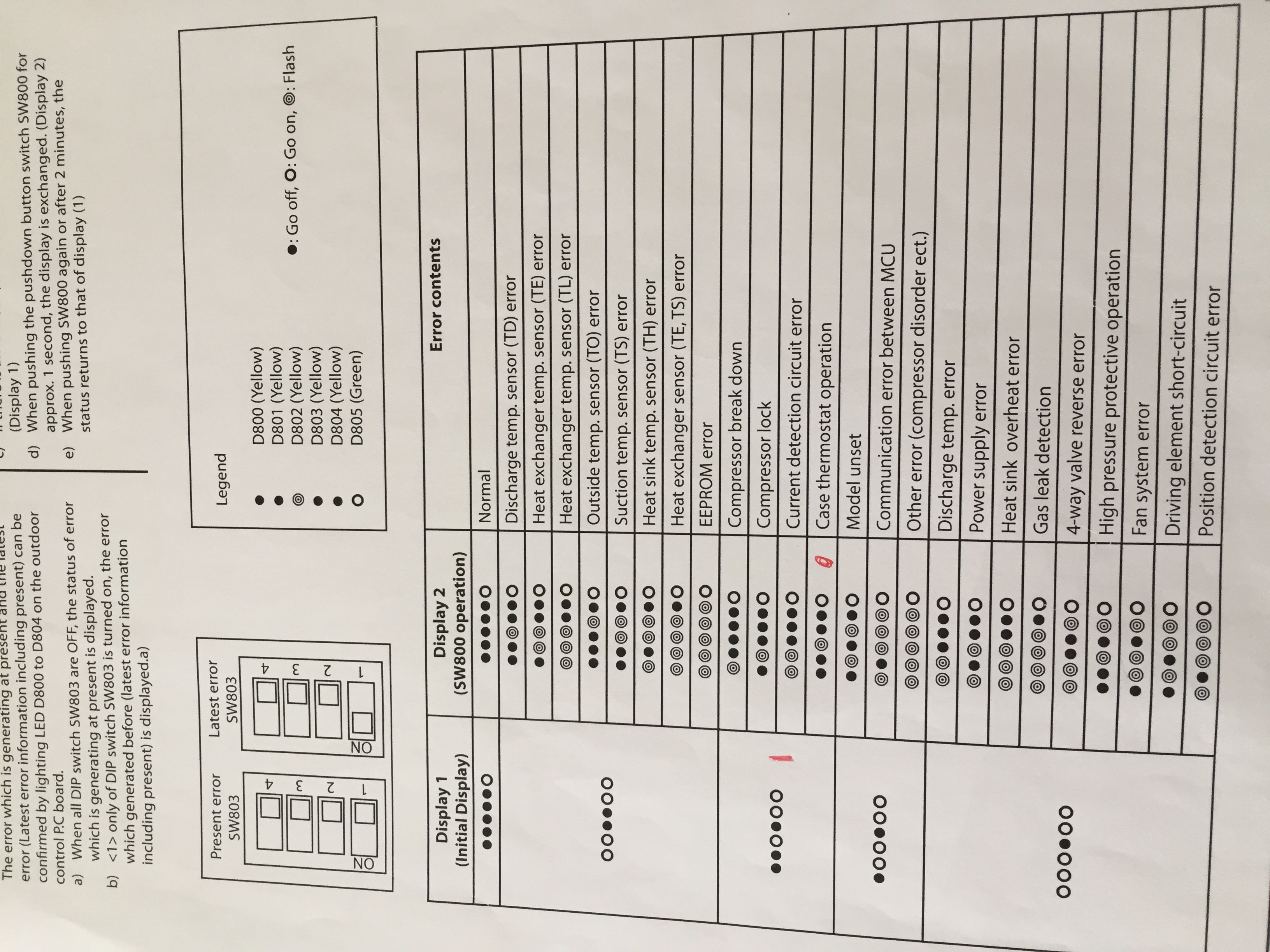

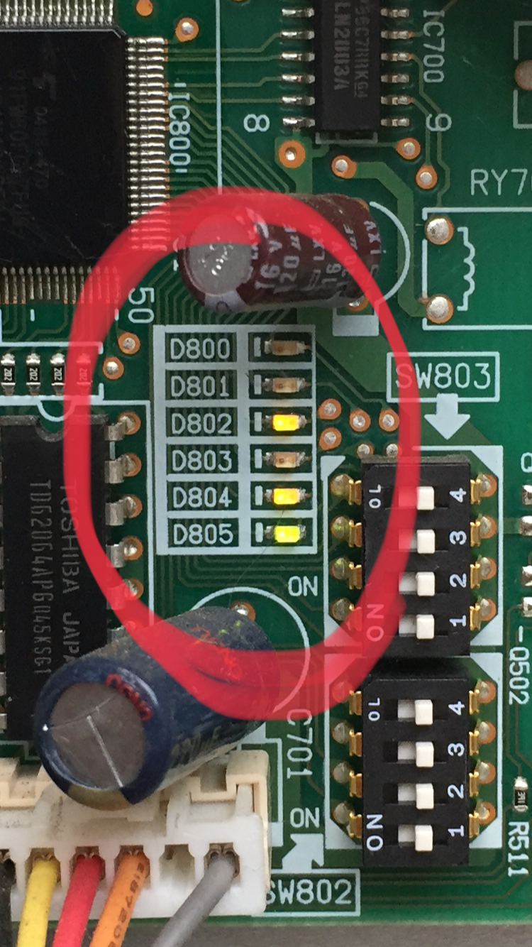

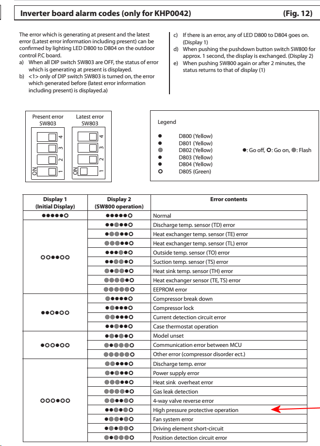

Lynford Posted February 17, 2018 Author Share Posted February 17, 2018 (edited) Jeremy, I was just looking through the manual to try and learn how to manage to interpret the LED faults. It says about having Display 1 & Display 2 >> I read my fault as being something to do with the compressor or in that section anyway ? Then I’d need to press Sw800 to drill down further ? Off Off On Off On On Or am I miles off the mark ? Sorry for all the questions ! Edited February 18, 2018 by Lynford Spelling error Link to comment Share on other sites More sharing options...
Jeremy Harris Posted February 18, 2018 Share Posted February 18, 2018 If it were a compressor problem then the diagnostic LED inside would be flashing a code, as would the red LED on the board. The manuals are confusing, probably because the heat pump is made by Carrier and the manual has been produced by Kingspan, and if Kingspan are like Glowworm, who use the same Carrier heat pumps with their name on, then back when this was installed there wasn't much technical expertise around. Things may be better now, but I found it hard to get firm data. This is a snapshot from the manual I have for the Kingspan Aeromax series: That gives the error as being the one where the flow pressure is too high, and that fits with having radiators with TRVs perfectly, and it matches my experience of having this same error many times originally on our unit, until I fitted the pressure bypass. Link to comment Share on other sites More sharing options...
Lynford Posted February 18, 2018 Author Share Posted February 18, 2018 Gotcha, thanks Jeremy. The thing that confused me was that the error I got was before pressing SW800 (and I didn’t realise I needed to press the button to get another message) Your experience plus the lack of a flashing LED on the board / diagnostic box makes perfect sense. I think I’ll go up there again today to see what happens with the TRVs open, and if it faults out I can press SW800 for possibly more info. Thanks for for bearing with me, Cheers. Link to comment Share on other sites More sharing options...

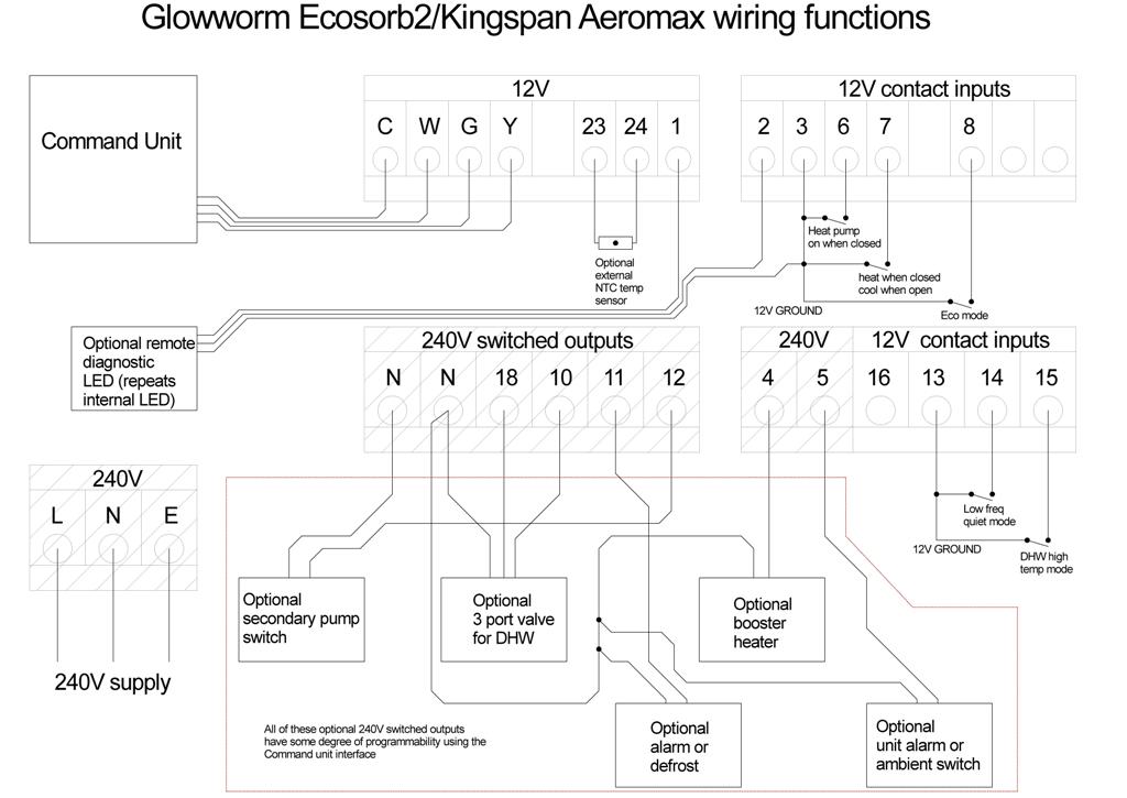

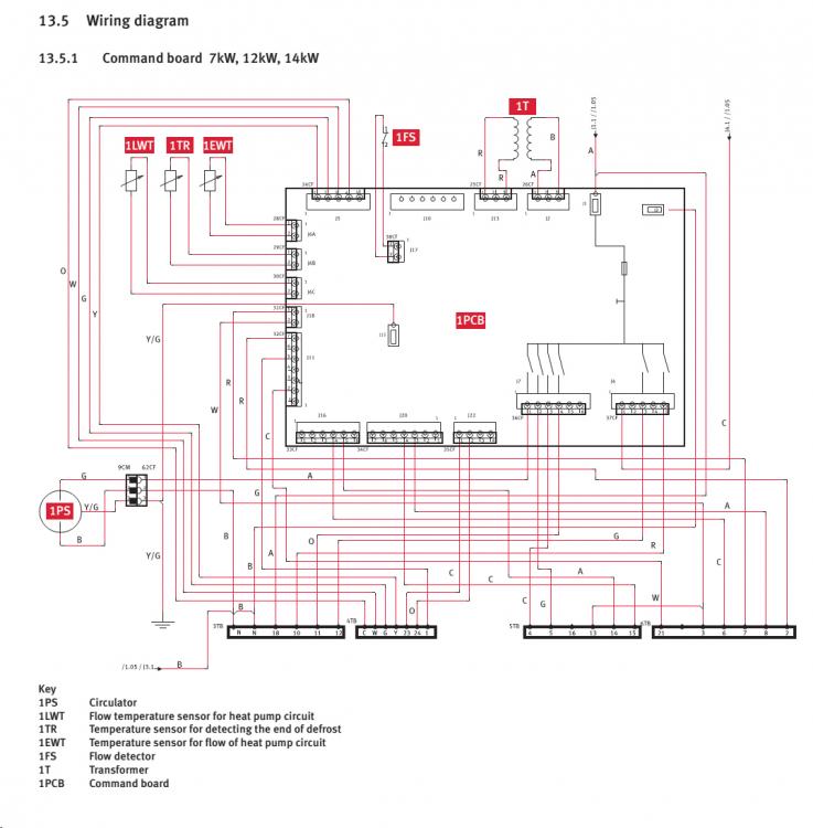

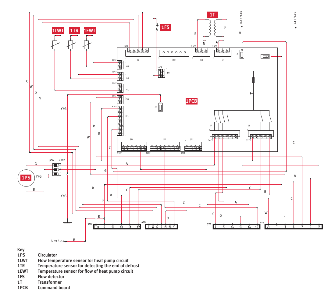

Jeremy Harris Posted February 18, 2018 Share Posted February 18, 2018 I'm not entirely sure all the manual information available is 100% accurate, to be honest. At best some of it is confusing, at worst some of it is just wrong. I ended up drawing my own diagram for the control and relay connections, and this almost certainly is the same as your unit: I never managed to find out what terminal 16 did, but note that it is used in your system. I have a stack of different wiring configurations for this control board, but they are all intended for use with specific control system products, so aren't of much use except that they confirm some of the connections above, like this drawing: 1 Link to comment Share on other sites More sharing options...

Lynford Posted February 18, 2018 Author Share Posted February 18, 2018 Afternoon gents, Been back up there today, and I’m getting more confused ! On the pressure / TRV side of things - I was really disappointed to find that all the TRVs were almost wide open. Opened them right up and started the system, started getting some heat in the rads but never much really and then the ASHP stopped. There was no fault on the diagnostic unit, but the same leds as yesterday on the pcb withing the pump. Then its pointed out to me that a lockshield valves on one of the rads is broken (by a plumber when trying to fix a leak). The machined down part on the top has been sheared off, and I don’t know if it’s fully open or fully closed - If there was a leak I’d suggest fully closed.........could this be the flow restriction and therefore the cause of high pressure ? Fact is that this will need changing before I go further, just to eliminate it. On a different route, when the pump stopped I had the same leds on the pcb board as before. This time I knew to press SW800 to drill down further. This gave me D805 on, but that’s always on, and D802 flashing. According to the manual my FIL has (which as discussed earlier may or may not be accurate), this then points to ‘Case thermostat operation’ Anyone have any idea what this is, maybe it’s a red herring ? I think we need the lockshield valve changed before I move on. As ever, thanks for any help. Cheers. Link to comment Share on other sites More sharing options...
Jeremy Harris Posted February 18, 2018 Share Posted February 18, 2018 The case thermostat operating tallies with the flow being restricted. The case thermostat shuts the heat pump down when the flow temperature reaches the set point that is internally programmed into the unit (and can only be changed using the Command Unit). The sequence of events for a flow restriction would be that the heat pump flow temperature would increase (because the flow is being restricted), the case thermostat would call for the heat pump to shut down (which it does slowly, it takes around 30 seconds for it to ramp down under the inverter control) and then the flow pressure sensor would be triggered by the over-pressure in the flow line from the restriction. It seems to me that this is a pretty logical fault sequence, and that the underlying cause may be a flow restriction. The fact that the radiators only heat up slowly is another indication that there may be a flow restriction, I think. Link to comment Share on other sites More sharing options...

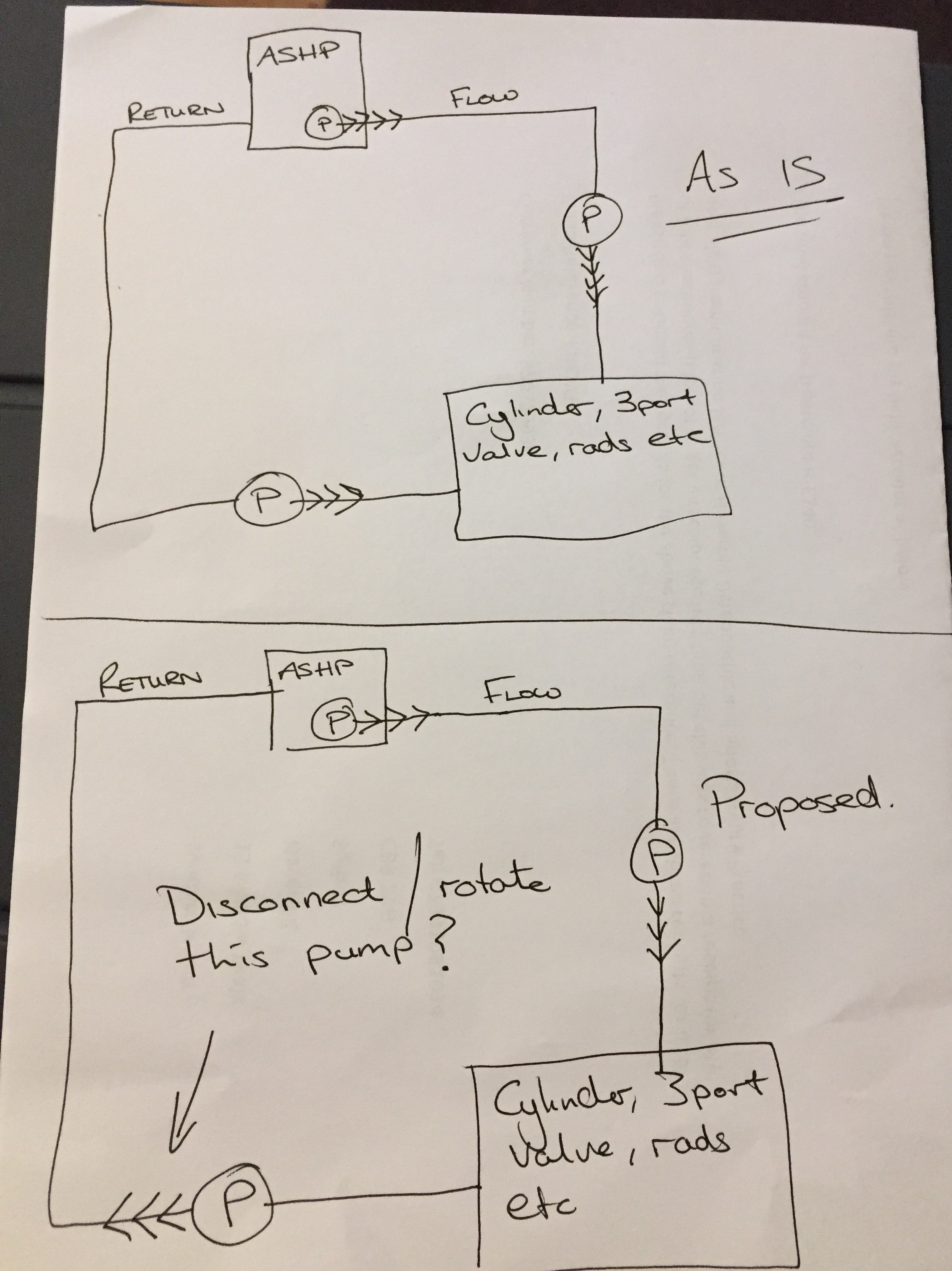

PeterW Posted February 18, 2018 Share Posted February 18, 2018 errr... dawning thought !!! The Kingspan/Carrier unit needs a pretty high water flow - those grundfos pumps either work in constant flow or constant pressure mode. If they aren't set correctly then the flow through the heat pump won't be enough. The other thing I can't fathom... why two pumps..??? Can you see what terminals they are wired in to..? Link to comment Share on other sites More sharing options...
Lynford Posted February 18, 2018 Author Share Posted February 18, 2018 Thanks gents. @JSHarris - Jeremy, do you think the shut down (maybe) lockshield valve could be to blame ? I’m glad that these issues seem to link (the flow maybe being restricted and the ‘case thermostat’ error). @PeterW - I’m home now so can’t see, I’ll certainly have a look next time. I have no idea about these systems, as you can tell, but I couldn’t understand why there are two pumps. One is on the flow, nearest the wall and one is on the return. They had these changed recently, so that person / firm may have thought there was an issue before. There were however two originally. I’ll deffo check to see where they are wired to though. Do you know how they should be set, and are they set actually on the pumps themselves ? ta, Lyndon Link to comment Share on other sites More sharing options...
PeterW Posted February 18, 2018 Share Posted February 18, 2018 If there is a flow and return pump then they need to point opposite directions - they currently point the same direction ie upwards which potentially means they are going against each other. May also be worth checking if those valves are fully open on each pump. Link to comment Share on other sites More sharing options...
Lynford Posted February 18, 2018 Author Share Posted February 18, 2018 So obvious now you’ve pointed it out Peter ! The two drops with the pumps on had an F and an R written on the wall behind them in pencil, so I’m assuming they are Flow & Return. Next time up I’ll go in the loft and trace the pipes from the ASHP into that cupboard. If they are what I think, then yeah the pumps look like they are backing against each other. I just don’t see how we ever got any heat at all. Cheers. Link to comment Share on other sites More sharing options...
Jeremy Harris Posted February 18, 2018 Share Posted February 18, 2018 Good spot! There's a Grundfos adjustable pump inside the heat pump, that comes on whenever the heat pump comes on, so that would have been trying to push the flow around. I'm not convinced that it needs two other pumps, TBH. Link to comment Share on other sites More sharing options...
PeterW Posted February 18, 2018 Share Posted February 18, 2018 57 minutes ago, Lynford said: So obvious now you’ve pointed it out Peter ! The two drops with the pumps on had an F and an R written on the wall behind them in pencil, so I’m assuming they are Flow & Return. Next time up I’ll go in the loft and trace the pipes from the ASHP into that cupboard. If they are what I think, then yeah the pumps look like they are backing against each other. I just don’t see how we ever got any heat at all. Cheers. Ok so the simple check is to disconnect the live to one of them in the wiring box and see what happens .... As @JSHarris said, there is one in the box itself however the wiring diagram they provide shows a second pump. My guess is both are the wrong way round ... HP Pump pushes >>>> Pump A (F) pushes >>>> Pump B (R) pushes <<<< net total is low flow and potentially increased pressure on the output side of the pump where the pressure switch is which then shows as a fault ... Link to comment Share on other sites More sharing options...
Lynford Posted February 18, 2018 Author Share Posted February 18, 2018 Thanks chaps. Disconnect the the one in the return leg I’d imagine ? If that works, whip it out and put it in the other way around ? Link to comment Share on other sites More sharing options...
Lynford Posted February 18, 2018 Author Share Posted February 18, 2018 Like this (please excuse the technical (??!!) drawing.....) Link to comment Share on other sites More sharing options...
PeterW Posted February 18, 2018 Share Posted February 18, 2018 If the return points away from the return port on the hot water cylinder then leave it connected - likewise, check the flow one isn’t pointing the wrong way as you need to leave one connected. Link to comment Share on other sites More sharing options...
Lynford Posted February 21, 2018 Author Share Posted February 21, 2018 Evening gents, I nipped up there on the way home from somewhere this afternoon. Gutted to find that the pumps were pointing in the correct directions - It looks like the head of the one on the return leg had been switched around for aesthetic / wiring purposes, leaving the body in the correct orientation. The live of both pumps was into #13 of the attached picture. Should I be waiting for the Lockshield on the rad to be replaced before going any further, or would this just block the one rad off while allowing the rest of the system to function normally ? Does anyone know if Carrier do domestic callouts, and if they would deal with Kingspan units as they actually made them ? Travelling up there to implement the brilliant info from here isn't the easiest way of doing things ! Cheers, Lyndon Link to comment Share on other sites More sharing options...
