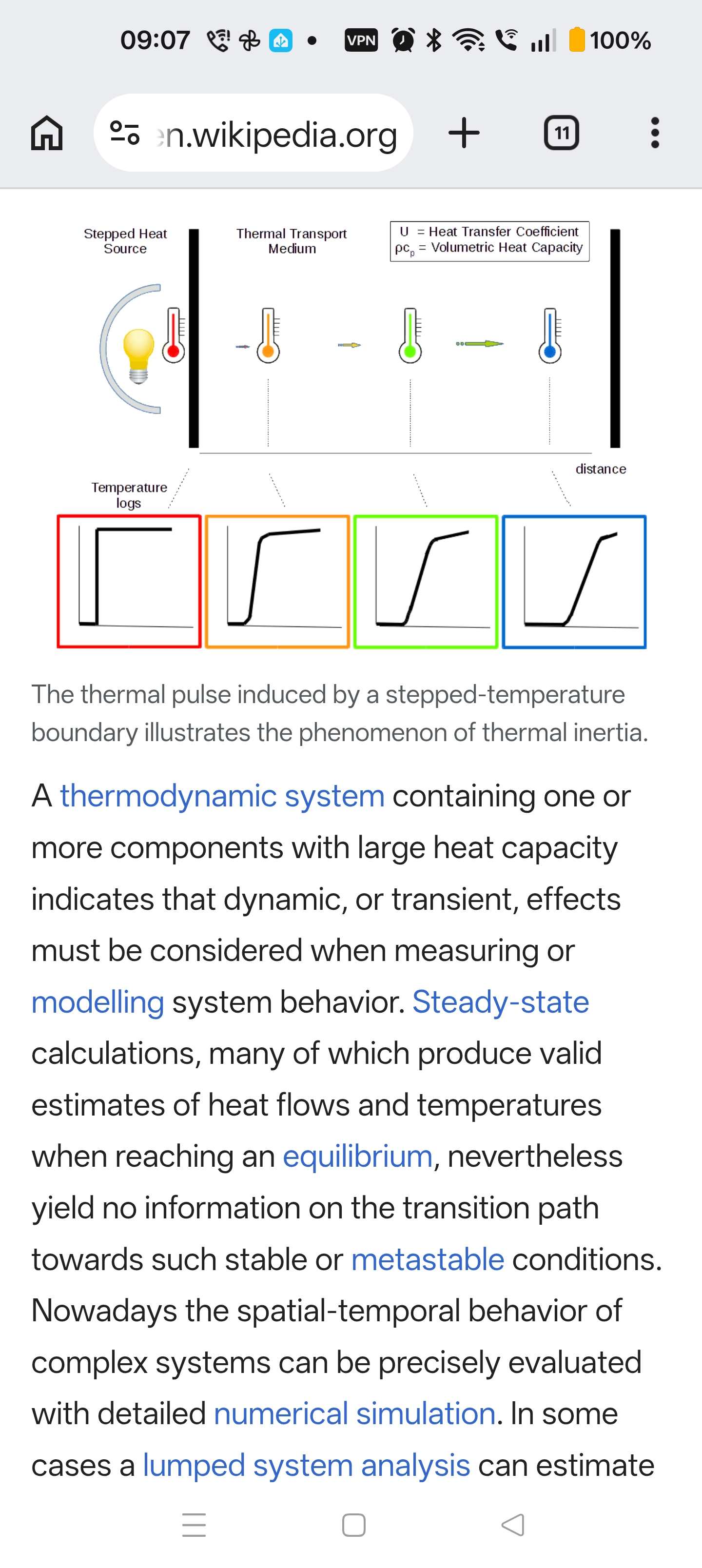

14 hours ago, Alan Ambrose said:
The thermal inertia article is interesting
Screenshot_2026-09-10-09-07-55-39_40deb401b9ffe8e1df2f1cc5ba480b12.thumb.jpg.fb7ccde2a1246f96eef0ae2e331e752b.jpg
So for heating system think of red box similar to to high temp radiators, orange similar to fan coils, green thin screed or low temp radiators, thick screed is like blue.
Your build method also has a big influence on time to heat - a build that is light, wood frame filled with PIR insulation will change temperature quite rapidly similar to the blue box.  An old stone building with directly plastered walls will be slow to heat up no matter what your heat source. Add external insulation it will still be just as slow, add internal insulation it starts to act like a lightweight building.
The ideal heating system and heat source will make the most of the building characteristics. But generally with a heat pump low and slow is the best approach, no matter what the building. Don't let the building fabric cool to much between heat sessions or constantly blip heat heat in.
Lightweight buildings respond well to weather compensation as internal and external temperature changes occur quite quickly.  The heavier the building the more likely there will be a phase difference in temperature changes, inside responding more slowly than outside.
