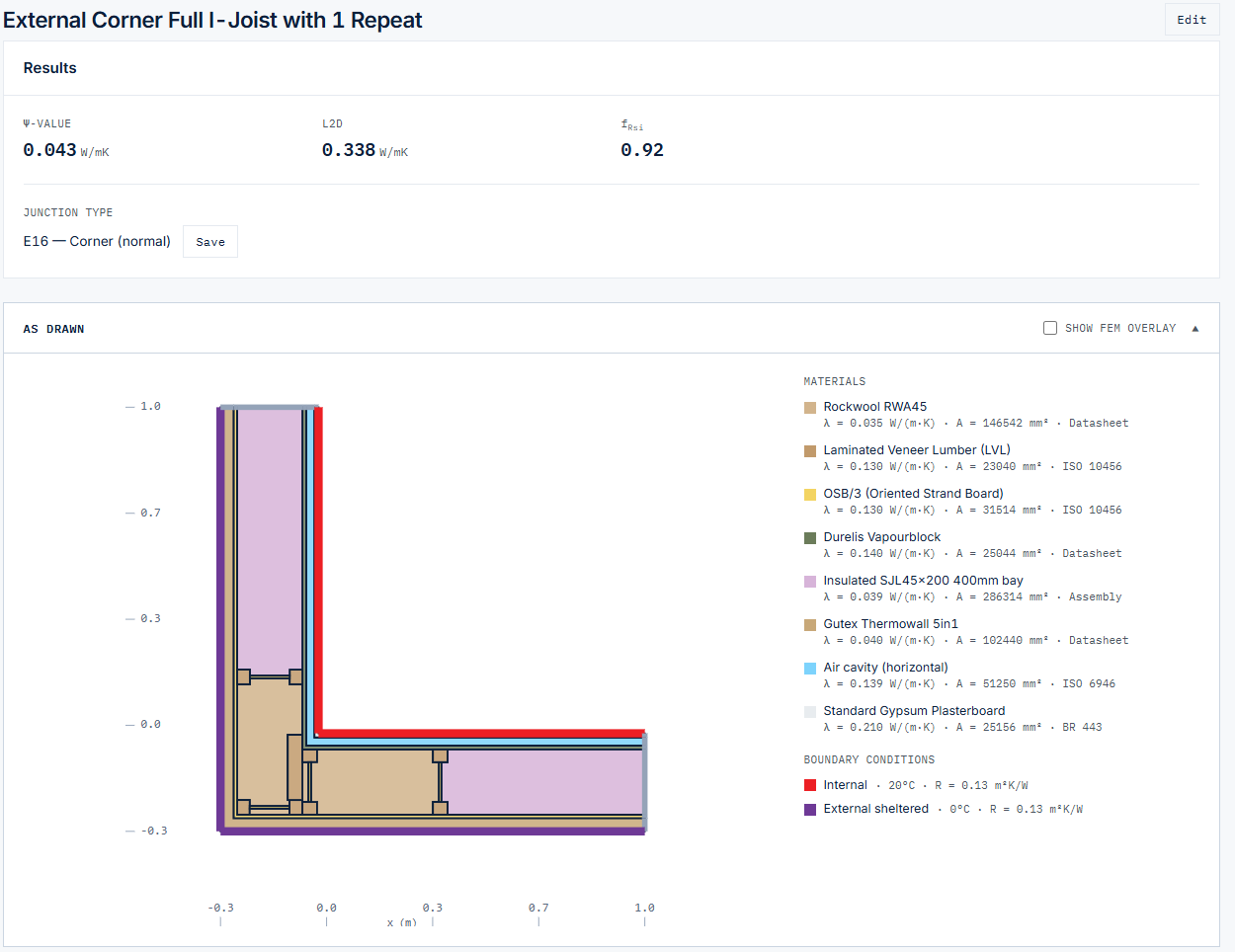

I have given the product a go and downloaded a report. This is exactly the output unedited. The report automatically included the 2d FEM solved I-Joist wall bay together with the E16 corner junction, which is what I asked to be reported. The corner is constructed using the the I-Joist wall bay together with internal and and external insulation and finishing. The wall has an additional rain screen externally the external boundary is to a ventilated cavity not to external air so it's bit more complex than a standard corner but this was included in the boundary conditions available.
My House Thermal Performance Report.pdf

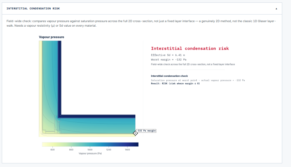

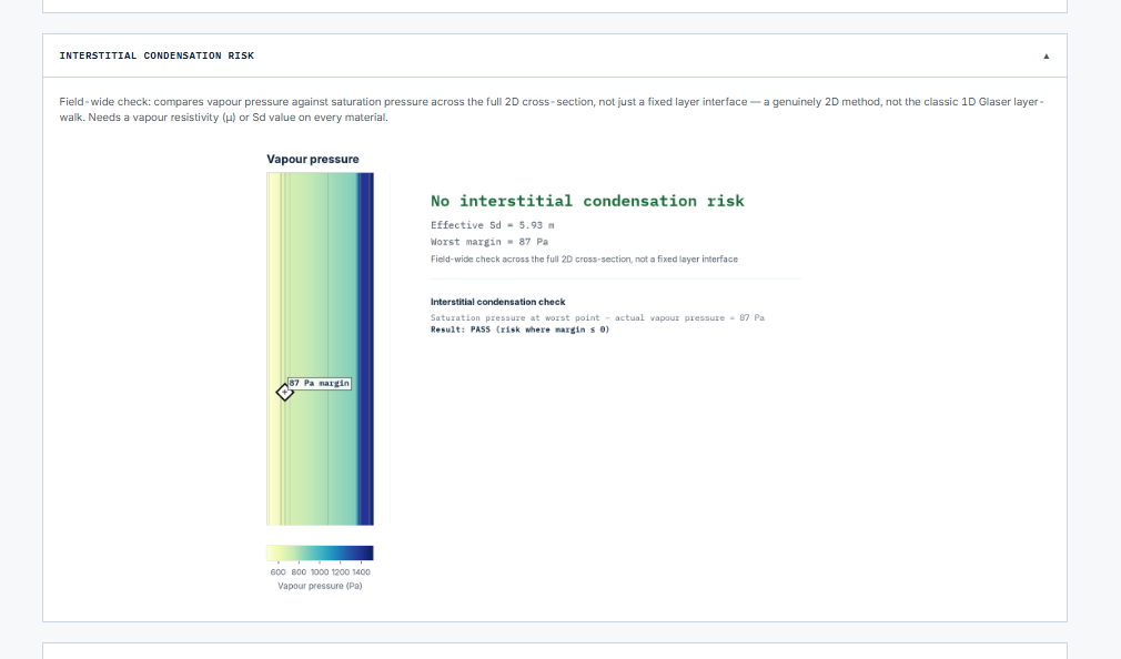

I have now really dug into this to understand why the junction has a problem but the flanking walls do not and the highlighted risk is real! Thankfully I have not started any work so I can do something about this now. The cause is the Durelis VapourBlock which while being an ACVL is  great for air tightness but not so great for vapour. At least I now have some real data that I can use to look at my design and see what I need to do to prevent the risk highlighted
I have attached the condensation risk analysis for both the wall and the junction so you can see for yourselves

Just a couple of comments on the attachment after a quick look through. Standard external temp is normally 0 Deg C rather than -5 though this probably makes no difference. Also there are timber elements missing from the junction detail.
I have checked BR497 (I have the latest copy). This document states "In all of the examples modelled, the inside room temperature is taken to be 20°C and the external temperature is taken to be 0°C. For simplicity, these are the usual temperatures to use when modelling, but other temperatures can of course be used. Note: the ψ-value and temperature factor, g, are not affected by a different choice for the internal and external temperatures..." I don't know why -5 is I will send a note. The I-Joist flanking elements in my drawing are compound assembly and do not show the repeating elements,. The I-Joist bay itself is also in the report  at 0.0391W/(mK), so the report itself looks complete to me. With respect to repeating elements BR497 states that the approach I have taken is correct, which is why I did it that way. Indeed, BR497's own example follows this approach and it states that drawing every stud would be over modelling;  "Repeating bridging perpendicular to the junction (§3.1.3.2) can be ignored entirely if either:
  • the bridging element's thermal conductivity is ≤ 0.5 W/(m·K), or
  • it doesn't bridge the primary insulation layer."
I'm not sure if you are providing a critique of my report or the software or if you are saying when you where an assessor you would have resorted to default values if given this report. If it is the last of these I don't think there is anything technically wrong with the report but I would welcome anything that would give you real technical grounds under which you would be able to justify default values and non acceptance of the values presented. Since I have to do a SAP10.3 assessment this feedback would be very helpful. If you just don't feel comfortable because you don't know the product that's fine. New products appear all of the time and the cost of doing psi-values should not be a prohibitive, as it is now, so I personally welcome this approach.
Look very carefully at your detail - there are a couple of timber elements missing that are needed to make this detail 'buildable' and they will impact the psi-value. Also regarding the general detailing of an I-joist corner - is your detail from an approved source/manufacturer? I'm thinking more from a structural connection perspective here.
I do not know how psiclops works so cannot comment if the above are down to user input or how psicops handles the data.
The construction drawing have been architected and had a first pass with the structural engineer - it is an engineered balloon timber frame that will be site constructed. Psiclops is not tool to determine buildability but to look at the construction from a thermal physics perspective.
I'm not sure what you are alluding to with respect to missing elements from the drawing as these are junction details at the junction. This is a California corner, which requires 3 timber sections and has been looked at by the SE. The wall itself clearly had more I-Joists studs in it (every 400mm) but these are not required as part of the thermal modelling and are represented thermally by the compound I-Joist wall. This is a valid way to do the wall from a thermal perspective. Psiclops takes a DXF and converts this into 'drawing' much like THERM and Flixio do. This is then given materials and boundary conditions. It's not Psiclops that is missing the detail, if is is missing, it will be my DXF.
If you can tell me what your concerns are, either with the wall or with the model that would really help but your comments are somewhat vague. I'm also still not sure if your critique is about my drawing or Psiclops. I still feel, with your old cap on, you are trying to say you would be applying junction defaults but with you old cap on you would have to give a detailed rational for that and it still feels it's just something that unfamiliar to you.
I have attached another image which is probably closer to what you are alluding to. The psi-value of this is 0.001 w/mK different
