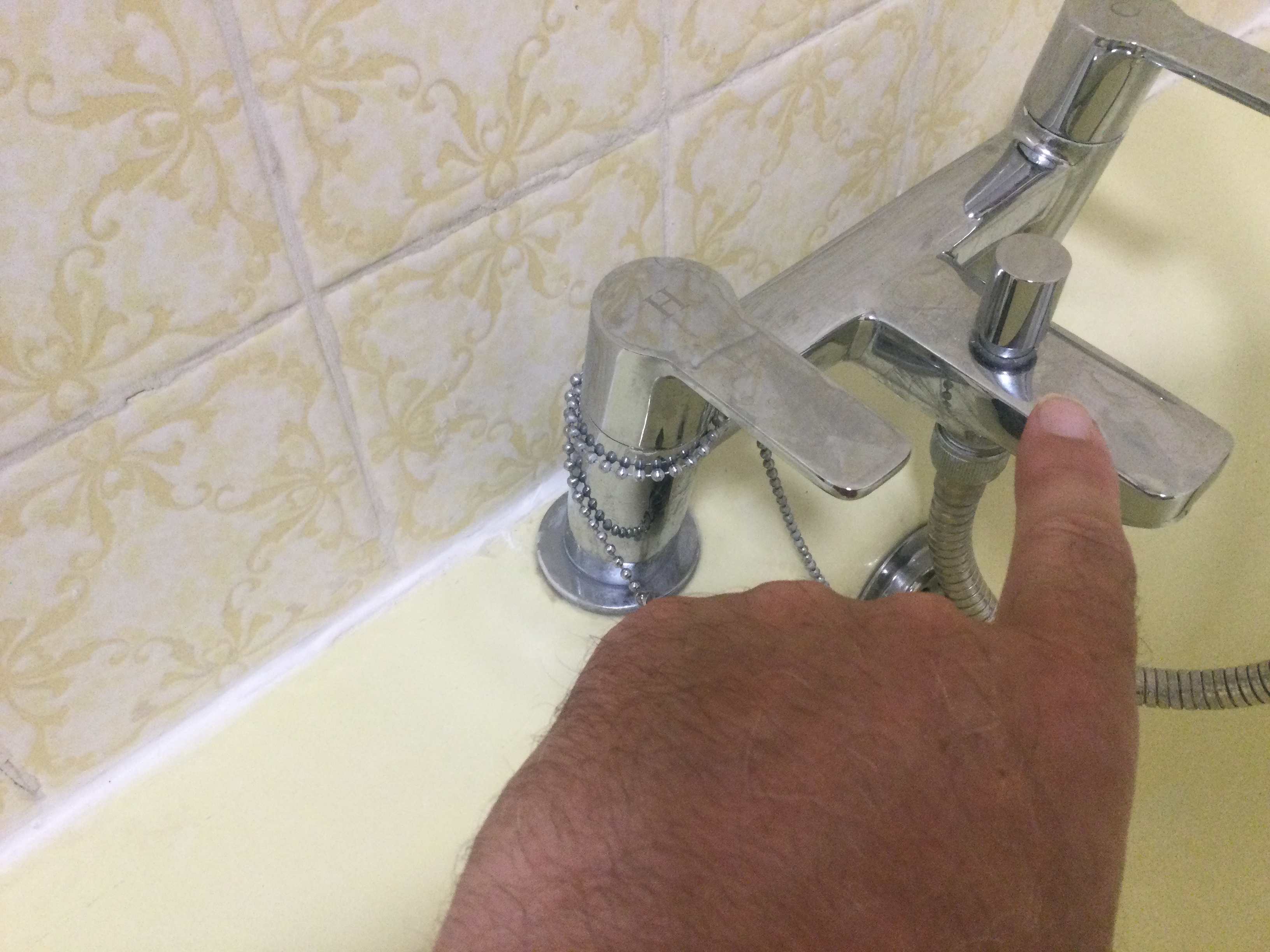

Hi chaps,
small issue preventing water going UPWARDS via hose, to a shower head, from a bath mixer tap pair.
The valve thingy between the taps, is stuck. How to release it?

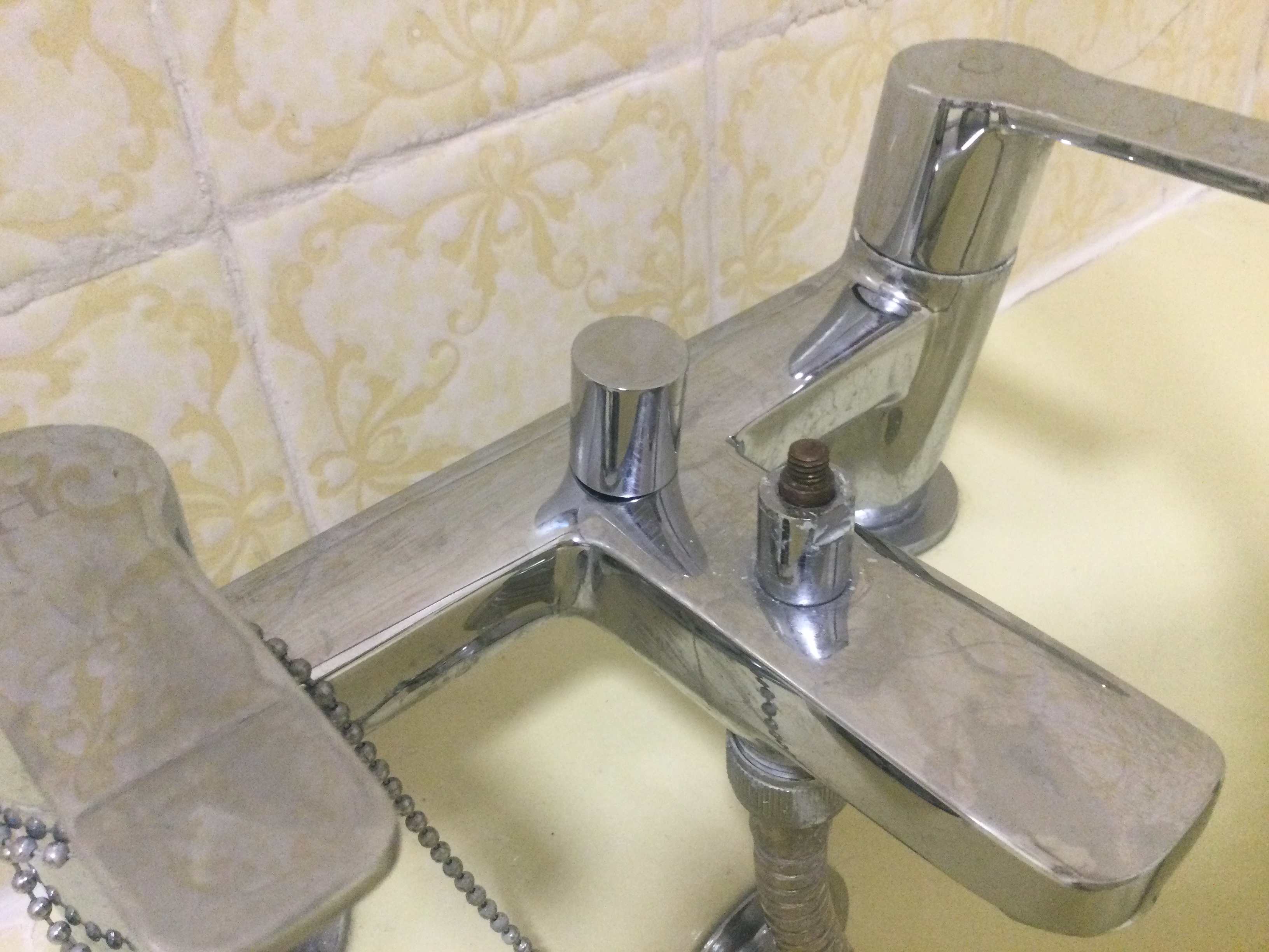

No, the brass centre section seems stuck firm. I don't quite know which bit is meant to move (never unscrewed the top of one of these ever before- & no-one really uses these taps-up-to-showerhead things).
I presume, in photo 1 where the chrome cap is screwed on/ as is meant to be, this section should simply pull UP say 1/2" or so. Meaning the brass bit with the thread on inside, should also move up 1/2".
I can see your flat area on the outer tap section, but i wouldn't need to twist or use this for leverage.. would I? It's only the centre brass area inside it that I need to grasp & shift.

Of course I see your flat spot. But this seems to be the lower section, & the part that doesn't move, of the uppy-downy brass section.. which seems to be the section that is meant to move, & is stuck, within it.
I have unscrewed the 'cap' to reveal the brass bit: with the cap on (& so far as I recall with these) the cap/ knob is supposed to be pulled UP, to divert water to the hose (& up to the shower head). Is this right. I can only guess this to be logical, bc with the cap screwed back on, it's then in the 'down' position, & is flush with the surrounding large tap "chassis" section. And the water is currently coming out of the two taps.

 Can you see I have done step 1, & unscrewed the chrome cap. This reveals a brass section, onto which, the cal was screwed onto: the brass section has a thread on it.
The brass section, surely then, is the section that is meant to move up-down, within the stationary chrome surround base section (this section Nick points to, but I have no idea what this flat spot spanner area is for).

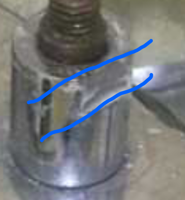

On 19/07/2026 at 13:45, Nickfromwales said:
There are flat spots here for the spanner to grip onto.
That little chrome tower will unscrew and come out of the bath filler spout, and the brass bits are captive inside it.

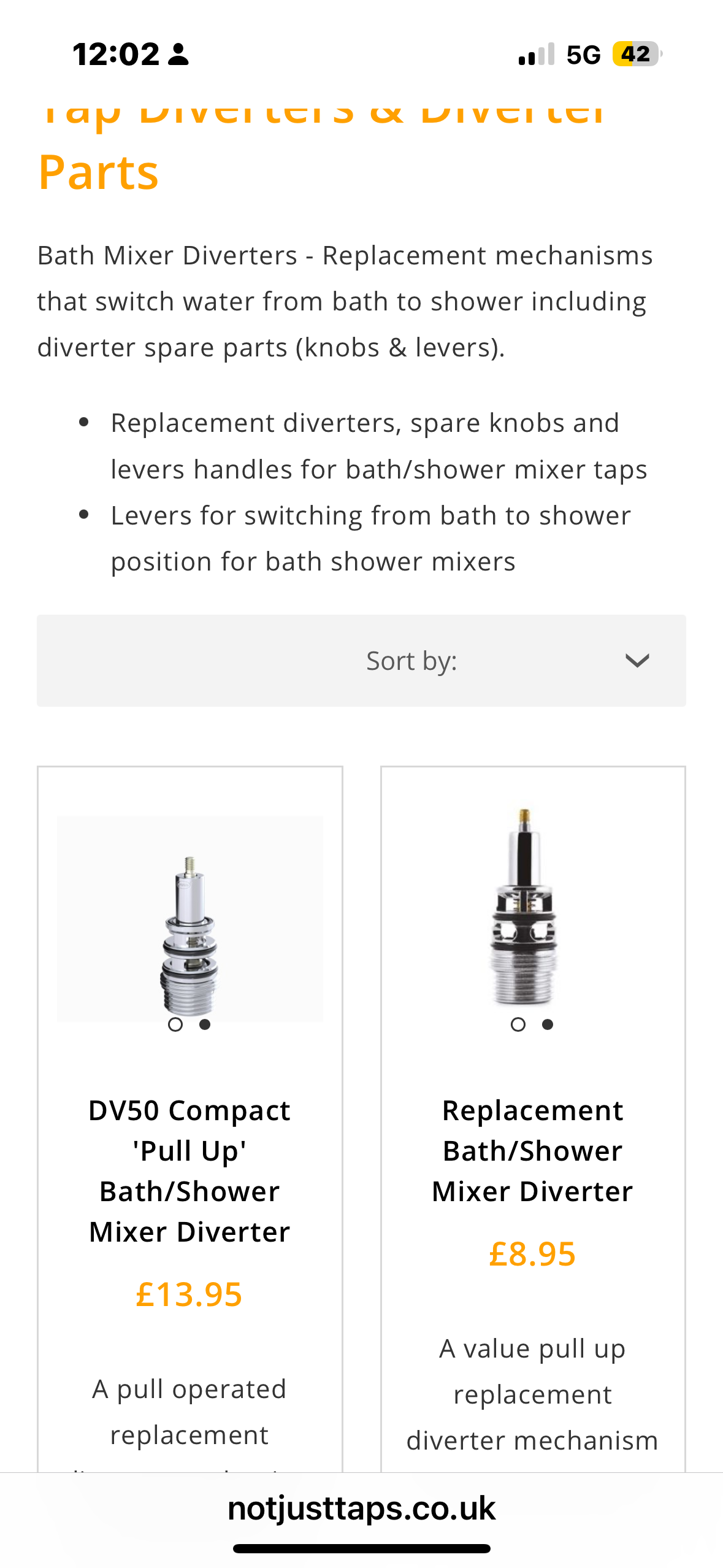

 It'll look a bit like this:
https://www.notjusttaps.co.uk/bath-mixer-diverters.html?srsltid=AfmBOooConE86lzVQygWRuBY6irx9Jr3MXuk9E_xTTKGo_XLBUAOv-nM

Aha thanks Nick. I'm on board!
So assuming universal thread diameter for this whole section, I should maybe just buy a new one.
