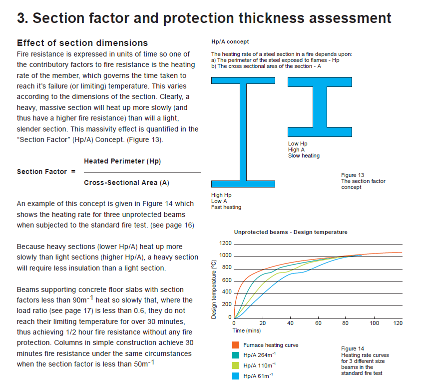

It depends! But here is a rough outline of how we go about designing steel fire protection.
On 11/07/2026 at 11:31, SteamyTea said:
Can you explain a bit more
The following is in the context of the self builder, not multi storey, multiple occupancy structures.
On 11/07/2026 at 15:51, SteamyTea said:
Until the yield point is reached
Ok, the process / theory is.. roughly this.

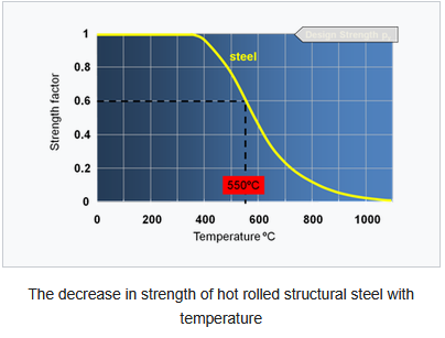

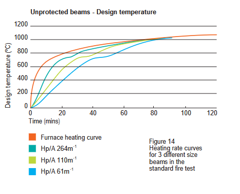

The starting point is to understand how steel behaves when it gets hot. Someone ask me / others a while back.. why does my oven not start to melt / distort when I cook a pizza hot?
The above is what we call a fire curve (SCI, Steel Construction Institute data ). There are different fire curves. They vary depending on fire loading (how much and what types of stuff can contribute to a fire, how "intense and rapid" the heat delivery) but the above is one we would refer to in a typical domestic self build.
You can see that up to about 350 Celsius the steel maintains much of its strength, which is why your oven does not "melt" and fall to bits. After that the steel strength starts to plummet.
When we fire protect steels as @saveasteading says
On 11/07/2026 at 14:16, saveasteading said:
The steel is not being protected in the long term. Continued heat will make it fail. But it is being designed to remain structural for a period of time.
This is correct. All we are doing it to stop the steel from getting hot enough, then soften too much, and thus not carry the loads on it for the time required by the building regulations for example.
Now we can either select a geometry of steel member and make it very heavy such that there is so much mass of steel that it does not get heated quickly enough to soften to the point of failure.
In lay terms. If we had a solid round bar of steel say 150mm in diameter it has a large cross section area compared with the exposed surface. This is what we call the heated perimeter / cross section area ratio (Hp/A),  the Euro codes have slightly different way of presenting but they mean the same. They are presented using the ratio Area / Volume, A/V.
But if we have the same cross section area of steel and weight in an I shape (a universal beam) it has a much larger surface area and thus will heat up much more quickly and thus lose strength more quickly.
Now we ain't going to be using solid 150mm diameter steels. What we could look to do is is insulate the steel. This could be by way of fire proof plasterboard or intumescent paint. But also we could build the steel into a masonry wall and maybe have only one side exposed to the fire on the inside of say a garage. Or we could have the steel built into a floor that in itself insulates some of the exposed faces of the steel.

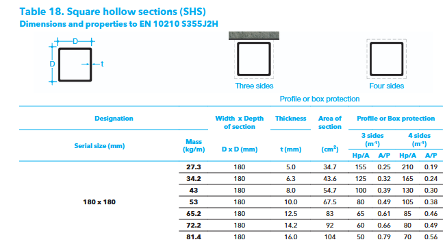

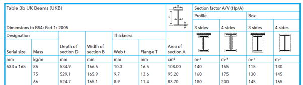

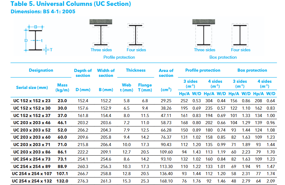

Below is a screen shot of a table that shows how we need to consider the exposed sides. They key here is that the lower the section factor the slower the steel will heat up.  The section factor changes depending on how many sides of the steel are exposed.
But to go back to what @Great_scot_selfbuild asked., which was how heavy does a steel need to be so it does not need fire protection? The info below is taken from Corus literature 2003 as an easy generic example.
 The bottom line  (Hp 61m^-1) is of interest to us here in a domestic self build. Using a design temperature of 550 deg you can see that the bottom blue line hangs in there, all other things being equal for 30 min.
So let go back now and find a steel section with a section factor of lower than 61 m^-1 to try and get a handle on how big a column needs to be for example.
A 203 x 203 x 86kg/m is a candidate if it has three sides protection (section factor 60), but that is a heavy steel. You also need to handle this safely on site.  Ok let's see how a box section compares. image.png.53a4d49e8381a63bf1c437145965856e.png
 Ok we can get down to 60 for three sides exposed protection.. not much difference. But if we reduce the sides exposed the numbers get a lot better. I've not shown them here.
That main remaining key bit is what we call the load ratio mentioned above as 0.6 ratio.
When we design a beam / columns or pretty much any structural member in your house we design for the normal expected loads. The self weight, permanent loads and the imposed ( live loads, people, book shelves etc) but in a fire we recognise that the floors, roof etc are probably not going to be fully loaded with people for example during a fire, the permanent / self weight  load is still there. So we can make a reduction in the load if a fire occurs. Its based on probability and the loads that could be reasonably expected in the case of a fire. We call this an accidental load case and the safety factors get reduced for example. If we designed everything for the worst case buildings would be too expensive to build! The load ratio is the load (stress generated) during a fire compared with the ultimate capacity of the member.
Often we design beams to be restrained by say a timber floor.. but if this has burnt away we can't count that.
